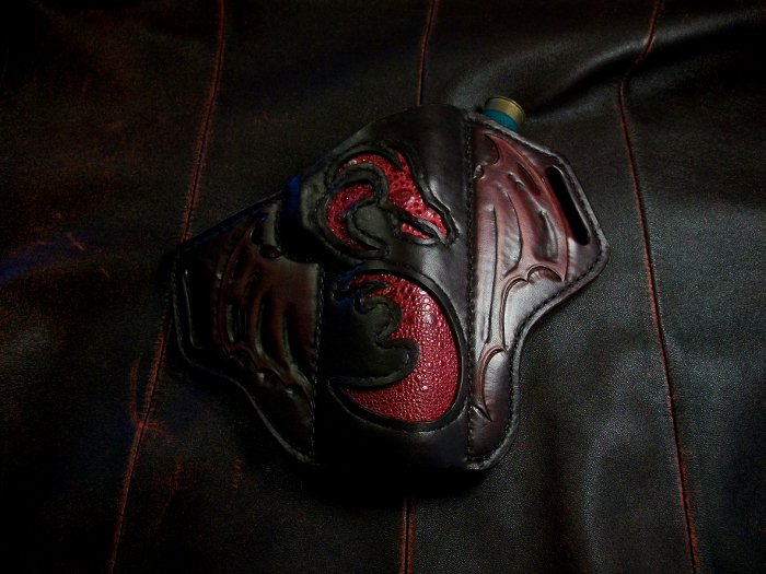

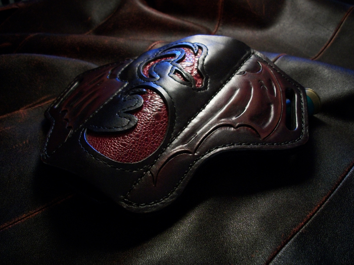

Here is the back. I cant show it on a belt because it was done for someone else out of state but I hope to get pix of the gun in the holster. Maybe I can get him to take a pic on the belt for me.Here is the back. -

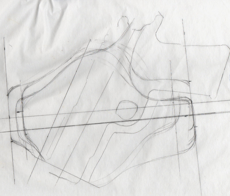

I finally went ahead with a reverse avenger style something or other. Sure I am not the first person in the world to dream it up. Whew this was tough. I hadnt seen a protractor since high school. Im trying to start making my holsters more compact so they can be slide back and forth on the belt more. I have a pancake I made for myself years ago and I noticed when I get in my wifes car I would like to slide it forward and then slide it back when I get out but there isnt much room because of the spacing of the belt loops. I think I will be doing more Avenger style holsters. Thank you everyone for your help !!! -
Alrighty .. I went and bought those super cheap clip on lights at home depot. A little better. I will have to build my light box. Had thousands of dollars worth of camera gear but the daughter wanted to take photography in college and .... well all of its gone. Anyone who has kids knows what I am talking about. She is my baby and I would give her anything I could. So here is the latest try.
Thanks everyone for your kind comments. Time ... whew ... I would say it was probably 24-32 hours. This is the first time I ever tried anything like this so there was a lot of fumbling around. I dont have a machine so the fine thread around the central figure was all done by hand with my wifes wee bitty needles ... which really hurt by the way, and I bought super duty upholstry thread but it is still very thin. I have some kinks thought through though. I now have ALOT of questions for the group based on things I would like to do better.
Always a little intimidated coming to this board but here goes. Its not as dark as in the pix but I need to upgrade my camera.

Hey Guys I come to the well once again. I am trying to make a cross draw holster for a 3" 1911. Cool so far but ... Im trying to get a 30 degree cant and I am at wits end. I have been working on just getting a pattern all day. I was trying a pancake but I am not married to it and would be just as happy with an avenger style holster. I dont even know what to ask except .. anyone have any ideas on how to accomplish this. Not terribly difficult on a longer gun but I am stumped with this 3 in 1911. I put up a picture of where I landed up but you can see the belt slots are not even and I didnt want to go all the way up into the grip. Thanks all Alex ]
