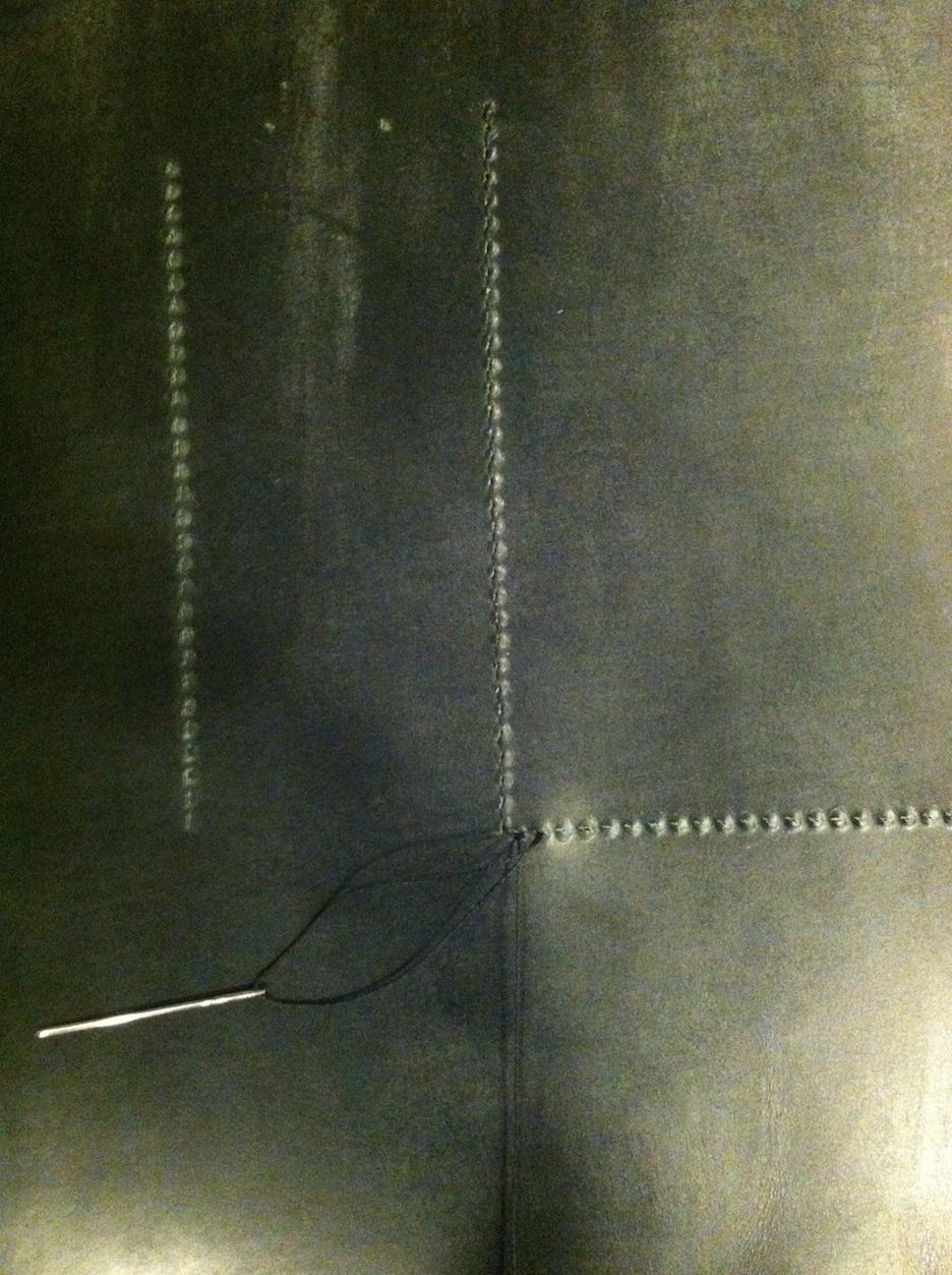

Problem Saddle Stitching English Bridle Leather....help!
Redhairing replied to Redhairing's topic in Sewing Leather
Thanks for that advice, TinkerTailor. Yes, I tried going back through with the chisel and stitching and the blister shape is lessened but still not pretty. Will sharpen my tools tonight and might sew on a slightly bigger exterior pocket to cover and hide the blemished stitching rows. -
Thank you all so much! It's clear to me now. Tried to smooth out the blisters with a bone folder with little success. Dull tools plus softish poundo board equals pockmarks. I will learn to sharpen my chisels and meanwhile ordered the Seiwa chisels that Nigel reviewed and start again!!! -

Hi- I am using 4-5 oz. bridle leather for a satchel and using a diamond stitching chisel to go through a thin calf skin interior pocket and the bridle leather and am getting a horrible round blister shape around my holes on the surface. they don't smooth out with hammering.....any ideas? Is the surface just too firm a temper to prick through the backside? I would be very difficult to catch the pocket edge by pricking through the top....is this just another lesson learned about a particular leather? Only make holes from the top or could my tools be too dull? I'm using a mallet on a poundo board....thanks!!!! Susan -
