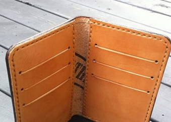

  13. Hello Pzarkov Great wallet do you mind me asking how you did the card slots i have been researching how to do it with out any luck.Can you direct me to a place .Great wallet once again .
  14. That doesn't seem promising.. Is there another way to achieve this design ?
  15. I'm trying to figure out how to do a card slot with out stitching in the front or even stitching in the front. I ones saw that they do a long nylon fabric with folds to do the pockets in the inside but I cant figure it out.. Its all to make a thinner wallet..ThanX in advance.
