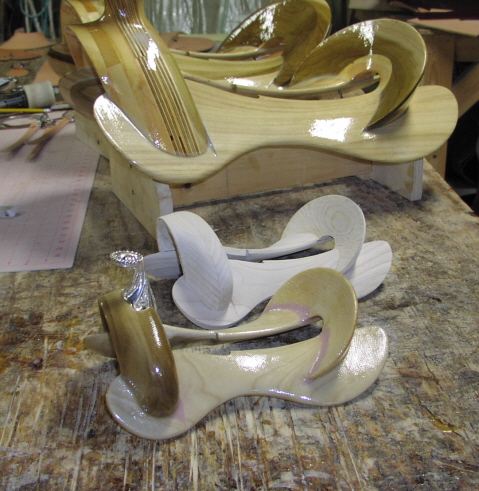

  3. As Casey mentioned, I make trees in any scale and style. Full size trees can be scaled down for horses or ponies just right for kids. The little trees in the picture are Casey's. The finished one is fiberglass/epoxy encased. The full sized trees in the background have been epoxy coated and are awaiting rawhide. Jon

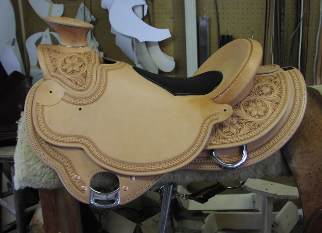

  11. Here's one I finished for a local gal a few weeks ago. It sports one of my fiberglass encased trees( 4 lbs.) and 13-15 oz. Herman Oak skirting. With everything hang'in, it weighed in at 30 lbs. Jon

  13. Just an update on the lightweight I started last Sunday afternoon. As of Fri.evening, everything was done with the exception of the breast collar. Minus the breast collar, stirrups, and front cinch, it weighed in at 27 lbs. This was still accomplished using 13-15 oz. Herman Oak skirting and my full size round skirt pattern. The skirting was a bit on the light side however. JW, Just like you, I sure like building on these trees...super smooth with all edges well defined. Some makers take exception to glassed trees as you well know...I'll do rawhide or glass, makes no difference to me. Andy, I would like to see one of your glassed trees sometime. What's the lightest tree you've made? Steve, I love to see your work. From what I've gathered, as well as being a fine craftsman you are a very efficient builder as well. Keith, Your work is always very inspiring! Your artistry is to be studied, I always learn from your work. I'll bet that was one proud young feller in that picture! Frank, Thanks much for your input as well! I'll try and get finished pics up before me and the family head out on our road trip out west on Tues! Jon
  14. I received an order sometime back from a lady who lives locally that wanted a classic Wade saddle built as lightweight as possible. When I was confronted with the challenge I immediately suggested a fiberglass encased tree. She wasn't to keen on the idea at first, but soon I gained her trust and she agreed, as the weight consideration was very important to her. Granted, it just doesn't seem right to put a glass encased tree in a Wade, but when you are looking for major weight savings without compromising strength, it just makes sense, and man, are they nice to build on! When finished, the tree weighed about 4 lbs. I'm hoping the completed saddle will be under 30 lbs. Just started the saddle today...I'll post the results in about a week. Just curious, what's the lightest saddle any of you out there in Leatherworker land have made? Jon
