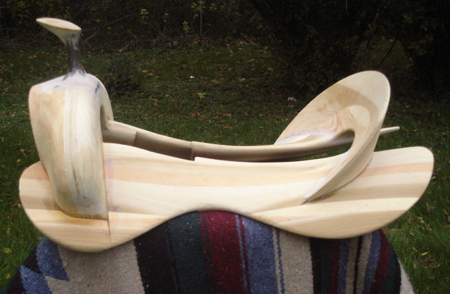

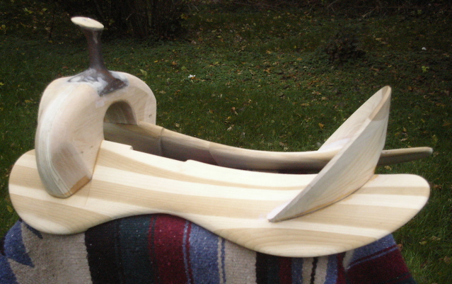

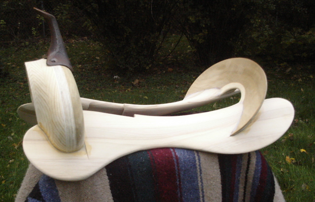

These are the trees in the wood as listed #2 #3 #4 #5 Matt, here's a BW cutter in the glass. Sorry, I still haven't bought a good camera.
Matt, I'll post some pix in the mornig. I don't have any ranch cutters built right now, but I'll post a standard glassed BW. I learned the basics from Keith Gertch followed with vast amounts of R&D time. Jon
Elton, The hand hole measures 4" on 4 of them (the rpoer is 4 1/4) and they would equate to a 93 degree angle at front. Jon
I have a few stock trees in my shop I need to move. Shop space is getting tight here. These are trees I've built to show other makers and all have the same rock, twist, and bar angles with the exception of the roper tree which has an additional 1/4” of bar spread front and back. These work very well on mature, conditioned, foundation quarter types. The two Wades listed are rawhide covered with fiberglass reinforcement beneath. The Wade pictured is one I delivered a couple of weeks ago and is identical to #1 offered for sale. The other 3 listed below are in the wood waiting to be covered with either your choice of epoxy/fiberglass or rawhide with fiberglass reinforcement. The rawhide trees sell for $550 and the epoxy/fiberglass trees are $465. With this selection of trees I will pay shipping on all prepaid orders within the continental states. I accept Visa, Mastercard, check, or money order. If interested, you can e-mail me or call me at the shop at 515-285-0799. If I don't answer, leave a message and I'll call you right back. These are not seconds or rejects, they are my premium handmade trees. I'll take pix of all in the wood and get 'em up pretty soon. Jon Wade, 5” stock, 3”x 4” guadalahara horn, 16 1/4” seat, 4 1/2”x 12” cantle, 7 1/2” high gullet Wade, 4 1/2” stock, 3”x 3 1/2” post horn, 15 3/4” seat, 4 1/2”x 12” cantle, 7 1/2” high gullet BW cutter, horn of your choice, 16 1/2” seat, 3 1/4”x 12 1/2” cantle, 8” high gullet roper, 13” association w/leg cut, #6 horn 1 3/4” cap 3 1/4” high, 15 1/4” seat, 7 1/4” high gullet 14” association, #6 horn 2 1/2” cap 3 1/2” high, 16 1/4” seat, 4”x 12” cantle, 8” high gullet (will make a really nice cowboy rig!)
