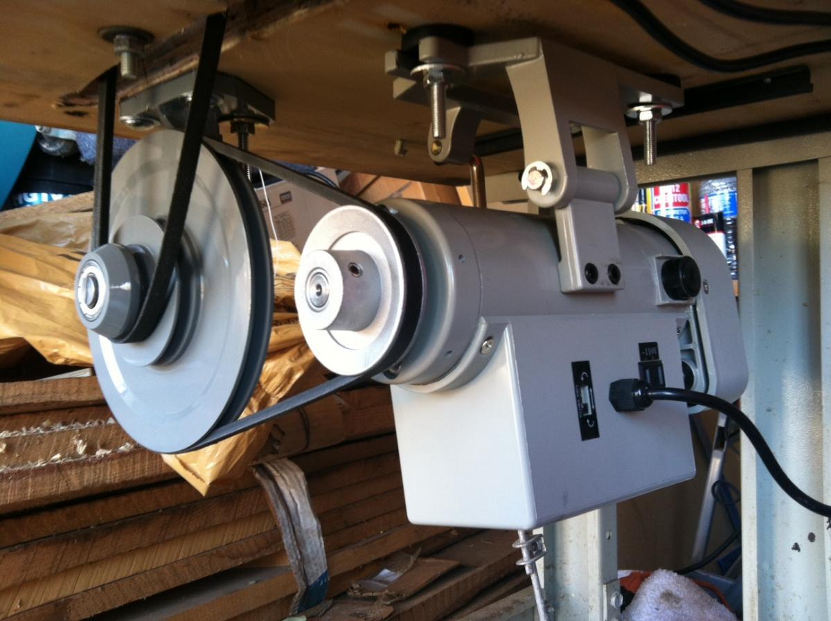

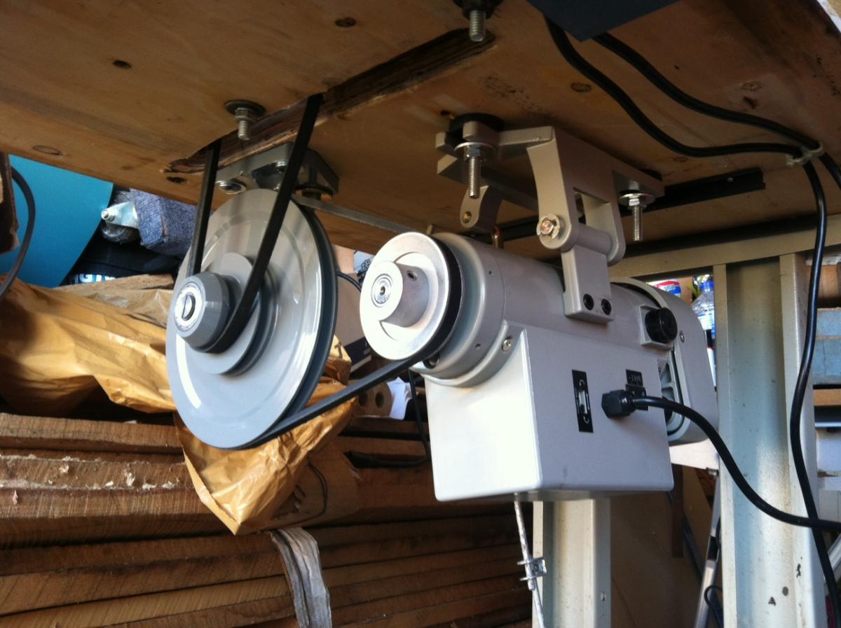

I am a novice to sewing leather on a machine -- all my leather work has been hand-stitched until now. I could not control the clutch motor on my machine. It was far too fast to do good work. After advice from people on this forum, this is what I installed. It was not a difficult job and the difference is absolutely amazing. It hurt my budget for a while to buy the servo motor and the reducer pulley, but it was worth it.

I am also a novice with sewing machines. On my machine I replaced the clutch motor with a servo motor and added a speed reducing pulley. This produced a DRAMATIC difference in sewing speed. The machine is now manageable and a pleasure to use.

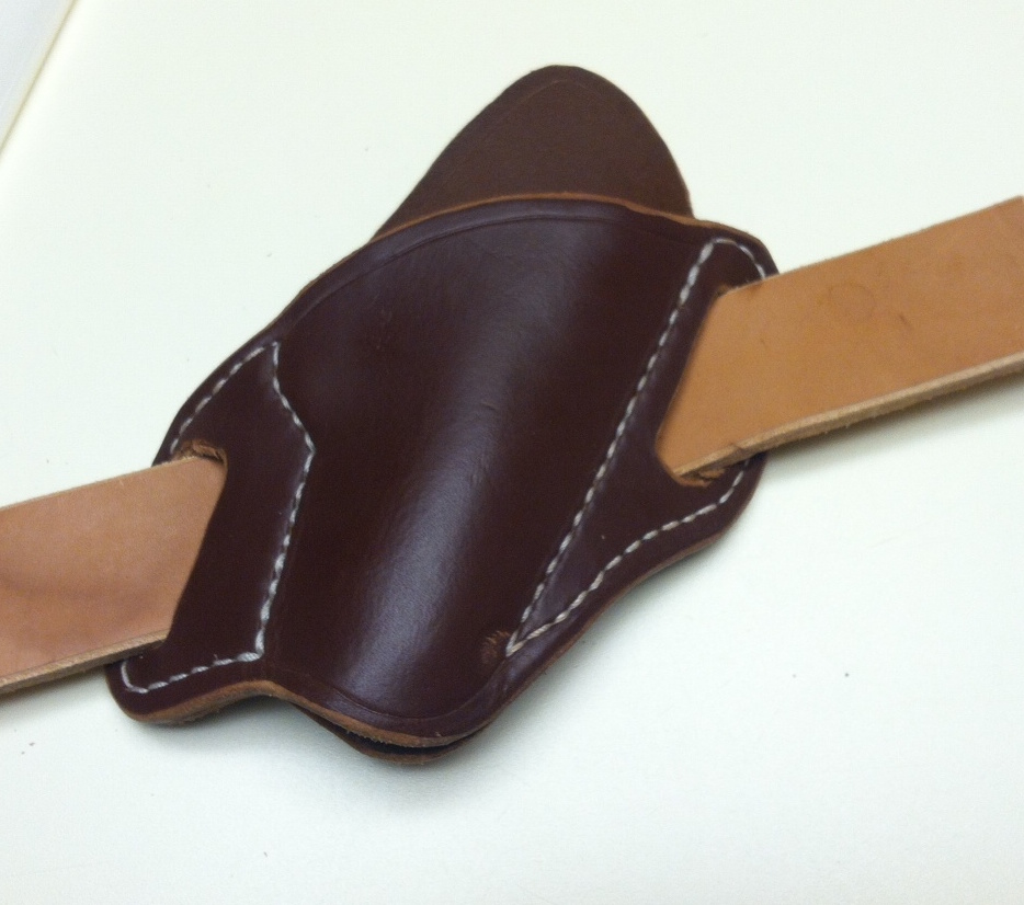

"This photo is also a sample of some prefinished leather I bought from a company that closed six years ago. It will not mold with any detail like veg tan, so I am assuming it is not veg tan. It will shape generically to the gun, but with no detail. It heavily resisted water when I soaked it to mold it. I am assuming it is either bridle leather or chrome tanned. How can one tell the difference?" I have since learned that this leather is Wickett-Craig English Bridle. Who knew? I suspect it will be great for belts, not so much for holsters that need to be molded. As it is from a leather company that closed six years ago, I have discovered that it needs a little conditioning to restore 100% usability. Part of the learning curve for a sewing machine newbie. The new parts for the Beast are scheduled to arrive tomorrow. Slower speed and I will be able to see the needle via the open-toe center presser foot. One baby step at a time.

I experimented with this leather, making a pancake holster. It would not mold like regular veg tan and resisted softening with water. With veg tan I can get a lot of detail when boning; with this bridle leather I cannot mold any detail. It forms to the general shape generically, but I cannot bone in any lines or detail. For me, it has been a different animal. I am thinking it is not useful for holsters but may be very useful for gun belts. Before I experiment with finishing the edges I thought I would ask and maybe reduce the learning curve. Thanks for the feedback. It is appreciated.

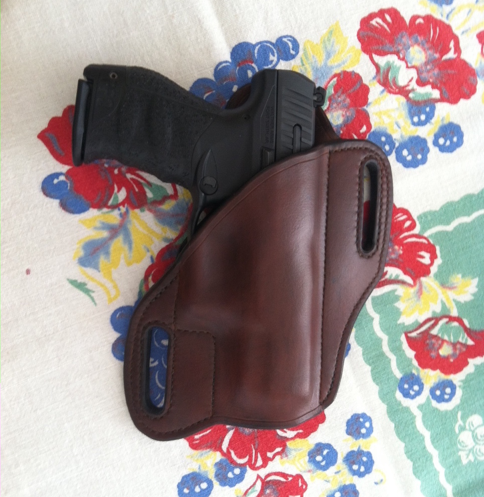

The 50mm pulley is ordered from Weaver, as is an open-toe center presser foot. When it arrives I will grind off the stitch-pressing ridge on the bottom of the foot and polish it. I also bought a sewing machine motor and pedal to make a dedicated bobbin winder (since the adler bobbin winder will no longer work on my modified machine). I sewed my first project on the machine today -- a holster for the Walther PPK/S. It is not finished (clean-up, sanding and finishing of belt slots; burnishing of edges, dyeing of edges left to do), but it is stitched and formed (as much as is possible) to the pistol. You can see the machine is still a little too fast for my lack of skill. I missed the stitch groove in a few areas as I was trying to follow the curve and hit the stitch groove without using the edge guide. I discovered free-handing is not easy for a beginner: This is the first thing I have stitched using the Beast, other than scraps and samples. By the end of next week with the additional parts I should see an improvement. This holster is not good enough to sell as it was only an experiment using some old leather I acquired, but it will hold my Walther just fine. This photo is also a sample of some prefinished leather I bought from a company that closed six years ago. It will not mold with any detail like veg tan, so I am assuming it is not veg tan. It will shape generically to the gun, but with no detail. It heavily resisted water when I soaked it to mold it. I am assuming it is either bridle leather or chrome tanned. How can one tell the difference?

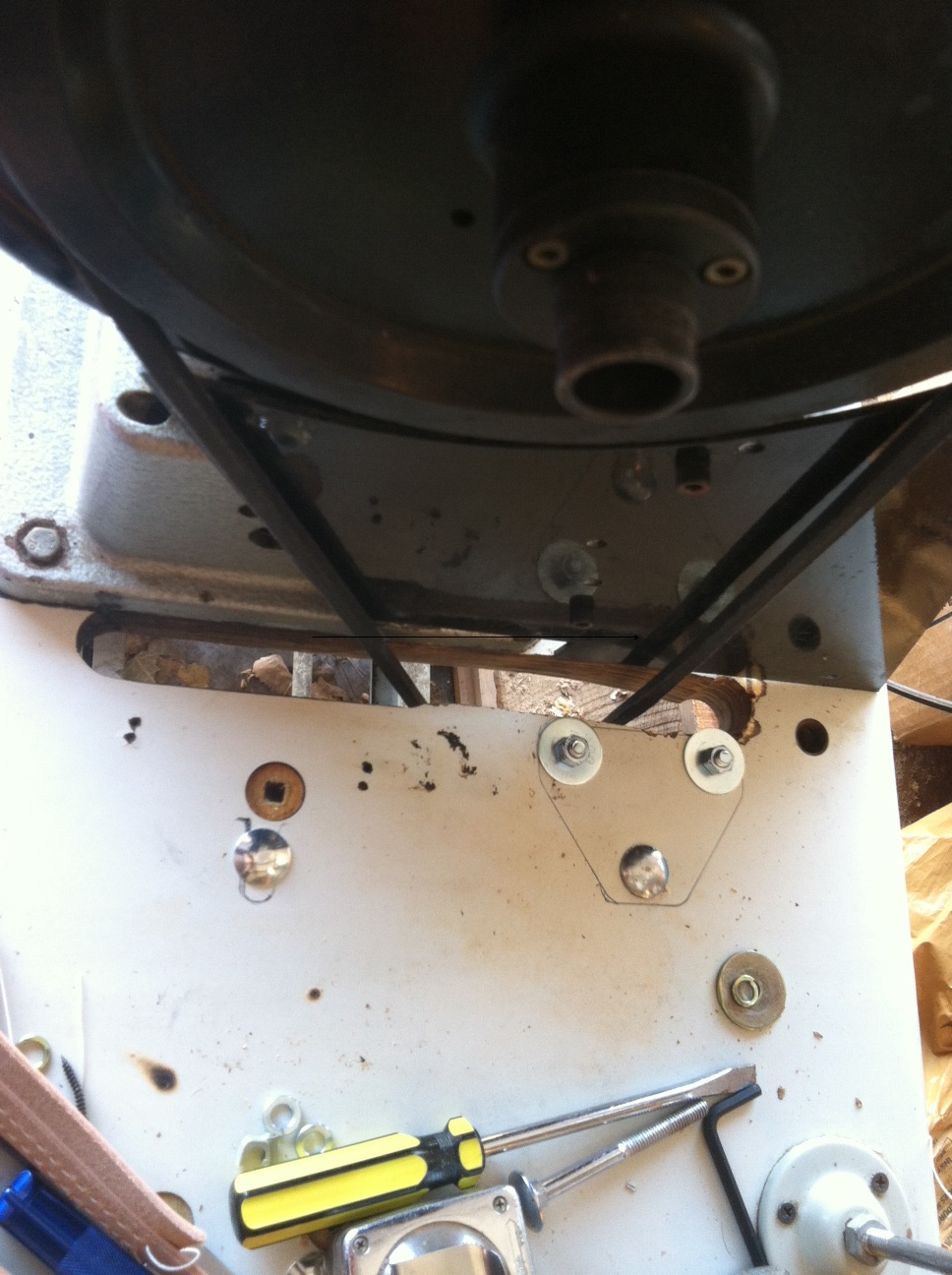

I have been ill for a few days, but did get some photos of the conversion today. The drive belt did go straight down and slightly to the left toward the front of the table, although the machine drive belt shroud is designed for the belt to go toward the back of the table -- to the right in this photo. I elongated the slot toward the back of the table. I then placed the speed reducer upside down on top of the table and lined it up with the hand wheel pulley. The motor was placed upside down on the table toward the front and aligned with the small belt to the large pulley on the reducer. After measuring, I simply marked where the bolts were to go -- different from where the old clutch motor hung. Holes were bored and everything was lined up underneath the table and bolted down and tensioned. Works great! The belt shroud now fits properly, whereas originally the bolts on the left were adjusted to allow the belt to go straight down awkwardly: The difference in speed and control over the old clutch motor is dramatic. The pulley on the servo is 3". If I put a 50mm pulley on it (slightly less than 2"), will the speed be further reduced? The bobbin winder was mounted to use the belt in its former configuration. Now that the belt is fully covered by the shroud, I will need to get a sewing machine motor and make a separate bobbin winder. Thanks for all the help on this rebuild project. Here is the beast. It looks rough but is smooth as butter in its function. Almost time to move it out of the garage where I have been working on it.
