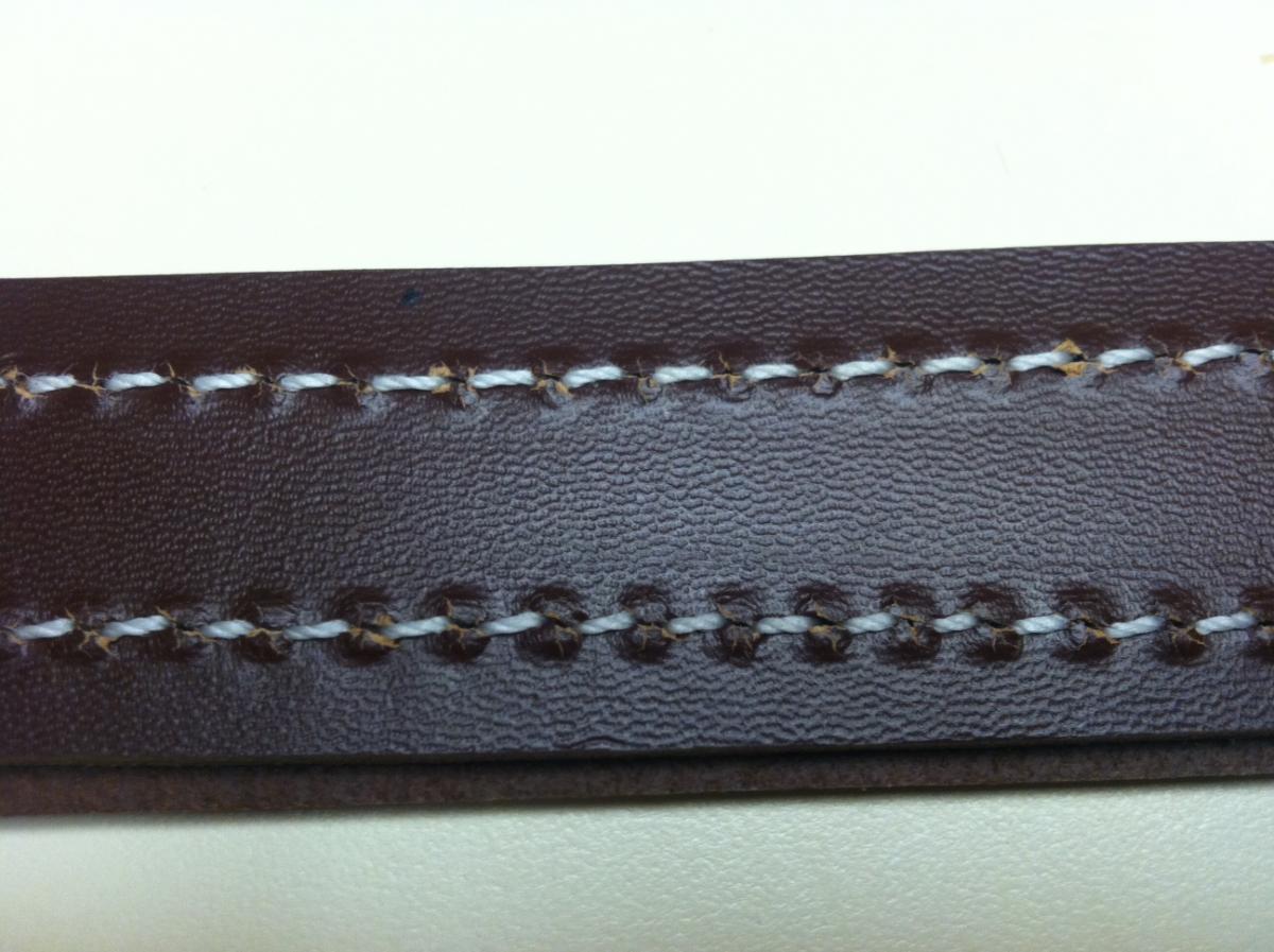

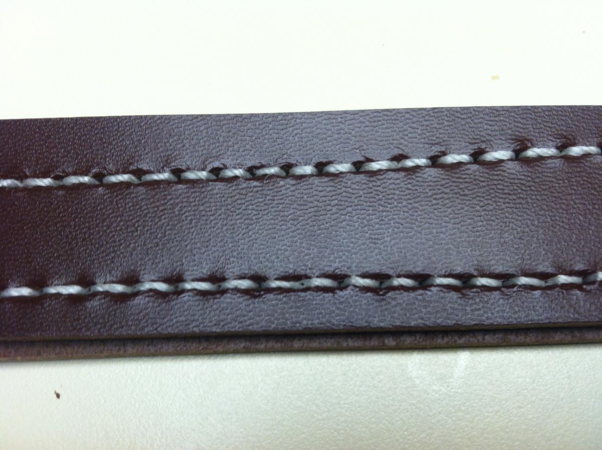

I discovered the fracturing on the backside of the leather by the needle is not a sewing machine issue. The prefinished leather I obtained from a company that went out of business about six years ago is now dried out. The double layers stitched here are fine on the top stitch, but fractured on the bottom layer, which actually displays another "top". Does anyone know of a conditioner I can put on this prefinished veg tan that will make it supple again and not prone to fracturing where the needle punctures on the back side? Here is the top side of the same piece showing the stitching as the needle enters. It is acceptable. As it exits on the bottom side, the dry leather finish fractures as it is no longer supple. Hoping to find an answer so I can use this leather. It is otherwise very good stuff.
