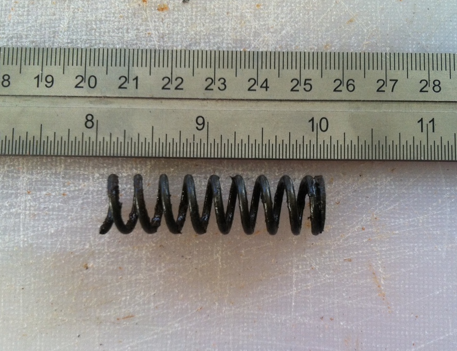

O.k., I read the manual again, watched Uwe's video and adjusted the foot lift on the old 205-374. The marks were eliminated from the top stitch. The height of the presser feet was at 5 mm during the lift cycle, it is now at 10 mm. Much better. It needs some tweeking, however, as now the presser foot lever to lift the presser feet won't lock open. Also, there is another difference from Uwe's video. His presser foot adjustment spring is similar to my own, but it appears the previous owner added a two inch section of spring to increase the pressure on the feet. Here is the extra part that I removed: Question: should I leave this short spring out? The main spring is exactly as the one in Uwe's video. The presser foot adjustment knob on top of the machine is somewhat difficult to adjust. I may need to remove the presser foot rod and get in there with chemtool and a tooth brush to clean the threads better. As a novice I really don't know how much pressure should be adjusted into the mix -- i.e., how tight should the tension be on the presser feet? -
