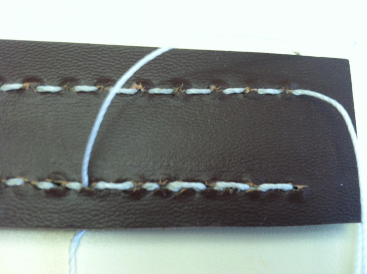

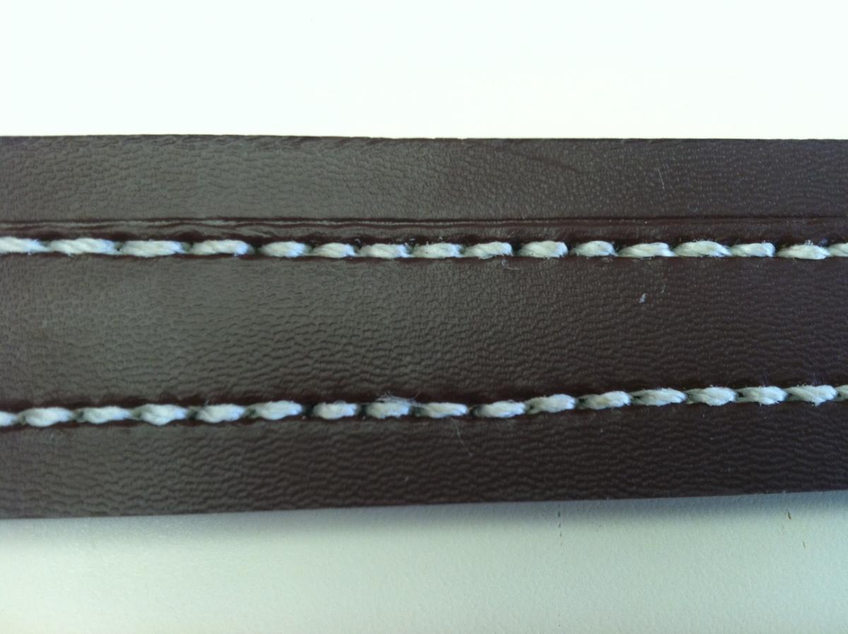

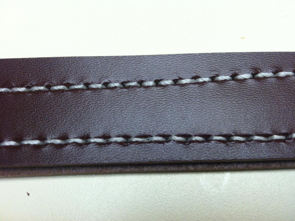

I had a moment to work on the Beast again this morning. As Uwe suggested I added more presser foot pressure in the event the leather was slipping in conjunction with the thread tension. That helped. The stitches are more consistent, but not yet perfect. Perhaps more pressure is needed. The backstitching in reverse was the same result, skipping every other hole. And it did not automatically go into the same hole even using the roller guide -- it laid the stitch side-by-side. I talked to Allen at Weaver and he had me do a few tests with the stitch lever vis-a-vis the feed dog while on the phone. He suggested putting a shim behind the upper part of the black rubberized plate behind the stitch lever in the reverse area -- he suggested a shim of 1/16" to 1/8". I have not yet done that, but there is an adjustment plate in that location designed to hold the lever further out -- same as a shim. I adjusted that stop downward to hold the lever off the surface of the plate about 1/8". That helped. It put the stitch back into each hole. However, the stitch in reverse looks good on the top, but the bottom is not clean. It almost looks like a stitch that is out of tension, showing a pull-through. Puzzling. I will go with Allen's suggestion of a shim and see how that develops. Thanks for the help. It is appreciated.

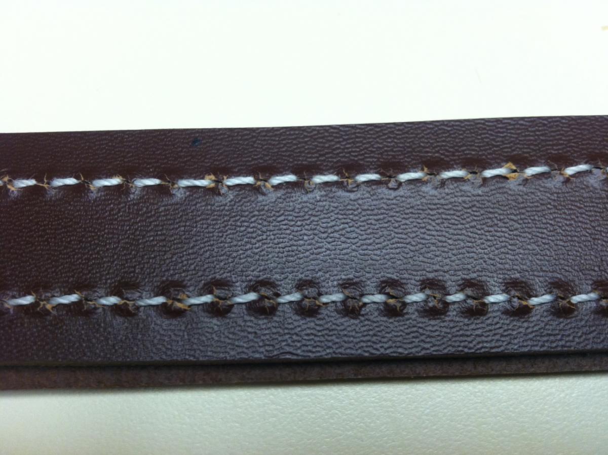

I did indeed turn it by hand first to confirm the adjustments and settings. Then I powered it up. This is when I got the inconsistent stitch length and weird reverse stitching. Late afternoon I took Uwe's advice and increased the pressure on the presser foot. That helped clean the stitches up to a more consistent stitch length. It is not perfect yet, but better. I'll increase the pressure more tomorrow and see if it solves the problem. I think I may have inadvertently increased the stitch length at the start by pulling excessively on the tread from the bobbin and top as I began the stitching line. Also, it may be that I was pushing or pulling the material through the stitching process instead of allowing the machine to set the pace. I am definitely paying my stupid tax as a newbie to using sewing machines! I checked the needle and detected a burr on the spear point. I changed the needle and that seemed to help a little on the fracturing on the backside, but the new needle also developed a burr and the fracturing exposing tiny amounts of raw leather reappeared. Do needles need to be honed? Here is the second sample from late afternoon for the top side: a little better on consistent stitch length: Here is the back side, a little better but not great: This sample is prefinished leather and most of my work is in veg tan which fares a little better. The fracturing of the hole on the backside of the prefinished leather where the needle punches through leaves a lot to be desired. Normally my hand sewn stitches are laid into a grooved stitch line. These samples are not. Is it possible the stitches will improve in appearance when I manage to lay the stitch into a preformed groove?
Thanks Uwe. Today was the first day it was up and running after the repair. I wondered about the outer presser foot pressure -- in the first two photos you'll notice there are no marks from the outer presser foot, whereas most of the photo samples I have seen on leatherworker.net have at least mild impressions. The feet on this machine are harness-makers feet and I assumed I would have to buy smooth and bigger feet to minimize that issue. So I was happy today when it made no marks. I'll put more pressure on the outer presser foot tomorrow and see if it helps. Perhaps it is slipping in conjunction with the thread tension. I have had a hard time observing the actual mechanics while sewing samples as I still have a clutch motor that speeds up beyond my ability to sew (servo and speed reducer pulley will be my next purchase). But I will try to be more observant and report what I see. I did check the only screw on the stitch length lever I could see and it seems firm.

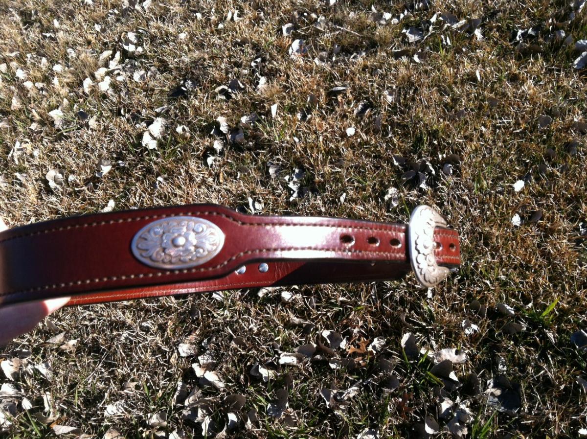

Thanks, guys. I checked the hardware store. Everything with the right thread would have pulled through the hole for the concho or stood proud of the leather much like the chicago screw. I did jury-rig a fix, however. I discovered Tandy carries 3/8" concho screws. Too long for my purposes, but I went back to the hardware store and bought some hex nuts that fit the longer concho screw. I put two of them on the screw with just under 1/8" of the screw exposed and locked the nuts together with wrenches. I then ground off the amount I needed to eliminate. When I broke the bond on the two hex nuts and threaded them off, the hex nuts by default cleaned up the threads as they were coming off the screw. A little blue locktite and everything snugged together like a charm with a nice low profile on the back side -- nothing to rub on clothing. Thanks again for the suggestions. Very helpful. -

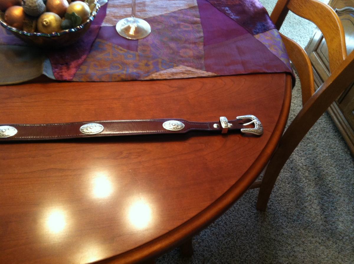

Blasted auto-correct changed the heading on the first post to "ponchos". Grrrrrrrr. A client wishes to have Tandy Diablo oval conchos on his gun belt. Problem: the screw that comes with the Tandy concho is made for a single layer of leather and a gun belt is a double layer -- about 1/4". Tandy does not have longer screws. The screw that comes with the concho is too short. A 1/4" Chicago screw will work, but it is domed whereas the concho screw is much flatter and the Chicago screw might abrade clothing. Anyone have a source for concho screws with a flatter head that will work for 1/4" leather? Probably 7mm to 8mm.
