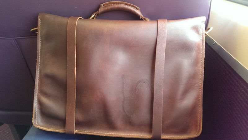

Finally completed the shoulder strap for my bag.......i thinks its done lol. I ended up reinforcing the 2 inch wide strap through its full length with a 1 inch wide tie down webbing strap for no stretch and found a neat trick to punch the holes through and make them really neat. . Not sure if this is usually done or not but due to the webbing i cannot punch the buckle holes right through, so i punched either side and removed the little leather plugs then used a pointed tip soldering iron to shrink back and melt through on either side to create a perfect sealed hole. Worked really well if anyone has the same issues as i did. Knowing myself i will be adding the odd little pouch here and there on the inside , even thinking of an external water bottle carrier ? will have to design it in a way to look good though and match the design of the bag.- 15 replies

Forgot to add a feature i thought was cool , to try to keep the cows brand scar on the bag so i incorporated it into the back.- 15 replies

Hi Guys, Thanks for all the positive comments. Mr byggyns to answer your question the leather is oil tanned Kodiak Hide from Tandy - beautiful stuff pics dont do it justice - in a weight of 4 -5 oz. All of the hardware is Solid Brass. I have reinforced the strap points and handle with polyester webbing for strength. I have also used a 1 inch wide piece of aluminium under the handle covered in thin hide for support and drilled through this to attach the handle with 4 brass bolts. The lifting points for the shoulder strap are also reinforced and bolted through the three layers of leather on each end which form the gusset/centre divider . The main wide strap in the centre uses a Brass Sam Brown stud for quick access at the office if required. Feel free to ask if you have any more queries. Thanks Dan- 15 replies

Hi Guys and Girls, This is my first post here, I am making an Expedition / messenger bag for my laptop and other work related stuff. I have not done any leather work since i was teenager - made a simple wallet last week and forgot how much i enjoyed it. Apart from the wallet this is my first saddle stitch attempt . For this project i was not after perfection as i need to get it together as quick as i can to be able to use it, so far it has taken me two days. Note to oneself : Do not attempt to saddle stitch for a whole day without prior conditioning lol, my right hands cramped up and i know i will be sorry for it tomorrow. Any way here are some pics of the progress so far and of a stitching pony i made too which has been a godsend for this project. Hope you enjoy and criticism welcome. Regards, Dan
