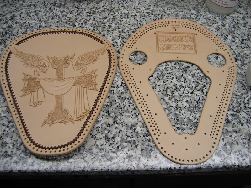

  1. Here is the final installment on this one. Dave

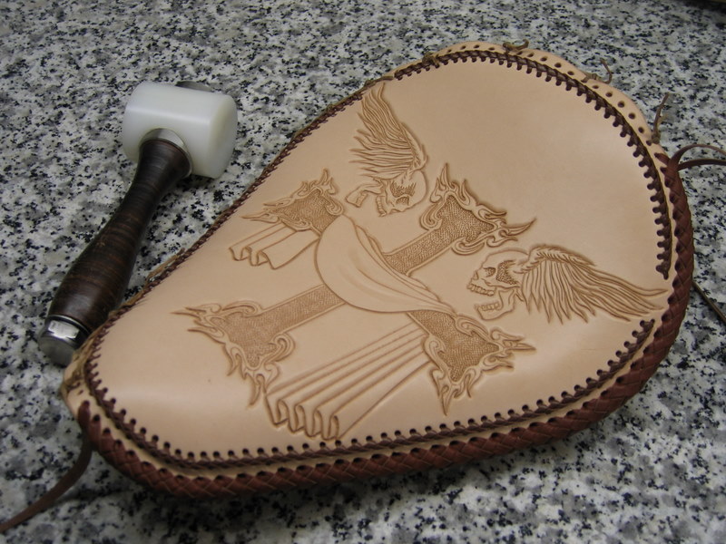

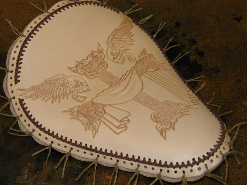

  2. Getting close to being finished now. The seat pan gets preped with washers and padding, then the padding trimmed to final shape. The seat back is riveted on and the seat front tied in place. Then the lacing starts. David Theobald

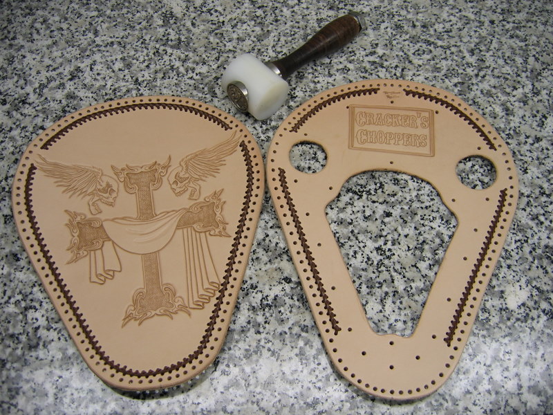

  4. This decorative stitch is a simple single loop stitch, it's taught in all of Tandy's basic lacing books.Dave The edge lacing is all that holds the leather to the pan. I don't use any glue to on my seats at all.Dave Theobald

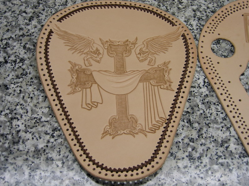

  5. If you look at the photos of my front and back leathers, you will see that they are NOT the same by any means. I arrive at my patterns by covering the front (including padding) and rear with tape. When removed and flattened out it becomes the shape of my patterns. I use 1/4" lace pulled through 1/8" holes. They are about 1/8" from the edge and about 3/8" apart. All my lace is kangaroo. Since the front and rear leathers are not the same it requires a very careful layout of the holes. Lay your holes out around a centerline on the front and back pattern. Measure twice, punch once! My seat construction will allow padding up to 3/4" thick. If he is wanting a real thick padded seat, contact Roger Harris (Roger here on the LW site) for techniques. or look at the tutorial by Paul Cox. http://www.bikernet.com/garage/coxseat.asp Hope this helps, Dave Theobald Dave

  11. Day 4, the only thing remaining to do before the pan arrived was to add the decorative lacing to the rear leather. Don't hesitate to ask questions.... This may be as close as I get to a tutorial again. Dave
  12. The seat was requested to be for a "show bike" so to me that means decorative lacing. So a lot more holes were punched in the front and rear leathers. The name was added to the rear leather. And the decorative lace was added to the front on day 3.

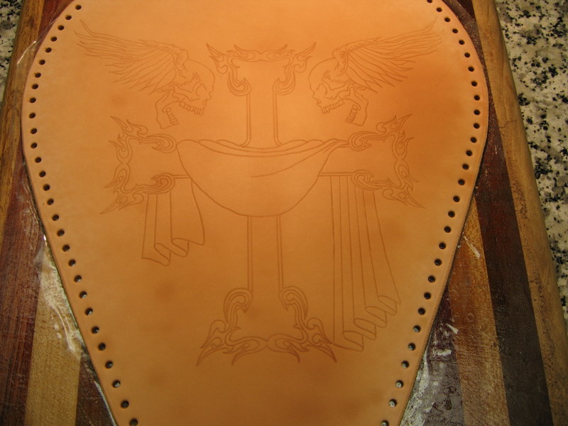

  13. Day two, was a Saturday, so I had all day to work on it and I cut the entire design and finished the tooling. It was a long day.
  14. A customer sent me a photo of a shirt purchased at Sturgis. She liked the cross but wanted to add some.........skulls (what else? With wings no less!) Now I'm not a skull kind of guy but hey, she is the customer after all. I did a sketch for her which she liked. The drape on the cross changed from an American flag to just a cloth drape..... so here we go with the latest seat. The first day I cut my patters and I traced the design onto the leather. That was about all I finished that first day.
  15. I had a bit of trouble finishing this on, The antiquing left a blotch on the leather. Not too sure what may have caused it. I stripped the seat with deglazer and shot some Saddletan on the front and back, then I re-antiqued it with sheridan paste. Dave

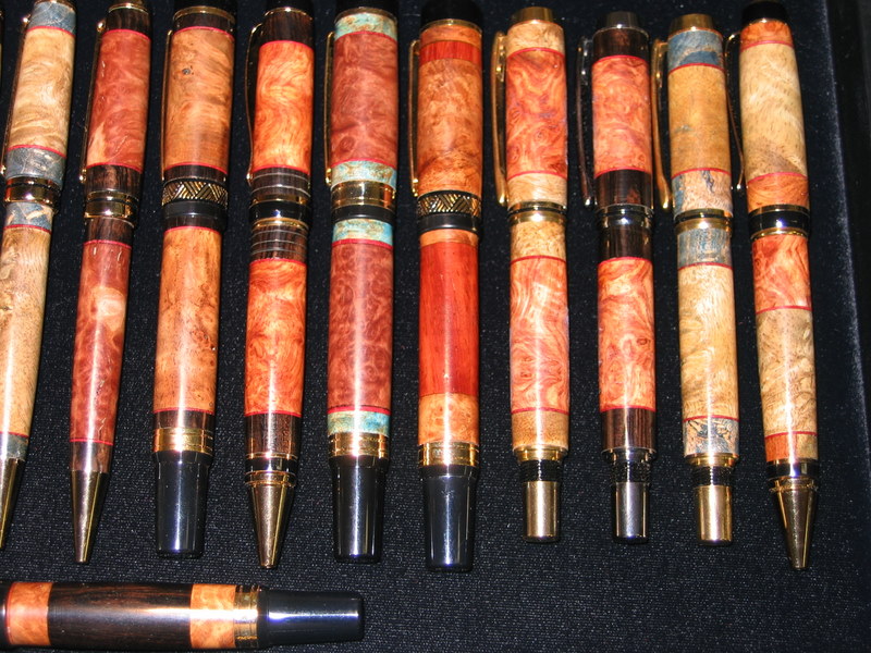

  23. Hey Johanna, Thanks for the encouraging words. Everyone is missing Richard terribly. He was like the brother I never had. Actually for the last 40 years, I called him Brother Dick. The pens are fun to do. Here are a few pics Dave

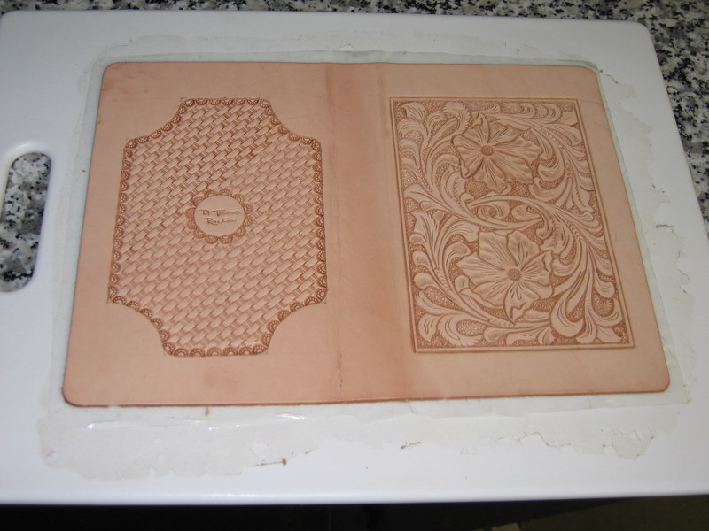

  24. Thanks all, The inside of the leather was grooved to be folded before the tooling was done, I didn't actually fold it until I was nearly done.... I had to wet it a bit to make sure it would close all the way. The inside of the note book is a kip lining about 1oz or so. It is a 6 ring binder .... so it is like the kits that Tandy makes. Yeah, I made the pen too. I've been pen turning for a couple years. I love the look of different woods combined to make the pens. This one is paduk (dark orange), malee (birdseye grain), and dyed blue curly maple. Dave
