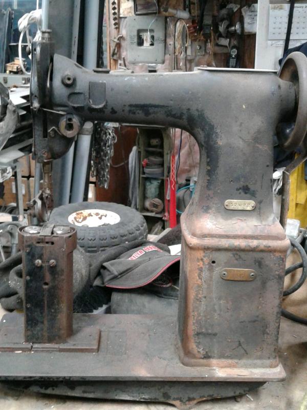

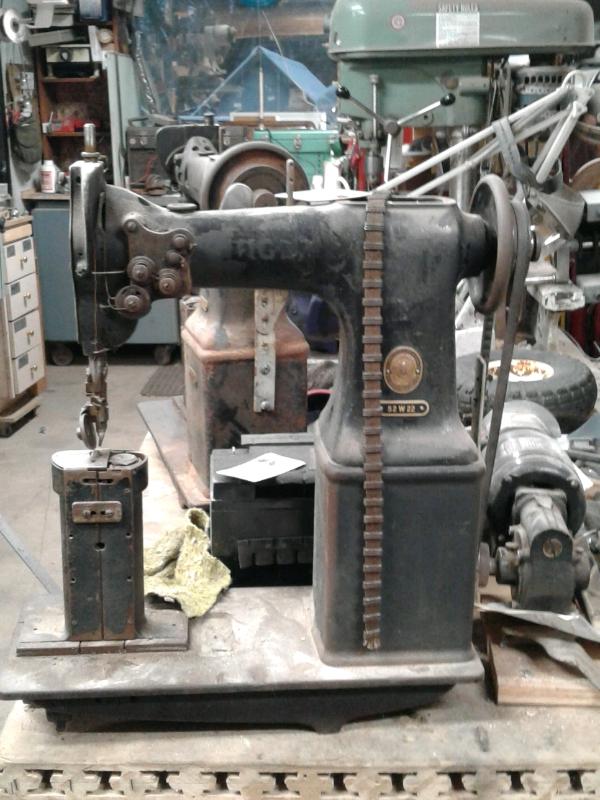

I am negotiating the purchase of a 52W22. One of the machines is missing the tensioner assembly. Any idea of where one can be found? Would another brand work? Thanks iron1951

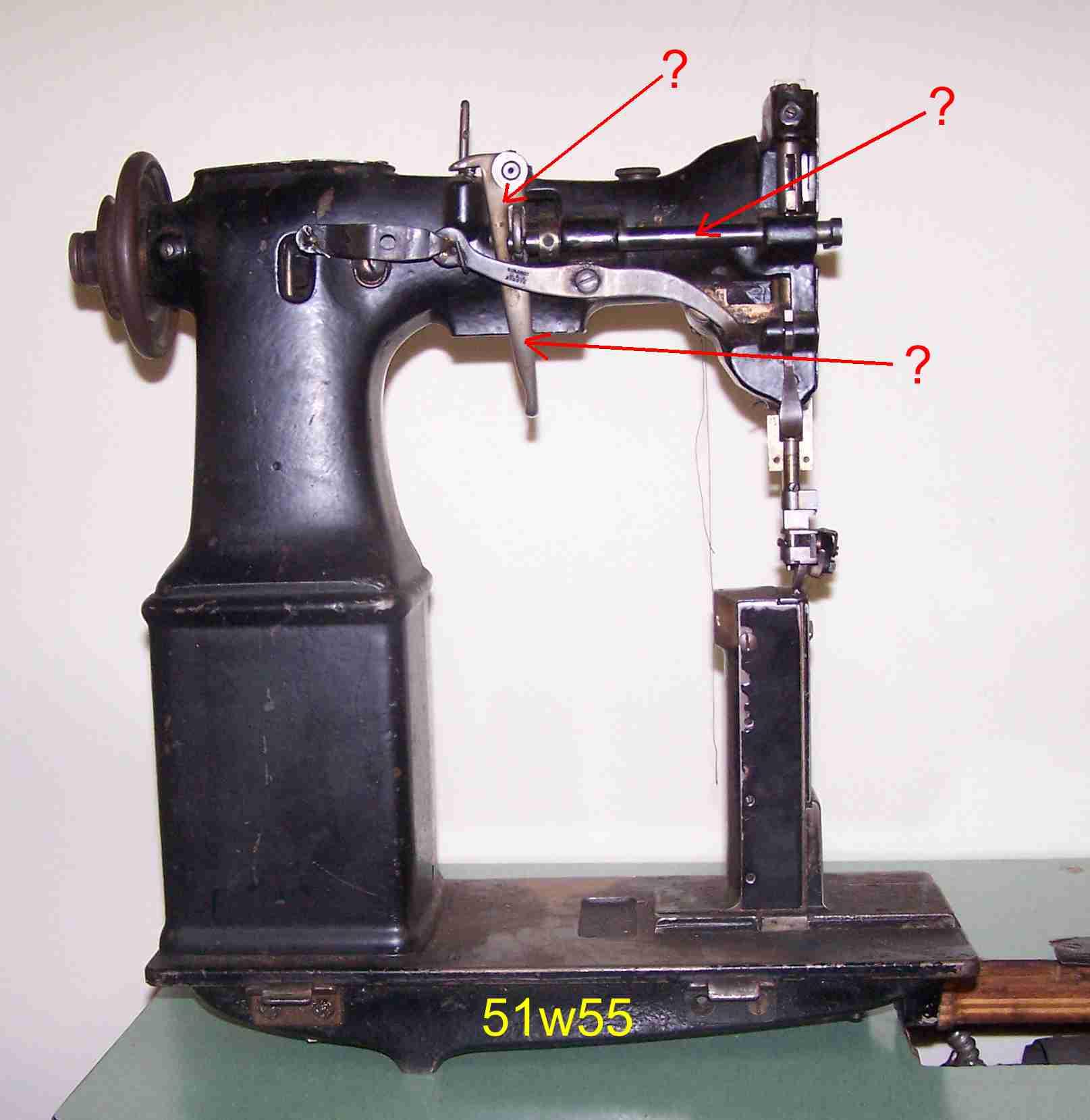

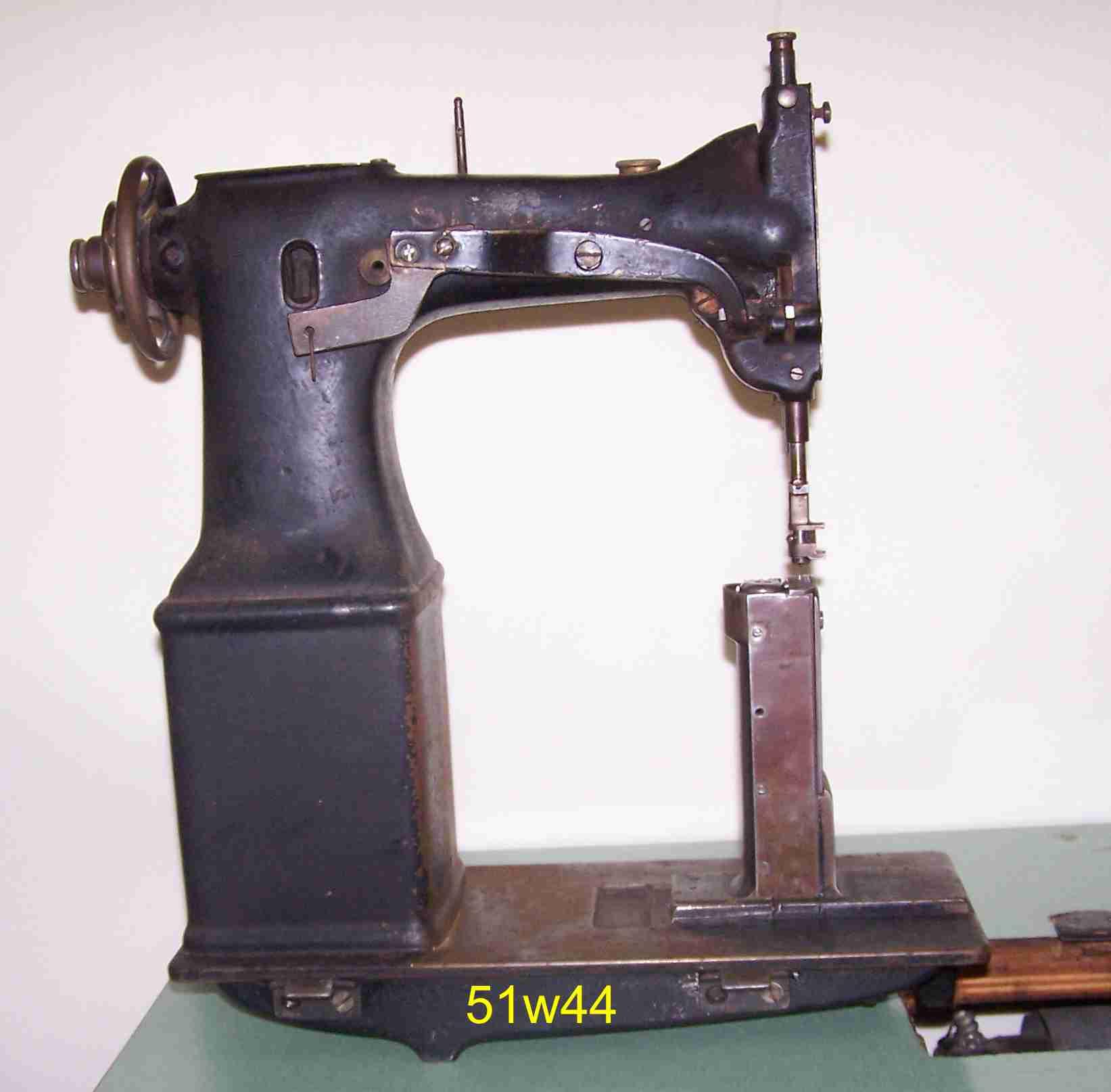

Does anyone know what these parts do on the 51w55. They are not there on my 51w44. I have no idea. Thanks iron1951.
