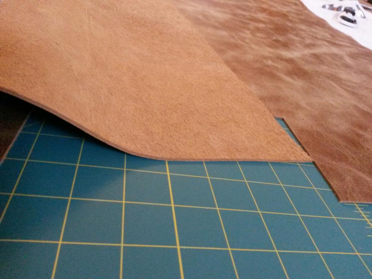

  3. Thanks again Oldhat! Some parts of the flesh side of this leather I'm using are quite nice and smooth, while other sections are a bit rougher. I wasn't planning on lining it, as I kind of like the look of the raw flesh side interior. What are some of the benefits of lining bags? Aesthetics and protection I would think? Thanks so much for the responses. I'll post some pictures of the project so far. I still plan to add handles, some magnets to keep it shut. and decorative panels on both sides with 1) a monogram & 2) inlaid leather design.
