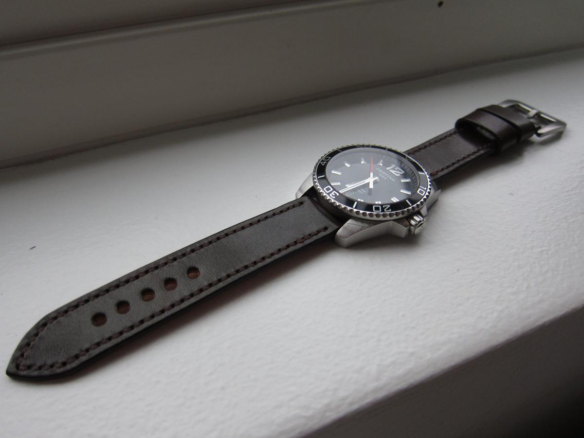

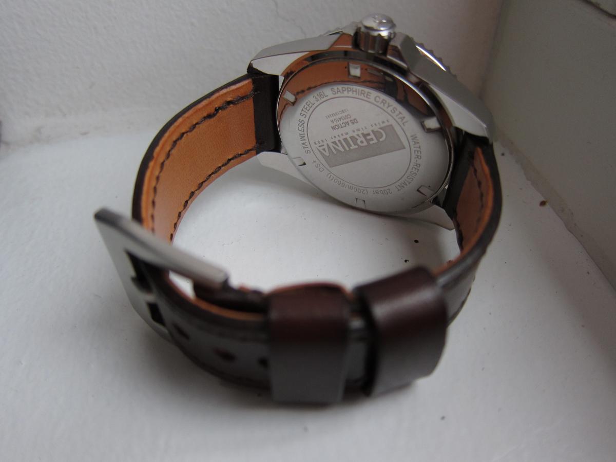

Watch Strap With Lining.
DR80 replied to DR80's topic in Purses, Wallets, Belts and Miscellaneous Pocket Items
I don't think i understand what you mean, can you explain it further? -

Ok sounds good, because i used tan-kote and some Sedgwick leather care on my watch strap, and was a little worried it won't be enough protection. -

Hello, this will be my first post here, so i start with an apologize for my bad grammatics and spelling (I'm from from Sweden so this is not my first language) I'm soon going to start my first leather project, which will be a watch strap in rubber (No of course in leather ) I have a question regarding the finishing of the saddle stitch. In tutorials the recommendation is to back stitch two or three stitches, but i have seen some leatherwork with just one back stitch (see the attached file) I use linen thread if that matters. How to finish that stitch in a good way? perhaps someone have a tutorial that shows this? And one last question. What thread and dimension is used in the watch strap that i attached, is it possible to see? Thanks in advance.
