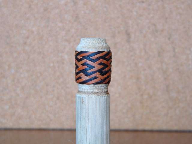

G'day all Here is a new knot that I have been working on .It looks a bit different to the norm. I have added the instructions for tying this knot and the interweave. I have only tied this one once myself ,really didn't know what it would come out like. full_10_part_7_bight.pdf Cheers Chris full_10_part_7_bight.pdf
hi Roo The instructions are set out as if the knot has been sliced straight down the back so that on side correspondes to the other. Just think of it as a cylinder that is flattened out so that you can see every part of it .Following the unders and overs will help to understand the diagrams. Hope this helps. Cheers Chris

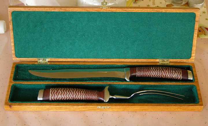

G'day all This is a pic of a carving set that I made a short while ago. A friend did the knife & fork work I just braided the handles. The handles are braided from rawhide kangaroo and kangaroo whip thonging The instruction is for the base knot before any interweave has been added. hopefully I'll get some time to do the the interweave instruction soon . Long_knot_mixed_sequence.pdfCheers Chris Long_knot_mixed_sequence.pdf
