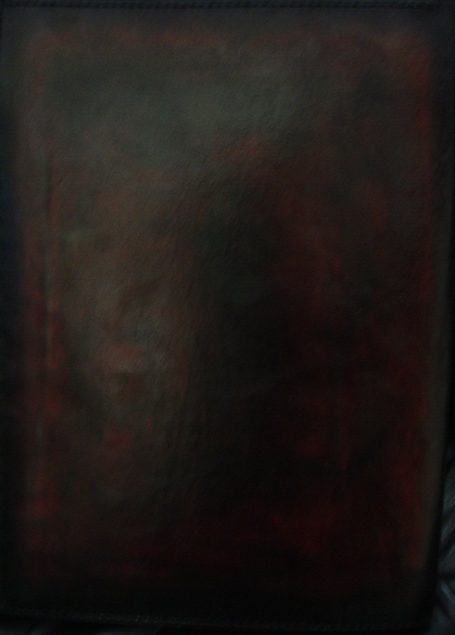

Trouble with dry-dying
Schno replied to Schno's topic in Dyes, Antiques, Stains, Glues, Waxes, Finishes and Conditioners.
There seems to be such a science to dying and coloring that it really is a distinct discipline in and unto itself. I've avoided picking up a book on it, assuming that the techniques therein would be based on the pre-VOC-prohibition days. Since I live in California, a lot of the solutions they describe are now considered contraband. Feibings Dye Prep... sounds intriguing. What does it do? I notice that you don't use the carnuba cream at all. I'll try that route on my next piece. I'm trying out different finishes. At first I was using Supersheen. That, like the carnuba cream, tended to smear and streak my dye job when I brushed it on. On recommendation, I tried Feibings Resolene with an aerosol spray nozzle gig. That sprayed very uneven and clogged almost immediately. I finally resorted to applying the Resolene with a brush, and that took me back to the smeared and streaky debacle. I'm unfamiliar with these other solutions. Are there any that would spray on easily and be available in California at the same time? Yep. I'm new at this, so I don't really know any better I'm going to try it out some day, and I'm sure that when I do, I'll wonder why I waited so long. Here's some examples of what I've managed with the dry dying so far. They turn out okay-ish, but only after quite a bit of adrenaline pumping oh-@*%! moments and a lot of TLC afterwards. So I'm sure there has to be a better way! Thanks for your help with this, guys! -

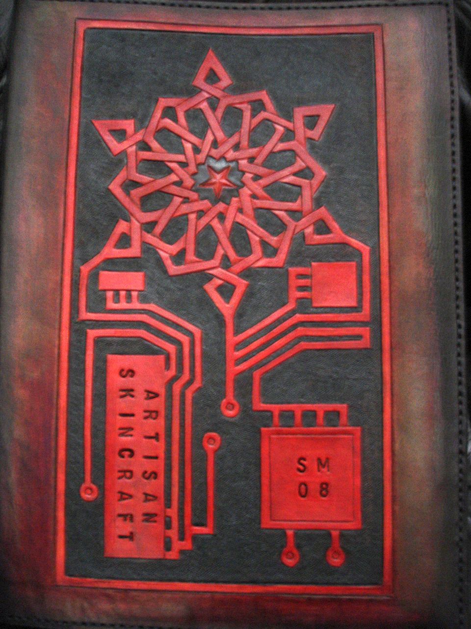

I've had a couple of requests for leather journals, so I thought I might make my maiden voyage with my own. Better to make all the mistakes on mine before putting a pricetag on it. The journal is intended for meetings at work, where as a telecom project manager, I spend my days herding geeks. I wanted to mix a bit of my love for knotwork with a bit of circuitry and here's the result, front and back. Let me know whatcha think: good, bad, constructive, destructive, etc!

Hey guys, I'm having a bit of trouble with my dry-dye technique and I know this is a great forum for answers. You people are incredible! Okay, so... the dry-dye technique I was taught is: 1) apply a very small amount of light color dye (red in my current project) to a dry sponge. 2) brush the dye into the leather 3) repeat steps 1 and 2 for the dark color (black in my current project) 4) apply a coat of carnuba cream to the dyed leather 5) let the carnuba cream dry (~10 minutes) 6) buff with wool scrap 7) repeat steps 1-6 until you achieve the desired effect My problem is that, seemingly, no matter how much or little dye I apply, or how long I wait, when I do step 4, the carnuba cream gets the colors all mixed up and sometimes gets streaky. I see the beautiful gradients that some of you guys get on your bike seats, and I know that's what I want to achieve. Are those dry-dyed or is that from air-brushing? It would be great if maybe you guys could post some pics of dry-dyed examples and techniques you use!
