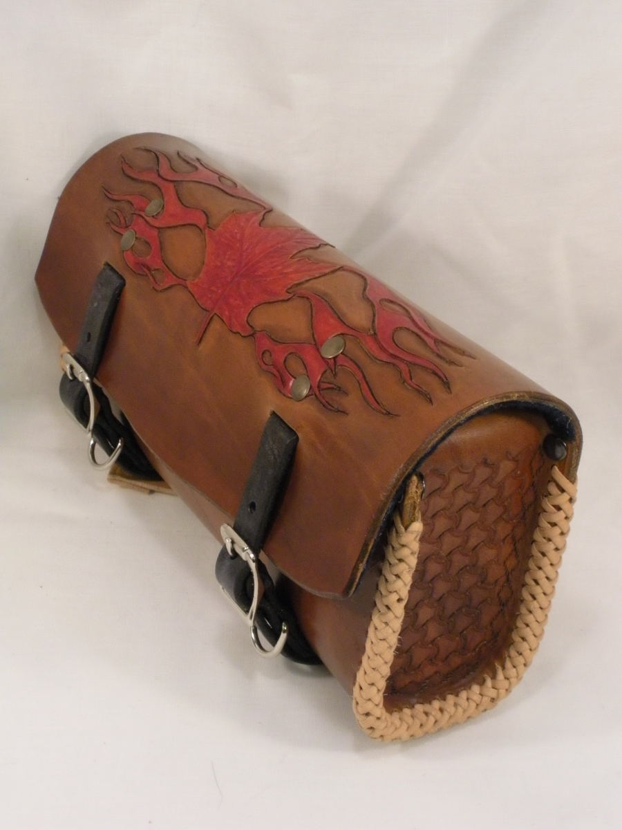

  4. Hi All, I've seen some nice toolbags, thought I'd start posting some of mine, this one hasn't been seen by the customer yet, but I really like it. Always glad to here comments, bad ones need advice also please (but I would still like to here it)
  5. wow great looking skull!!!
