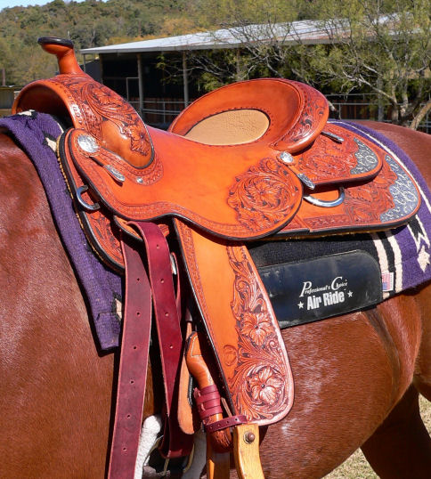

  16. You have to turn the blevins buckle over - remove it, flip it, re-rivet it in. Also, depending on how long the neck is, and how it is stitched, how thick the liner is, if there is one, it can be a tough deal to get that rounded to do the wrap. You can just twist it and not wrap it, although I prefer to do a wrap after the twist. You need to soak the fender neck in hot water after flipping the buckle over - it will help to soak the neck thru and, if the fenders aren't set either, soaking the entire fender set will be beneficial to taking the set. Just doing a twist alone won't set the fenders , and, if you don't do the entire fender after the twist, it can actually hurt your ankles/shins...let me know if that helps any! Attached is a pic of a fender that has been twisted, wrapped, and set - this was done during the build of this saddle, so not 'aftermarket' - sorry, don't have any pix of any factory type saddles that I did this on, although I have done them, and as described here...

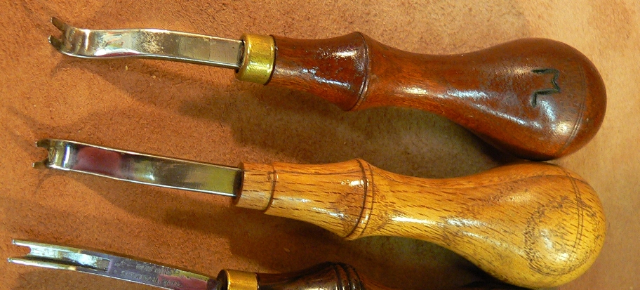

  17. Here is a pic of the two edgers I have left - the bottom corner shows another edger, but that was sold.
