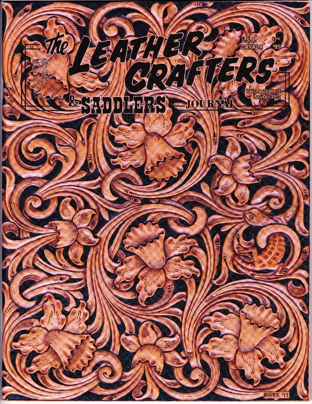

Thanks capster, Tina, Dave and Clair! I sure appreciate all your kind comments! The color issue isn't that big of a deal with me. I have learned through getting my book published that controlling colors can be very difficult. I suspect the panel was scanned/photographed by the printer and then returned to the Journal before a comparison was done. That's the case with my photo as well. I took pictures and then rushed off to get the panel in the mail and I know from experience that when I take photos, I don't get the settings right and then I have to manipulate the photo to try to compensate for my lack of photography skills, so my photo is a little off also. There is also the problem of color interpretation between the screen and the printer itself. There are just so many variables! But I have to tell you that I'm just shallow enough that I love hearing that you like my version better, LOL!! Bobby -

Thanks Ed!! I'm not very good at getting the white balance correct on my camera so my photo is off color also. -
Here is a panel I tooled for the LC&SJ cover as well as a shot of the cover itself. Thought you might enjoy seeing the before and after. There are some color differences between the two photos. I think the original is somewhere in the middle. Hope you enjoy and of course all comments are welcome!! Thanks for looking! Bobby PS. I have lots of copies of my new book in case anyone is interested!!
