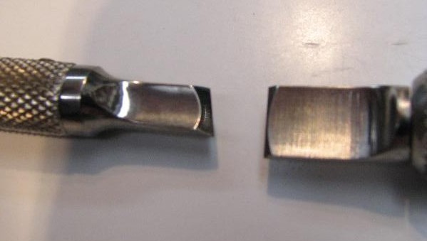

Terry, that is what I was trying to say. The thin part of the blade created by the HG usually never comes in contact with the leather because only the tip of the blade is used. There are a couple of exceptions of course, such as when cutting a straight line. In that instance the blade is laid flat in an effort to get as much blade as possible in the leather which helps to prevent wandering. The other exception might be where a very thin blade is used on heavy skirting leather and the tooler is cutting very deep. But for the most part, the HG does not aid in making the cut. Paul, I agree that the logic would suggest that a thicker blade would benefit more than a thin blade from hollow grinding. In reality the opposite is true. The reason for this is that the length of the taper (to the cutting edge) on a thick blade is much longer than on a thin blade (assuming both are sharpened at the same angle). Consequently one would have to push a thick blade much deeper into the leather in order for the grind to make contact. I have a very thin Henley blade designed by Jim Jackson for finish cuts which is HG and the "grind" would contact the leather quickly in comparison to a thick blade (if I used it for that purpose, which I don't). So you can see that HG is really only effective on a thin blade with regard to cutting. On a thick blade the HG just looks good and provides a nice little spot to place the tip of the finger. And I think we all agree.....that is probably the only real benefit for any HG blade. In this photo you can see the difference in the length of the tapers on the two HG knives. The 1/4" tapered blade is twice as thick as the 3/8" staight blade. They are both sharpened at the same angle. (sorry for the poor photo quality!)
I prefer hollow ground blades over flat grinds but not for the reason you might think. A hollow swivel knife blade is never used deep enough in the leather for the hollow grind to be of any real benefit. However, when using the knife I find that I like to place the tip of my ring finger into the grind. It's a comfortable spot which gives me a little bit of control when using the knife. With the exception of my SK3, all of my blades are hollow ground. It might be a mental crutch, I don't know....nor do I care, LOL! I like hollow ground blades. Hope this helps.... Bobby
If you'll do a search you'll find a LOT of discussion on this subject. Not only on style of knife, but manufacturer too. You're also going to get a lot of different opinions. I generally recommend that a beginner start out with a 7/16" or 1/2" barrel with a 3/8" straight blade. I feel this is a good all around setup and once you really master it's use you will be ready to begin accumulating specialty knives.As far as blades go I happen to prefer hollow ground blades. One tip I can offer on knife length....do not buy a knife that forces you to close you hand down around it to grio it. You should be able to grip the knife with a fairly open hand. You will develop muscles in your fingers with practice and you will gain more control. I want to be able to place the cradle at the first knuckle toward the end of my finger. I disagree with using a short knife where the cradle lands behind the large knuckle at base of your hand. I also prefer a more aggressive knurl on my knives but I think I am probably the exception there. Hope this helps.... Bobby
