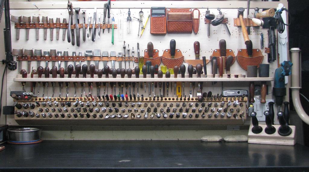

This is how I set mine up and it's worked pretty well for a number of years. The holes that hold my tools are 3/4" and there was a lot of room for expansion, however, I'm going to have to add more space soon. You can't tell from the photo, but the area below the stamping tools is open and so my leather can extend over the back of the bench if it needs to and I don't have to move any tools out of the way. I have a tendency to use my tools in sets, i.e., when I bevel I have several sizes out, or when I background I have several sizes out, and I place them on a leather "coaster" and then return them all as I finish with them. I really wouldn't change much of anything on the next one except that I might make the "block" narrower and taller....but not much either way. The only inconvenience for me is when I go and teach somewhere and need to haul tools with me. I'm considering just using leather tool rolls and stacking them on a shelf designed to hold them. It would be easier to take them with me and then replace them when I got home, but I haven't completely thought that through yet....there are some downsides to that idea. I took some photos and tried to "stitch" them together to create a panorama but Canon made downloading the software impossible so I gave up.....here is just a regular photo.... Bobby

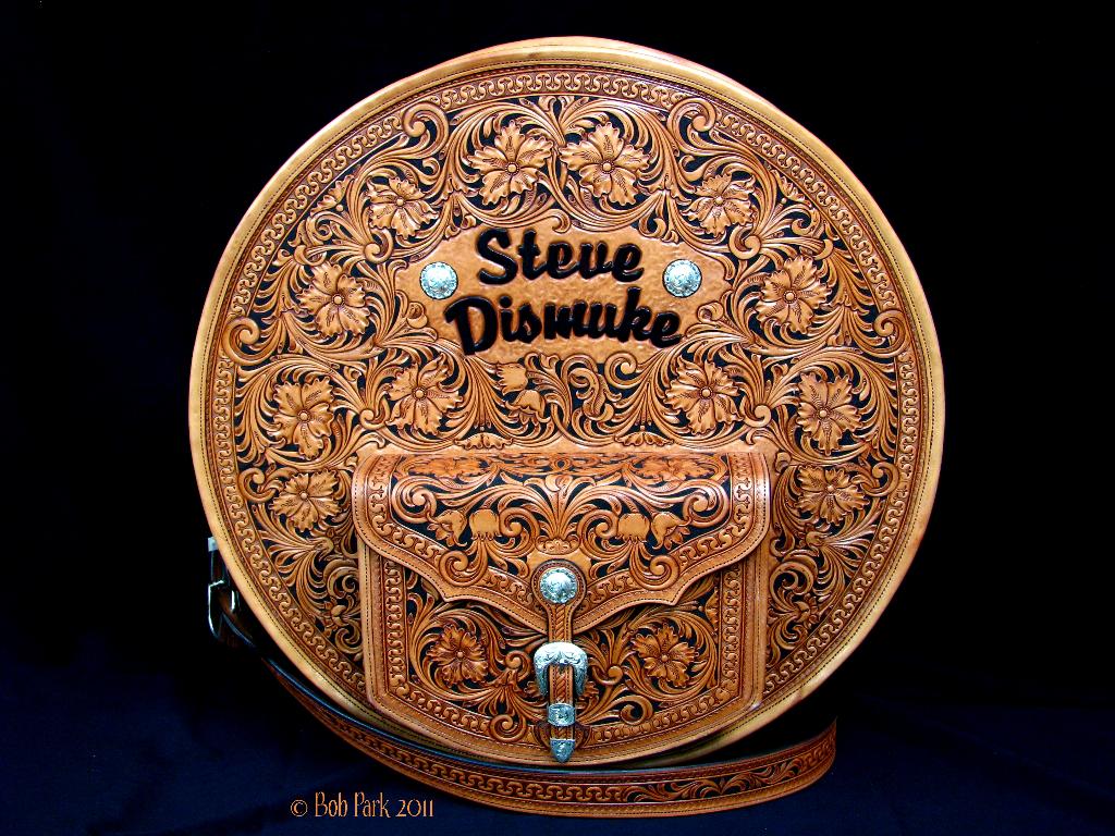

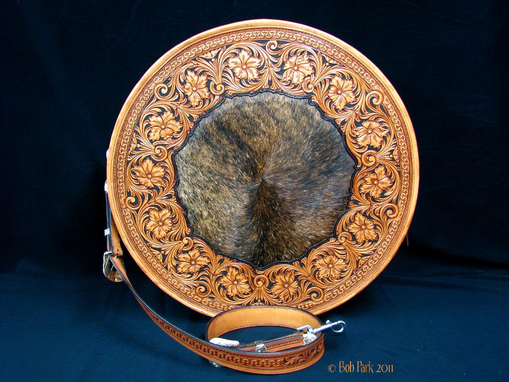

Here is a rope bag I just finished. Cowhide gussets and inlay on the back panel. The interior is fully lined with 1000 Denier PVC coated nylon. All comments and critiques welcome, of course.... Bobby
