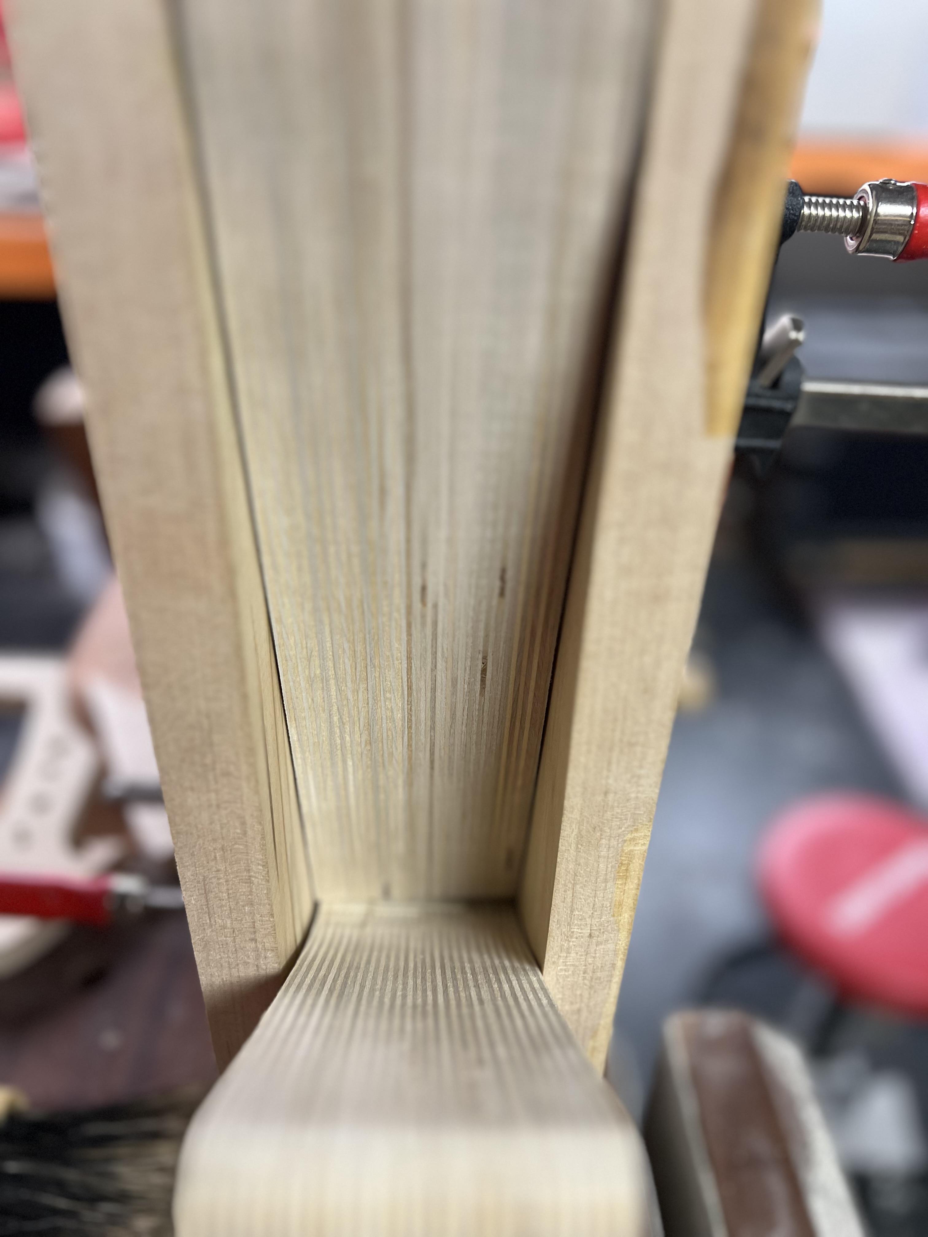

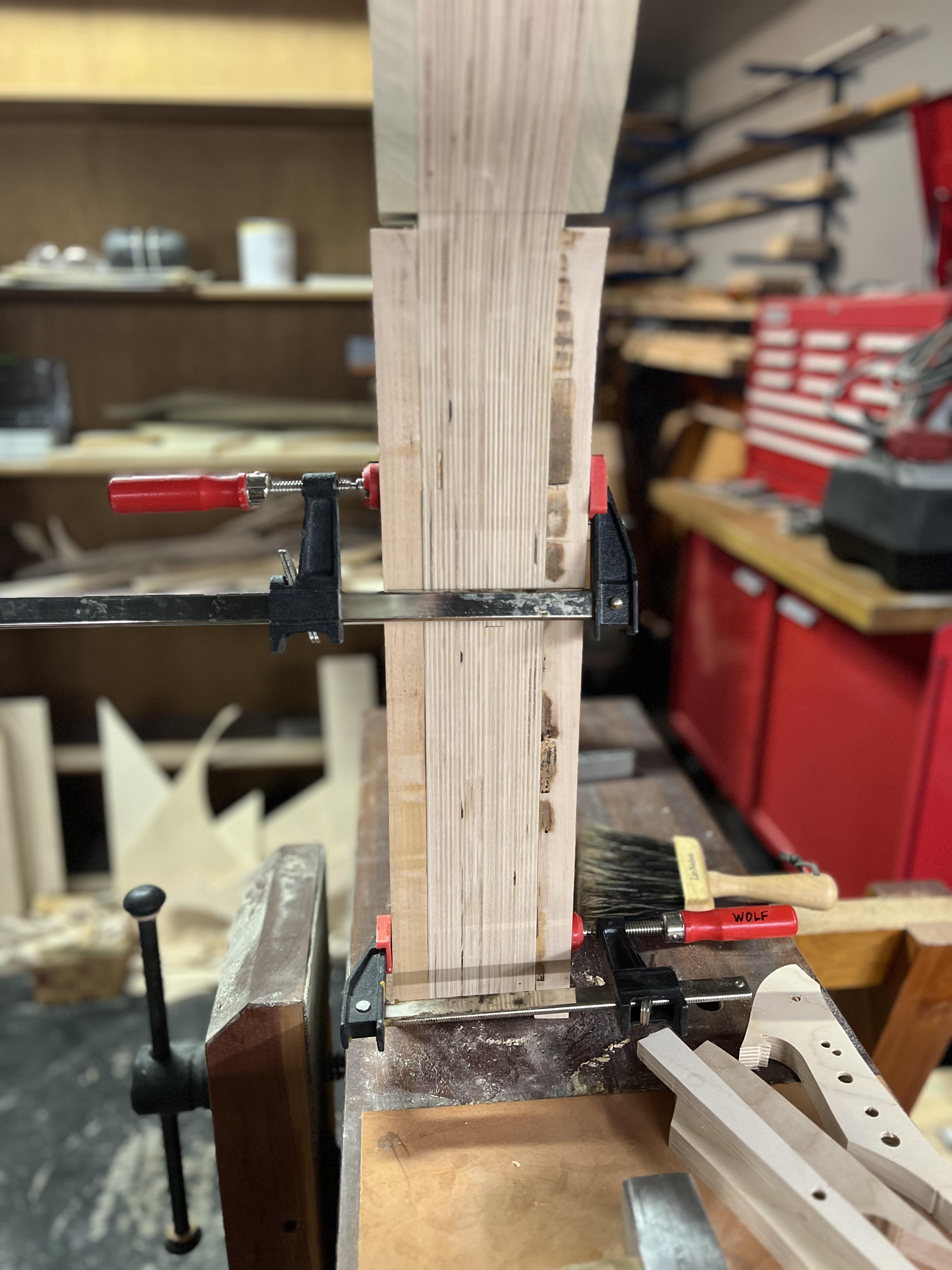

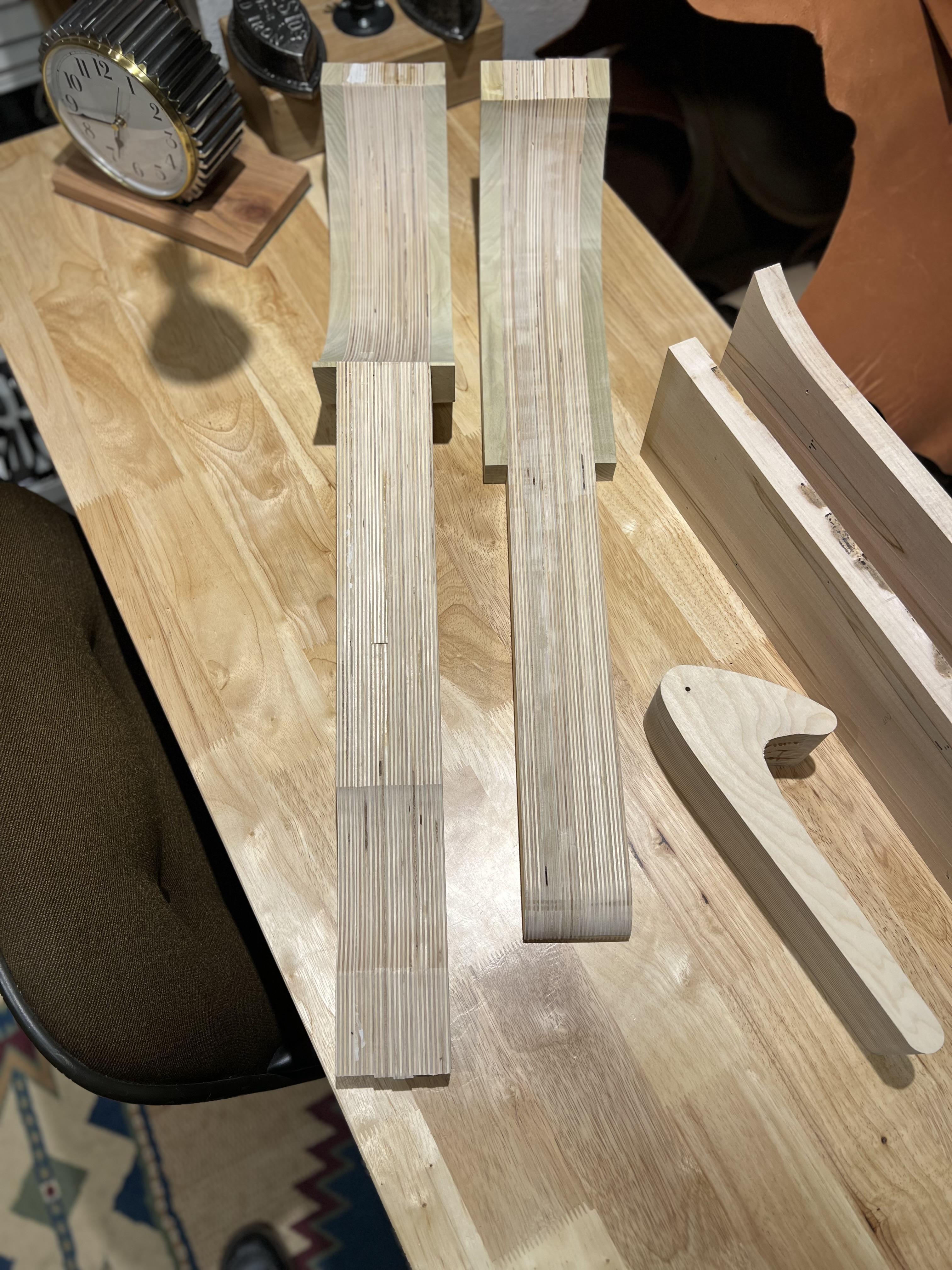

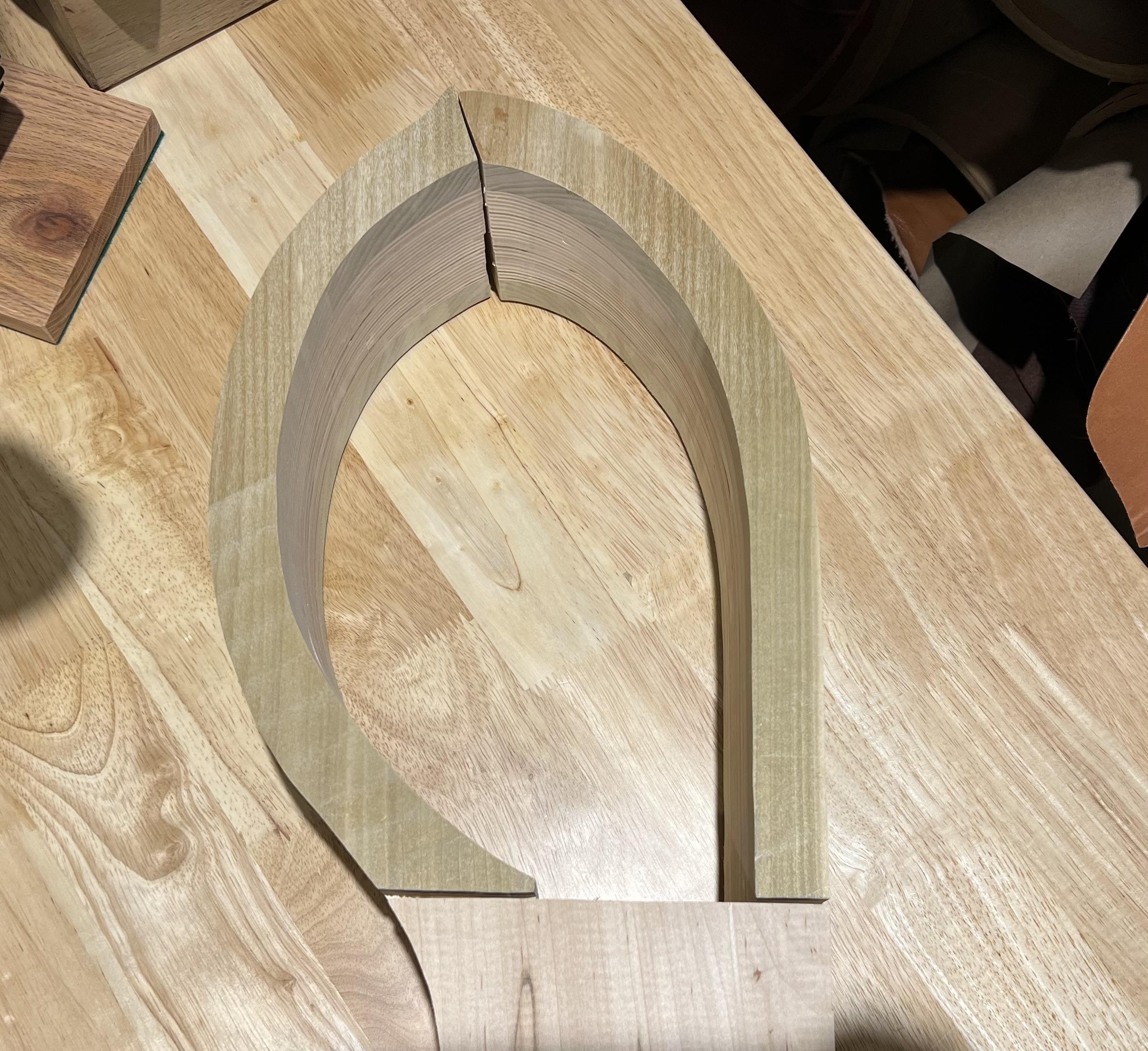

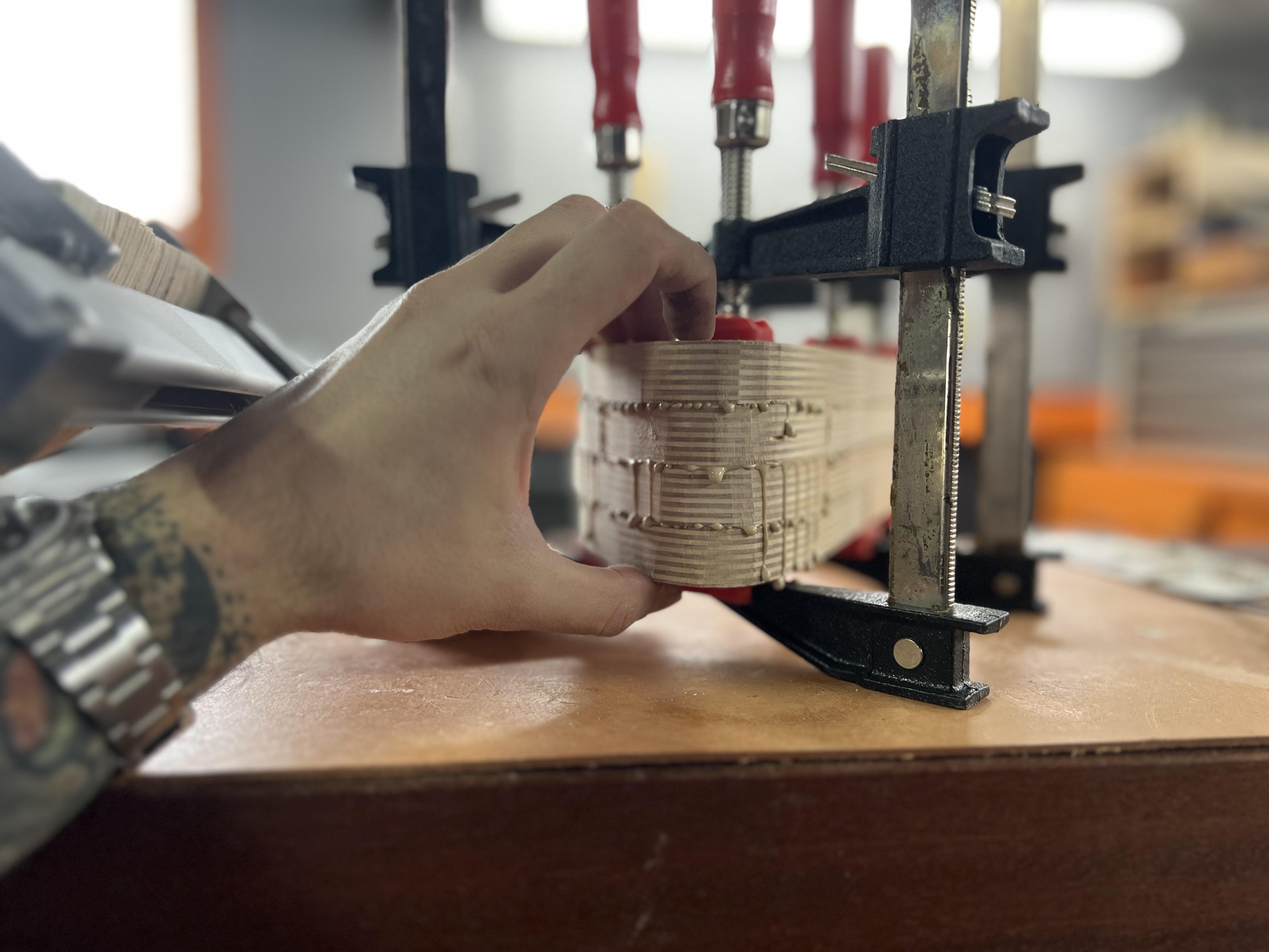

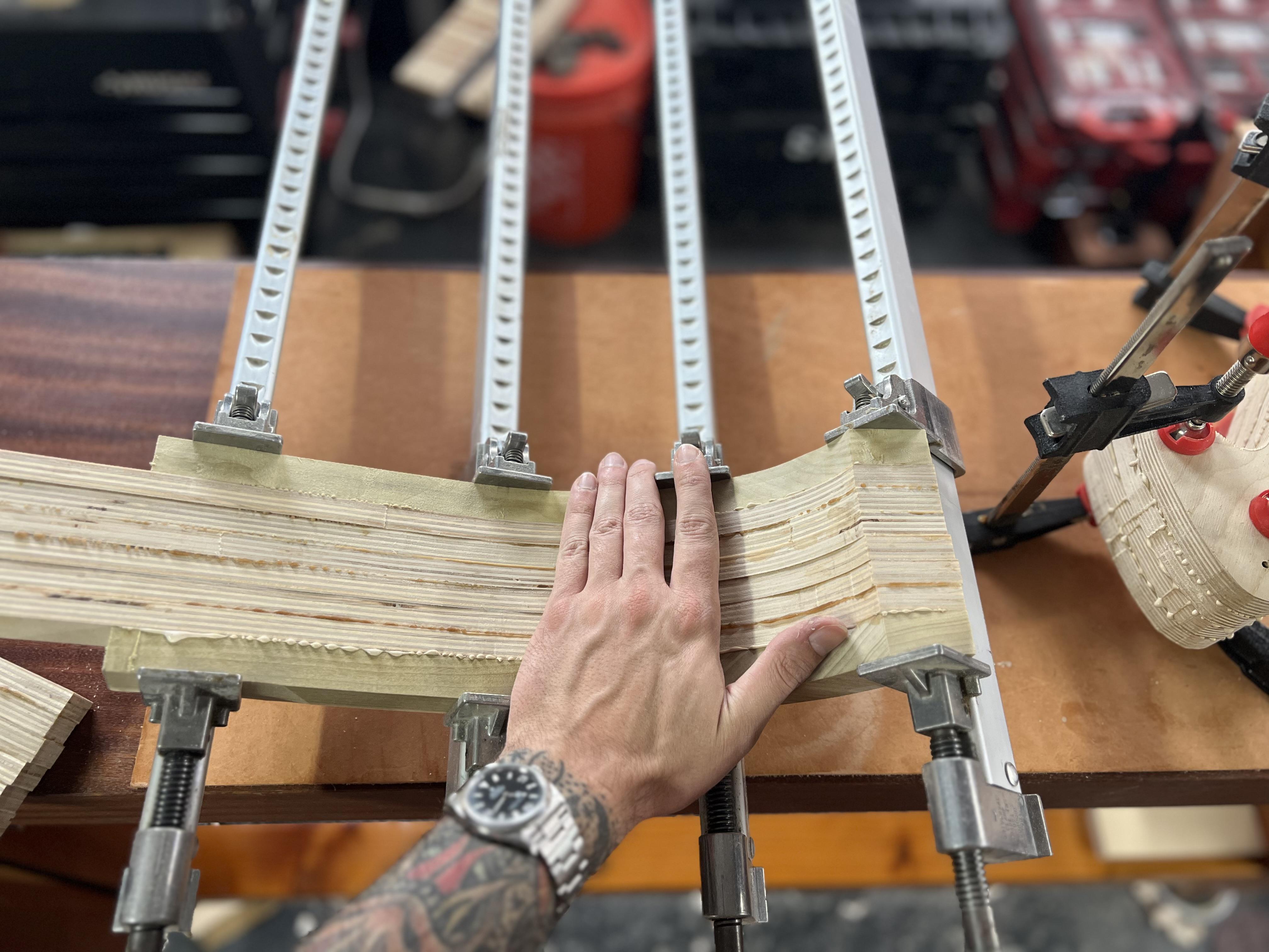

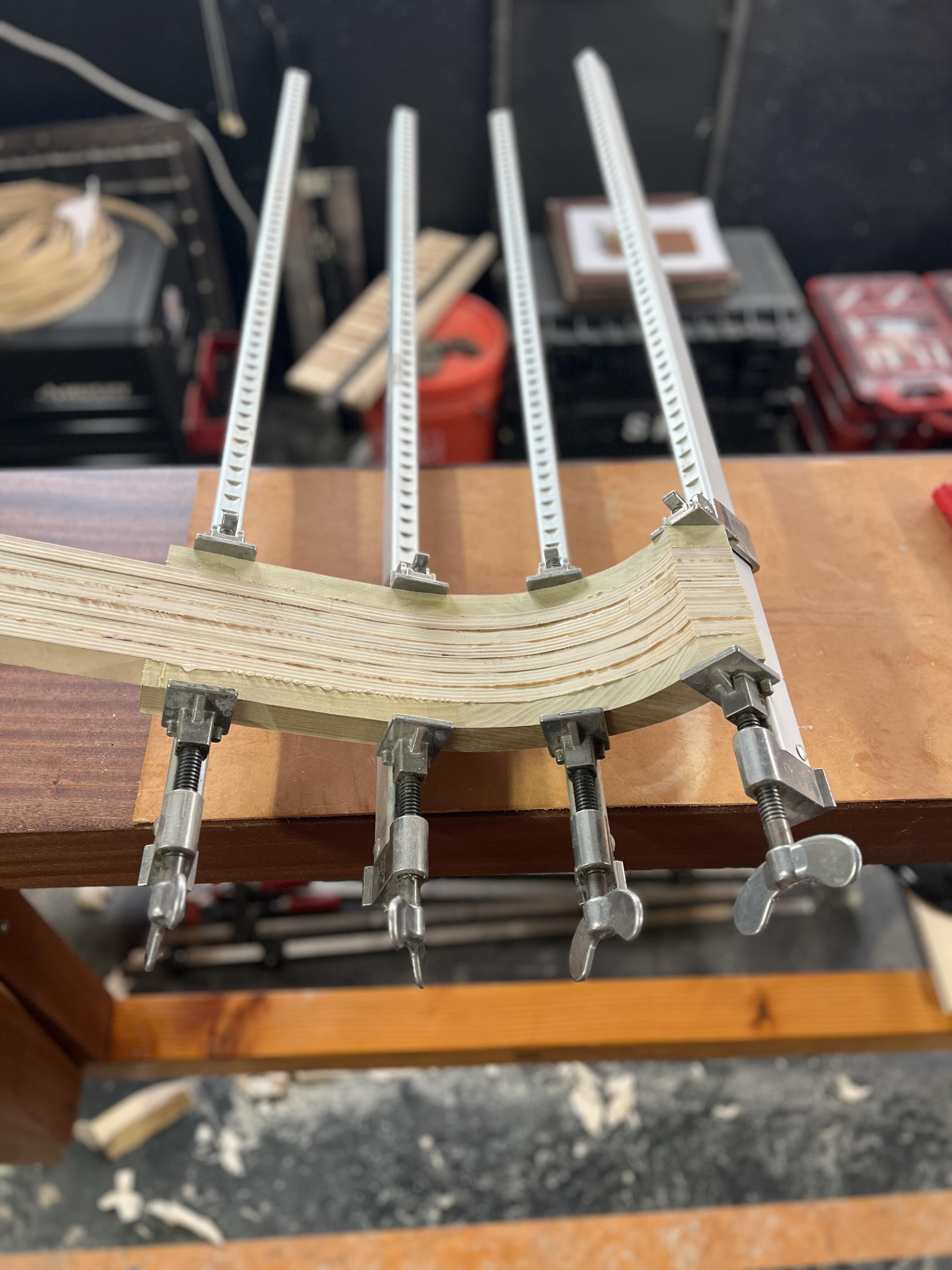

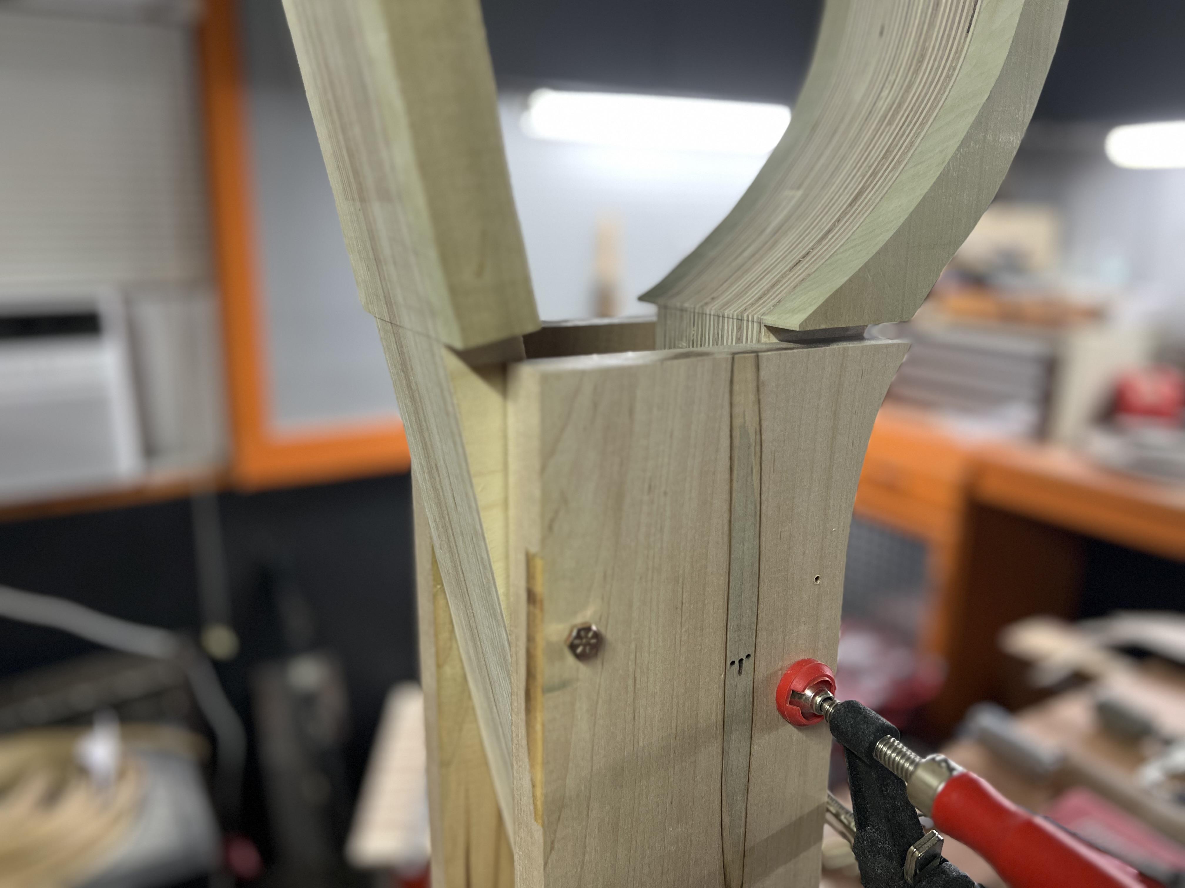

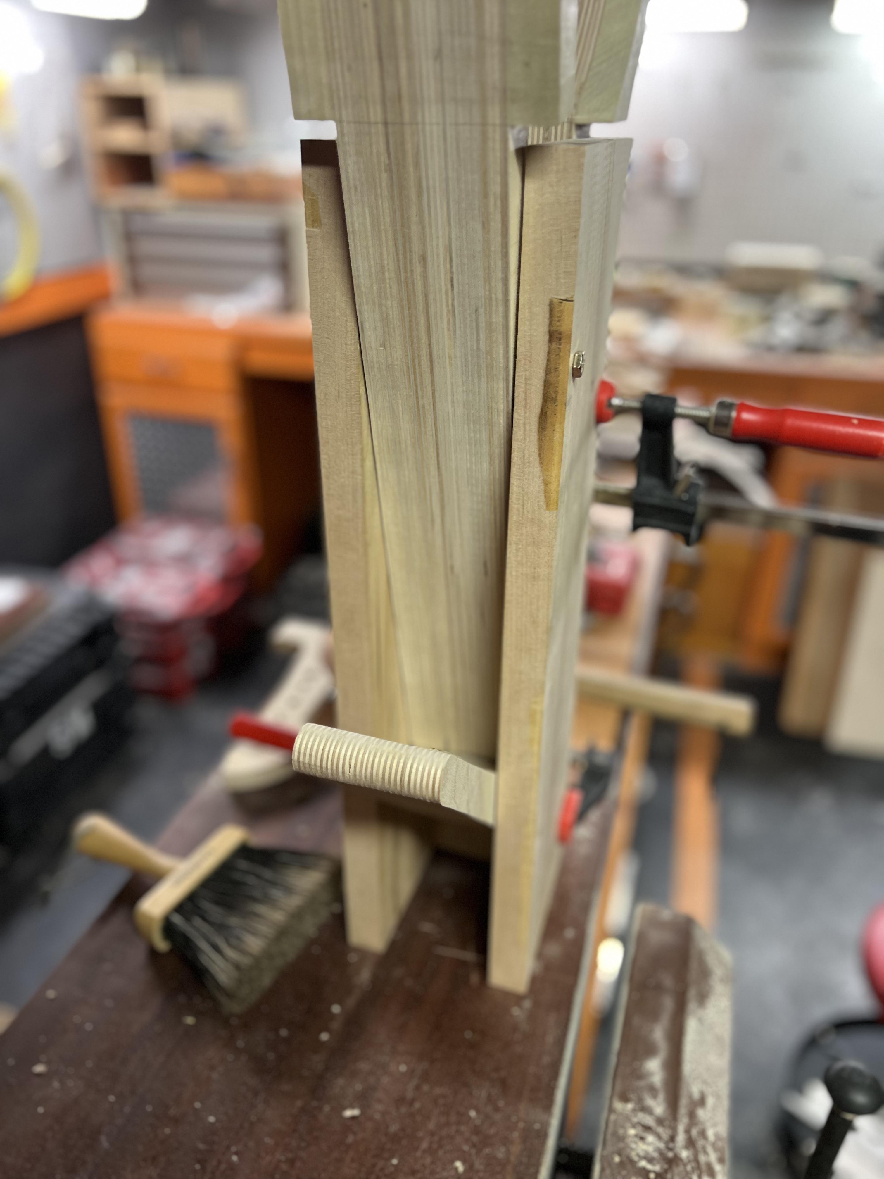

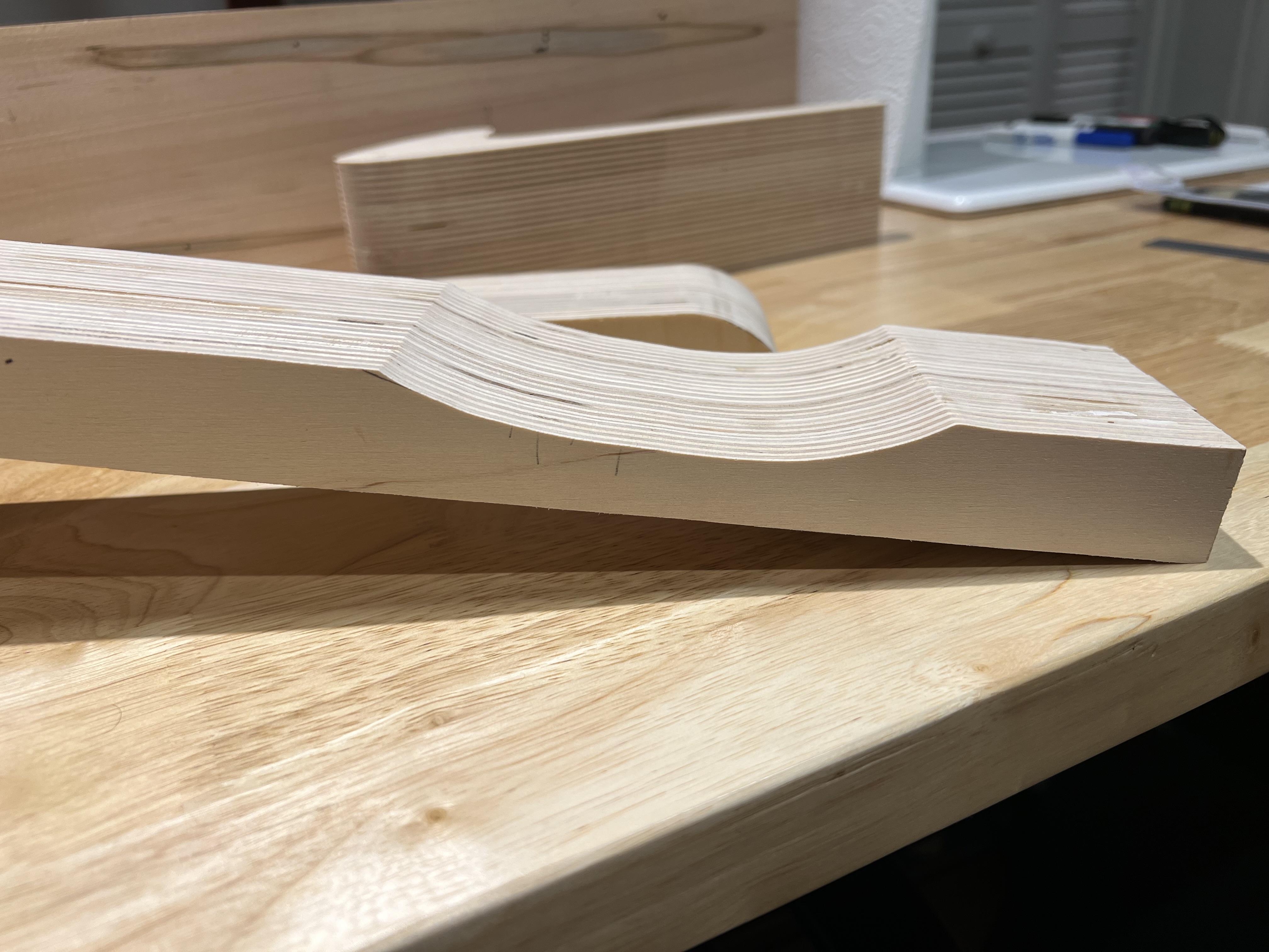

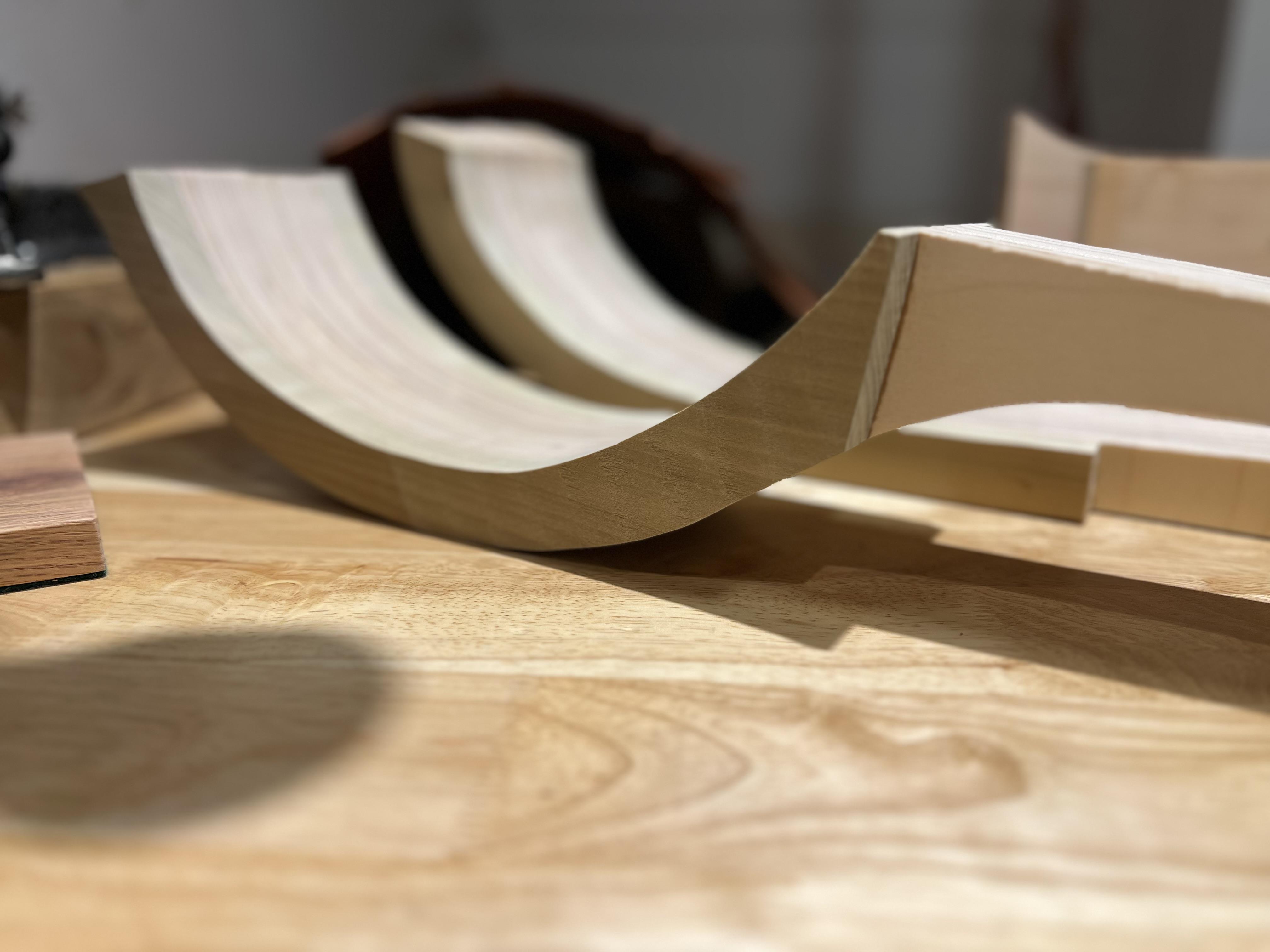

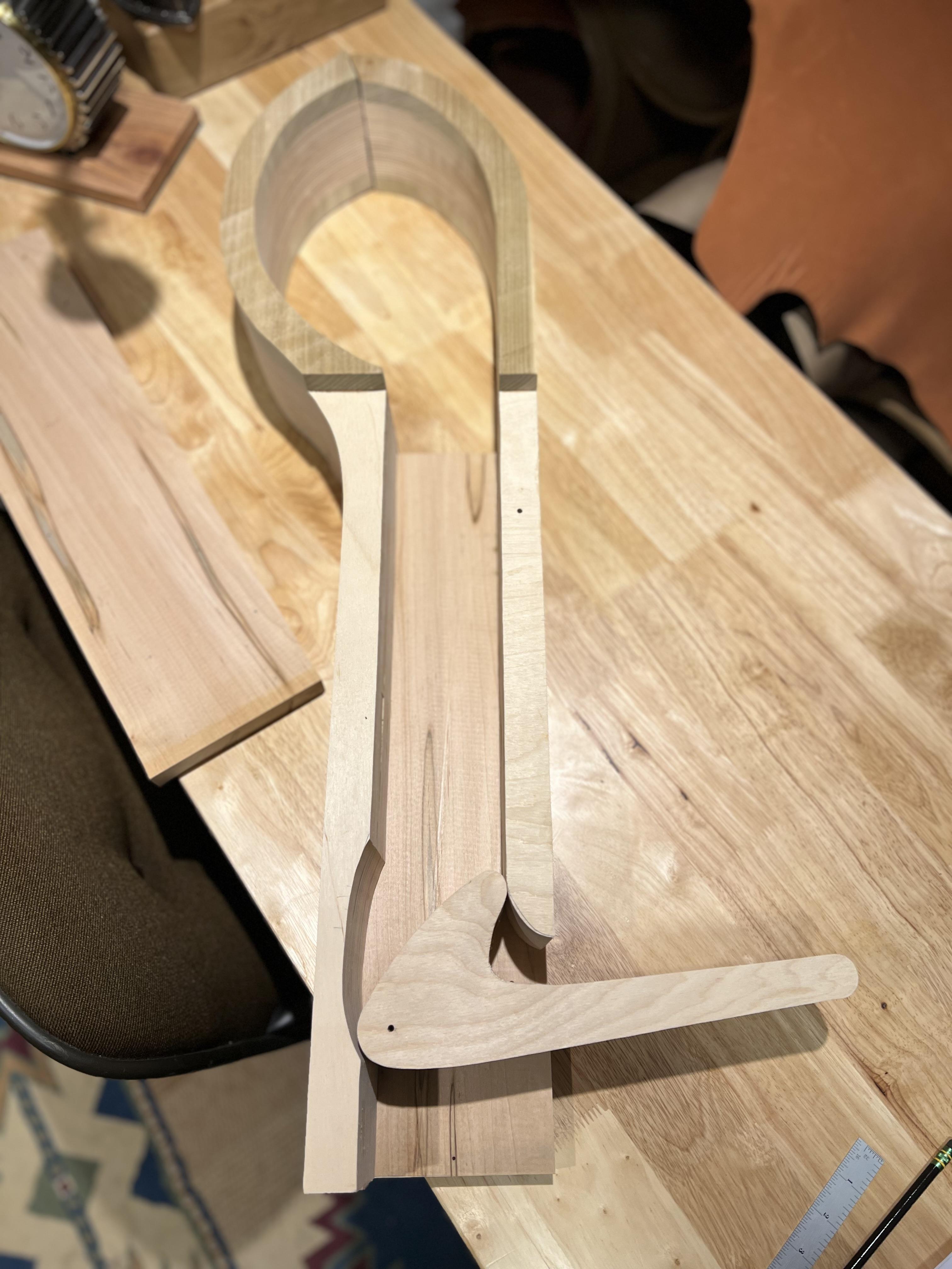

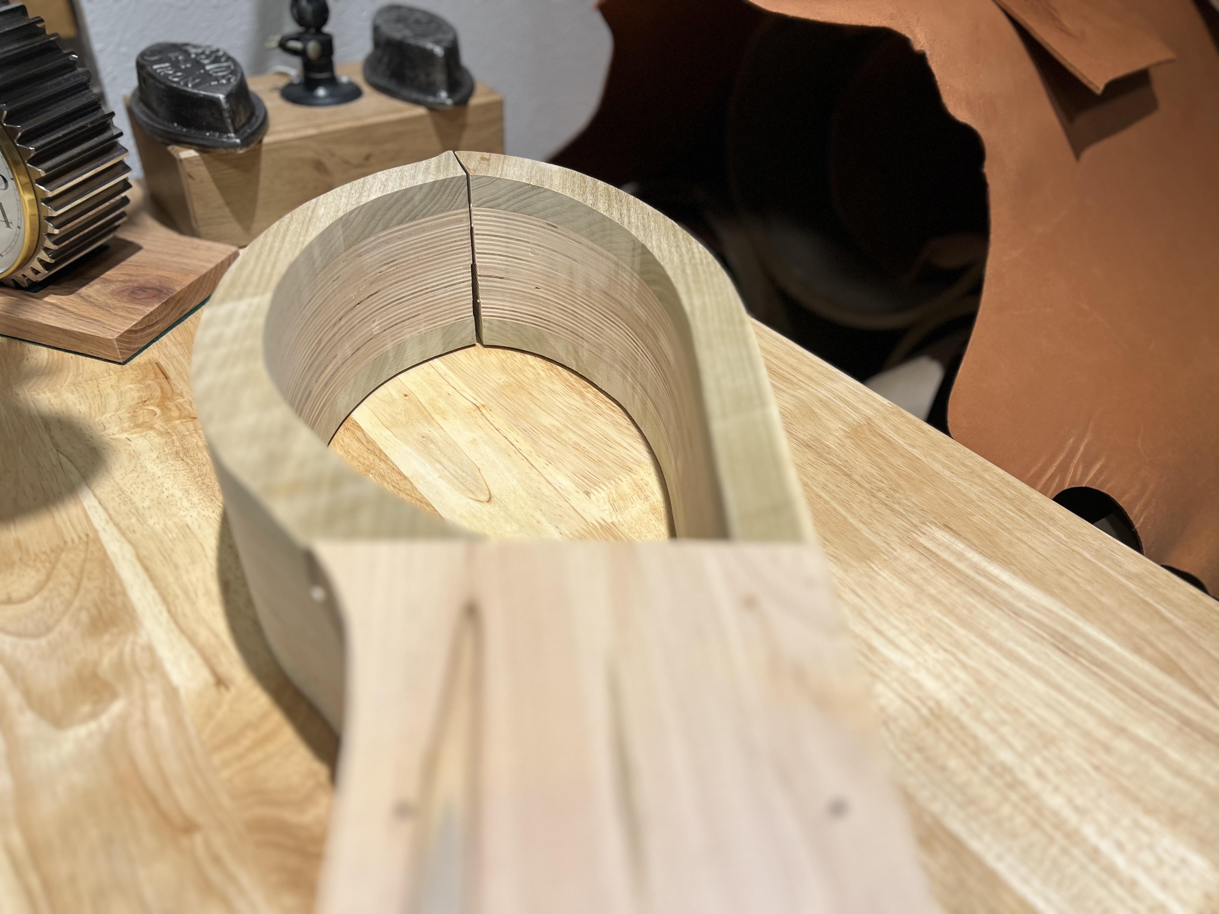

Update #3.

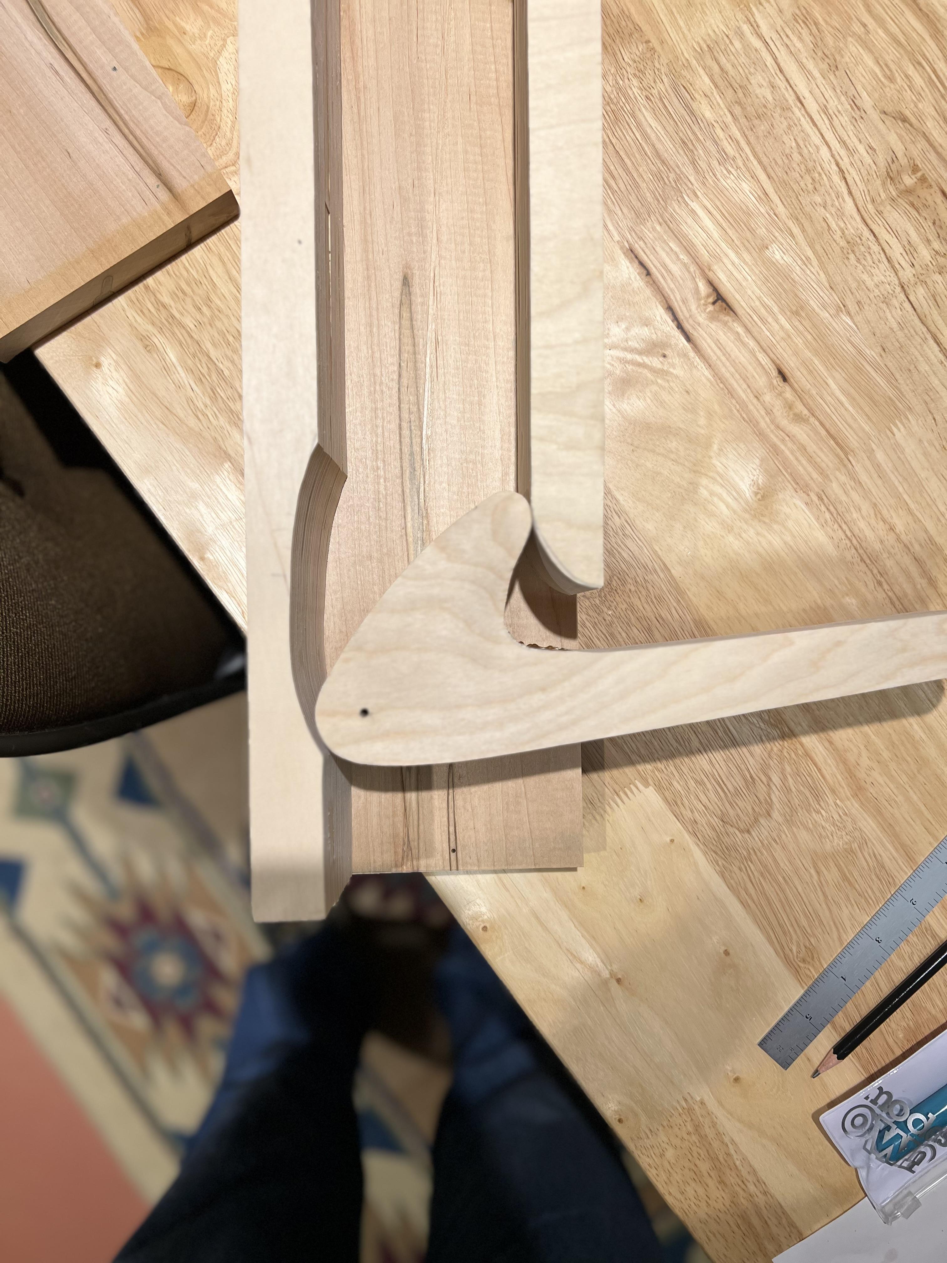

Ive got all the parts that need gluing, glued up at this point. I did readjust the geometry for the trajectory of the swinging arm so that it would nest in the yoke (cam foot lever). This will work much better.
I also took some shots with my hand for reference. I have fairly large hands if that helps.
Next will be trimming, shaping and lots of sanding followed by precise cutting at the bottom of the arms for mounting to a slab of hardwood. And finally, after those parts, the locking device for the foot lever cam yoke.

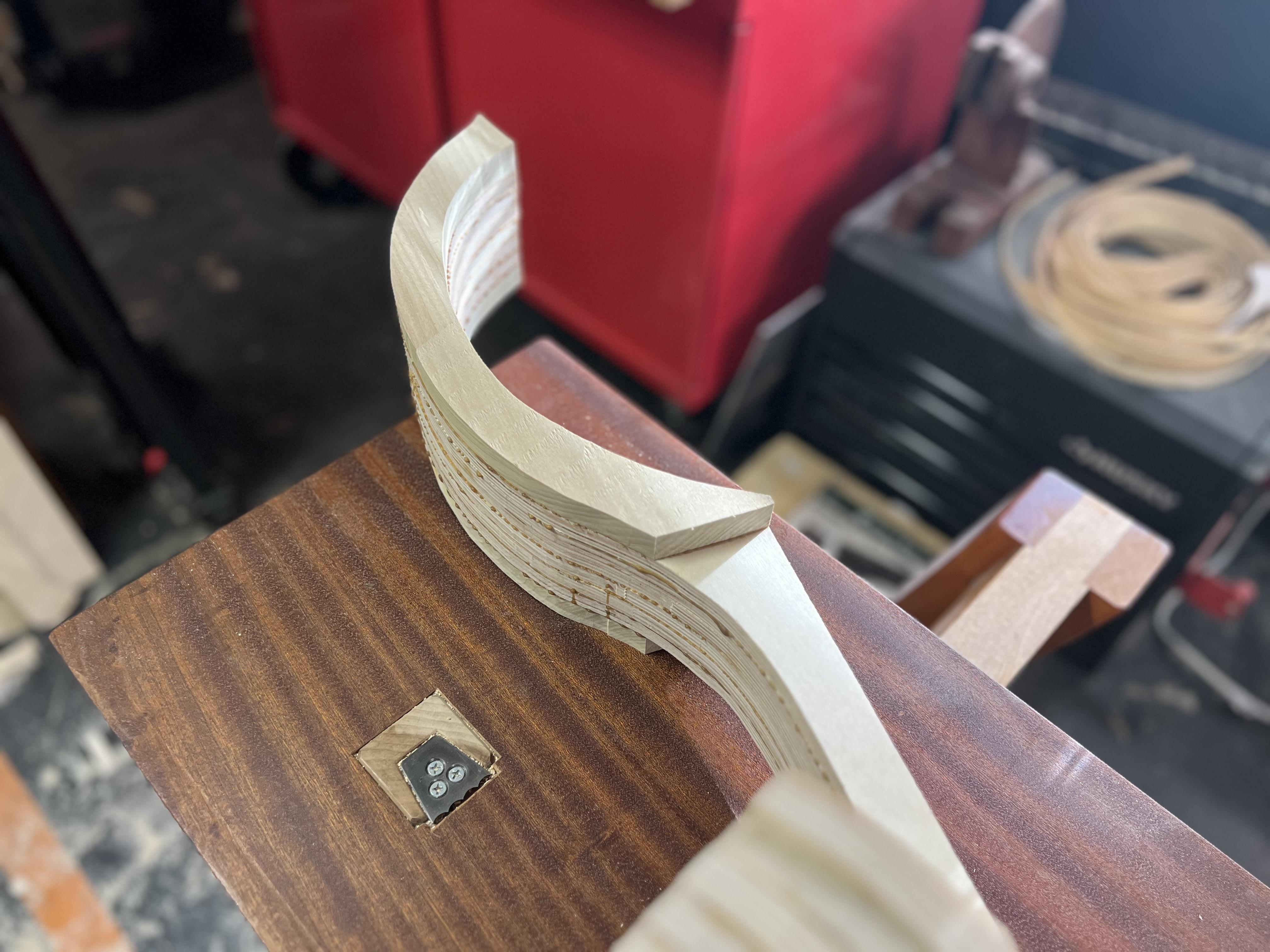

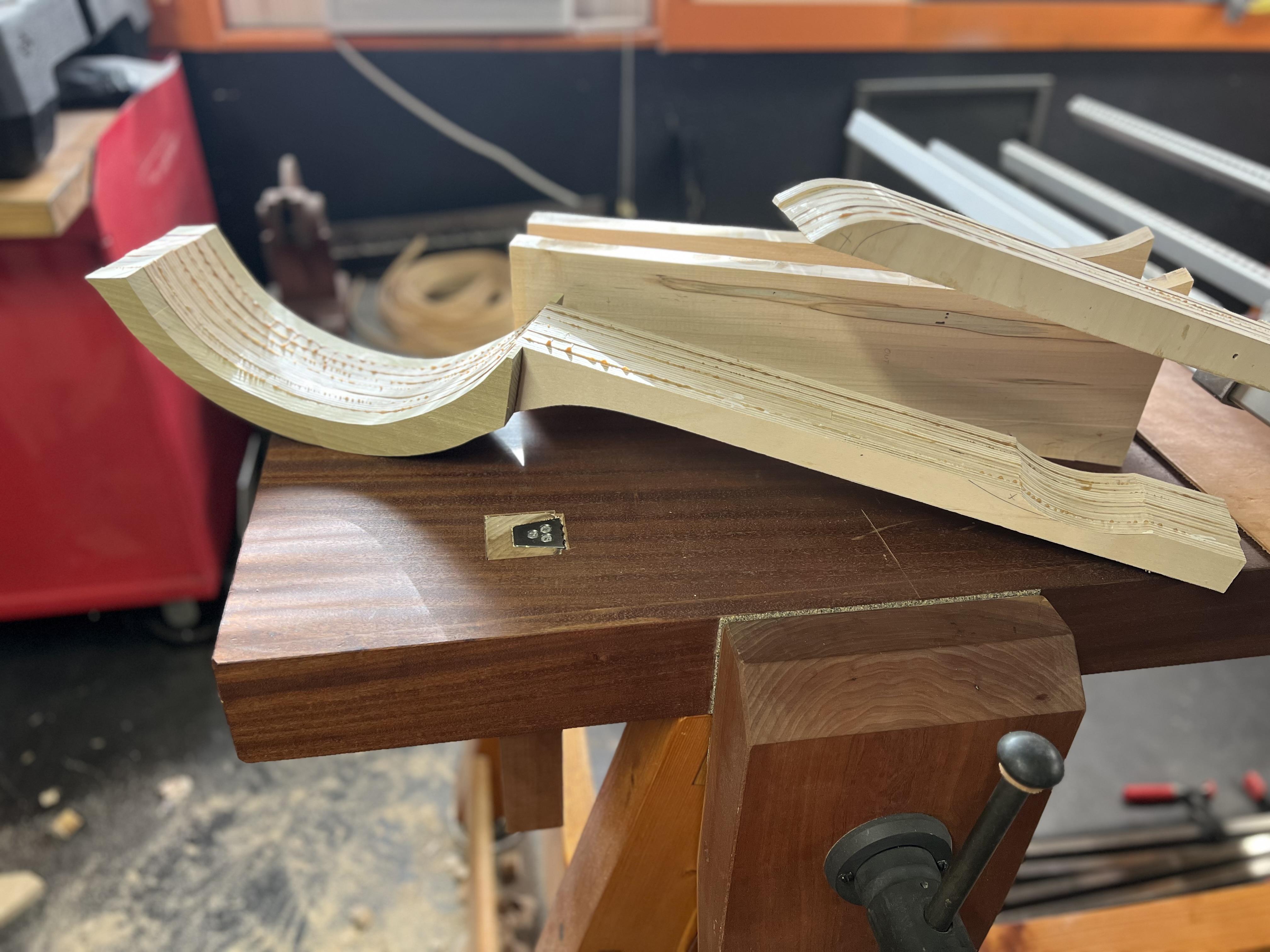

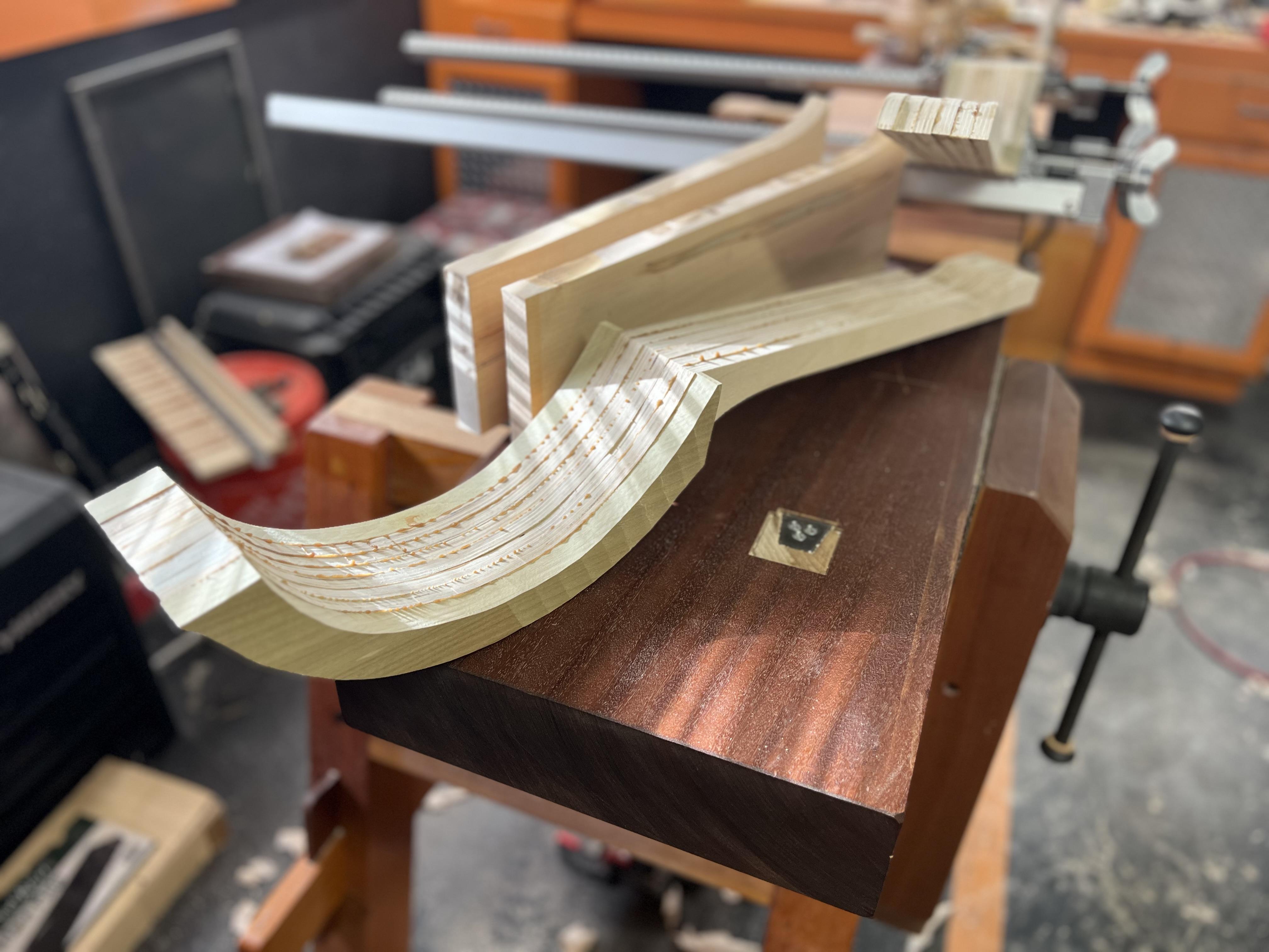

Here is update #4 for today:
All the parts are 90% shaped and sanded. So far so good.

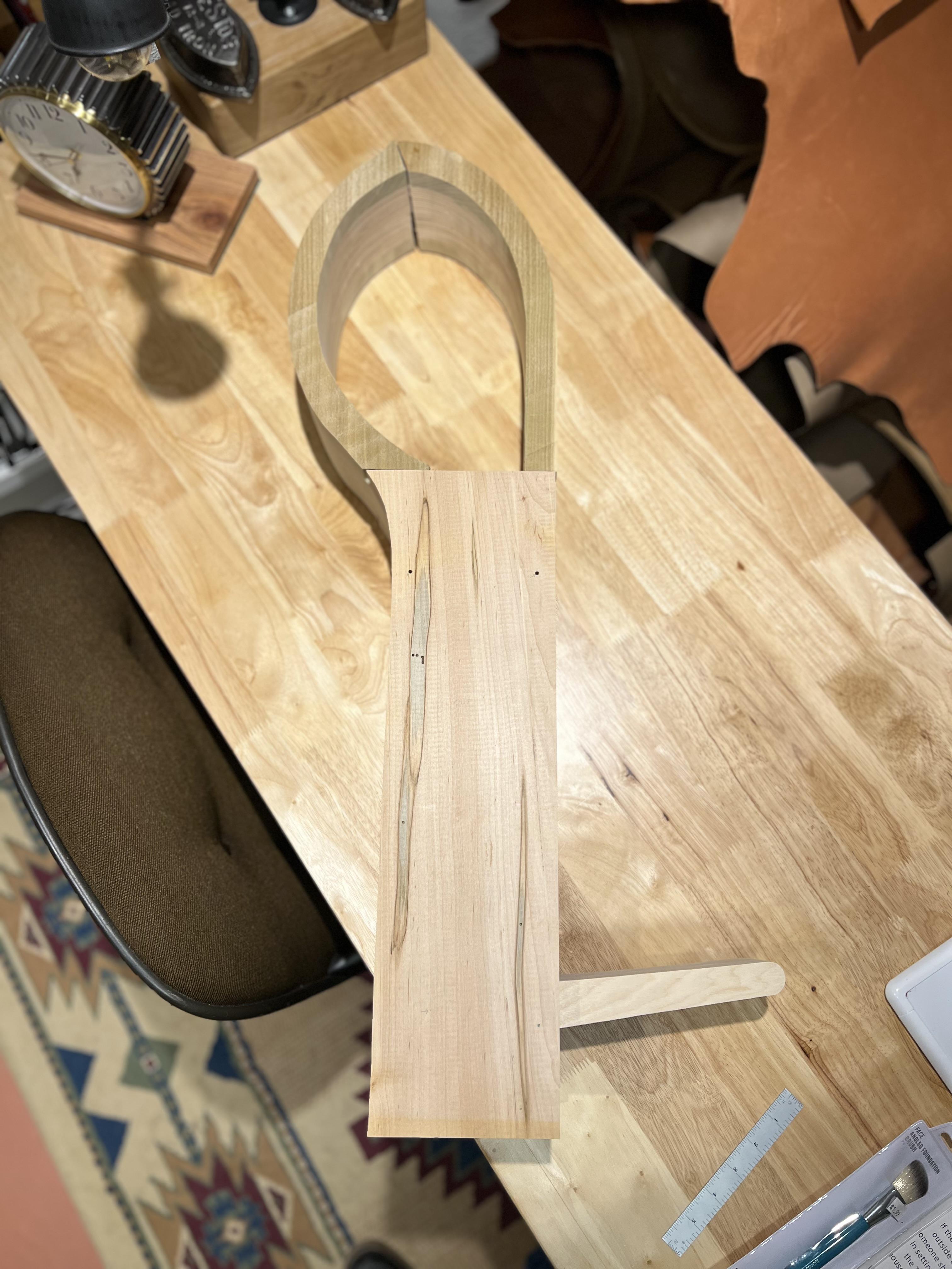

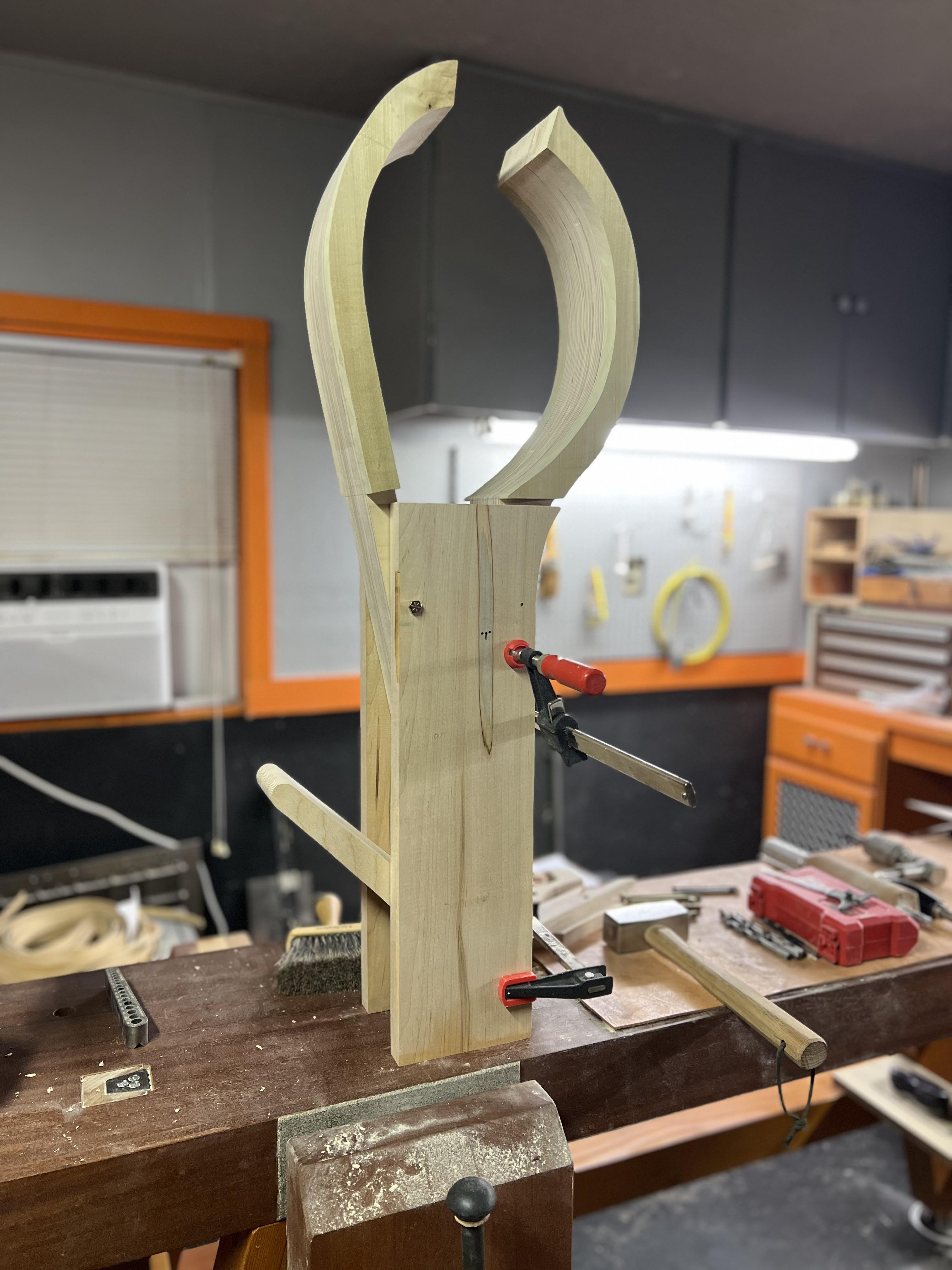

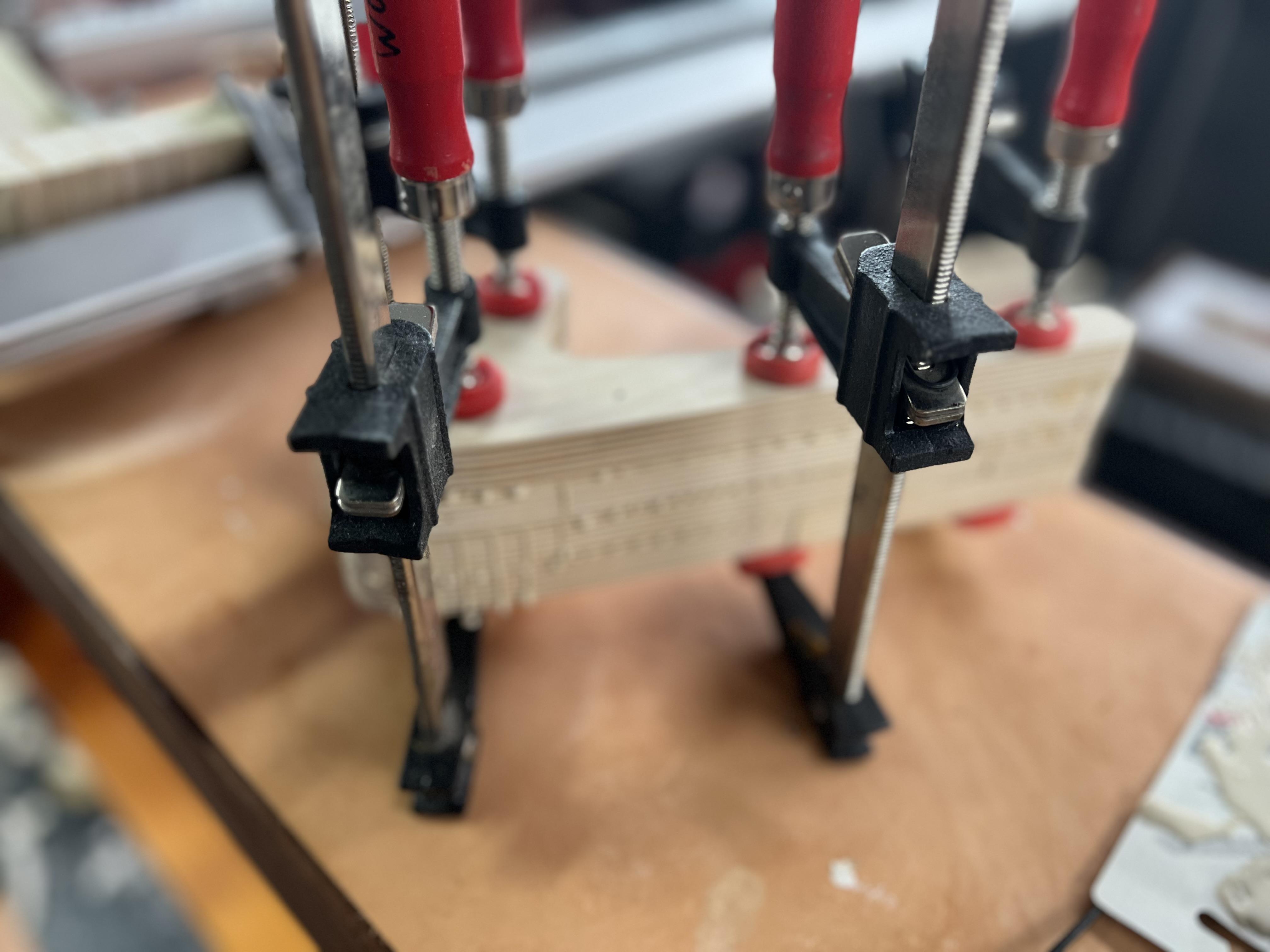

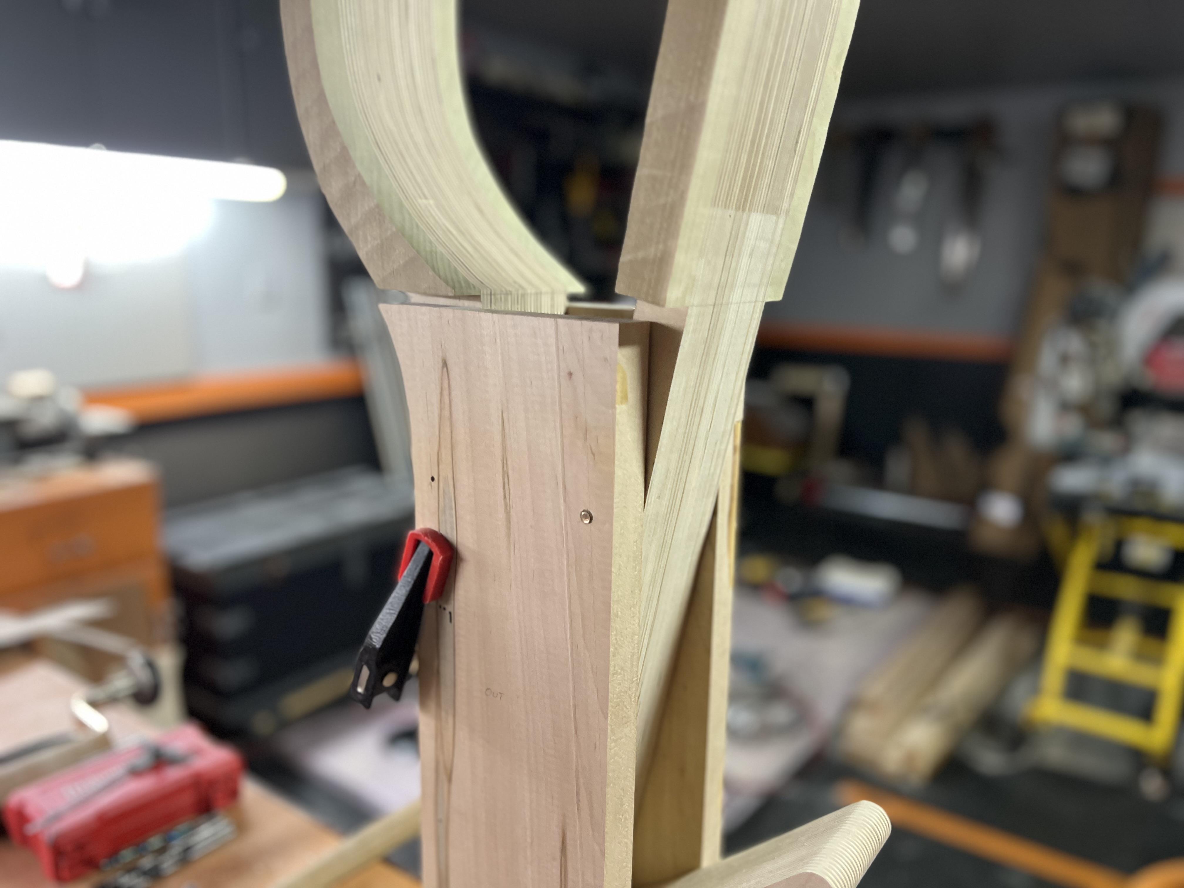

For today’s update, more sanding in the crotch areas of the yoke cam as well as small areas of the arm. I also installed the bushing and got some precision holes drilled. Then i put it temporarily together. I did decided to give it one more layer of wood on the arms. I chose 1/4” plain maple so that it would match the ambrosia maple cover plates and be flush with them. Before the additional maple it was about a quarter shy of the edge of the cover plates.
One thing to note; the use of bronze or beryllium bushings is a must in my opinion for the cam and the moveable arm. No friction points and very very smooth operation. I used 1/4” ID 3/8”s OD and im happy with that. For the bolts i just used some grade 8 smooth shank bolts. The cam is a grade bolt with the threads and head cut off and the ends polished.
The jaws will need work once it is screwed and bolted together. But thats for another time. I did trim them today but thats it. I very well may cut them quite a bit further and use some cocobolo to bolster that area back since i have some.

The only scaled drawings i have are the templates i posted earlier. Everything else has been in the moment, and it mainly boils down to what can i free hand and what can i not.

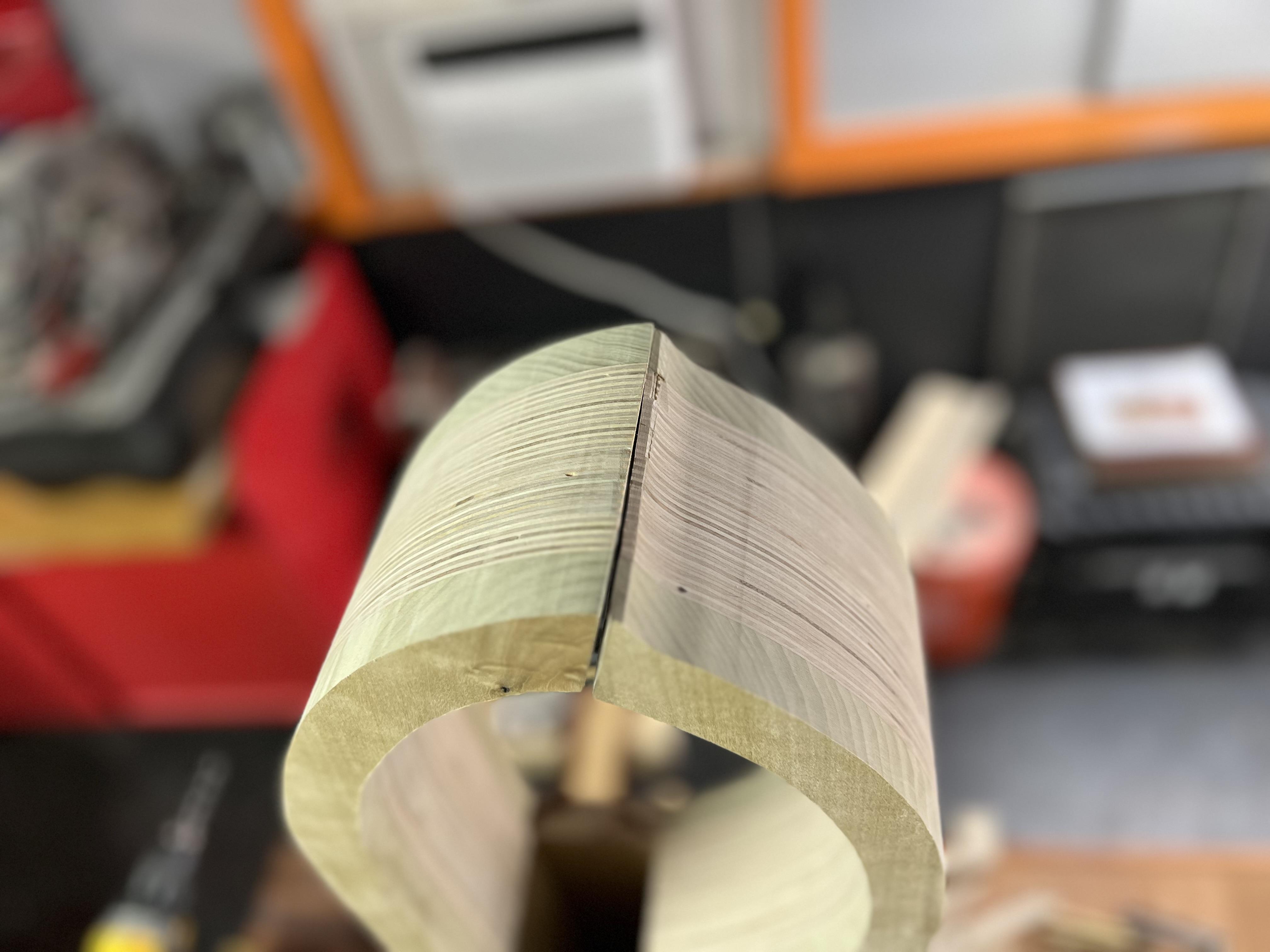

So the do not free hands are the arms, two side panels, the cam, and all of the placement holes minus the screws that go into the fixed arm. There is a fairly high amount of drilling on structure depending on how square all the wood is! For me i didn't square the two side panels, and what i’ve noticed is I’m off about 1/16” or less. I think the reason is because i went off the template and not on structure when drilling and that tends to go bad sometimes. If i had squared the arms to the side panels, and used the template holes as a guideline i wouldn’t be off anywhere. The stationary arm bolt hole is also off by 1/16 to 1/8”. This is causing the jaw misalignment.
Best advice at this stage is SQUARE your parts to each other, but separately first.
Overall, it’s inconsequential and can be alleviated. Mainly talking about the jaws. What ill end up doing is cutting the jaws while closed until i have an imaginary square. Ill then glue in a harder block of wood. Cut right through the center of that, and finally shape the two blocks to match the contours.

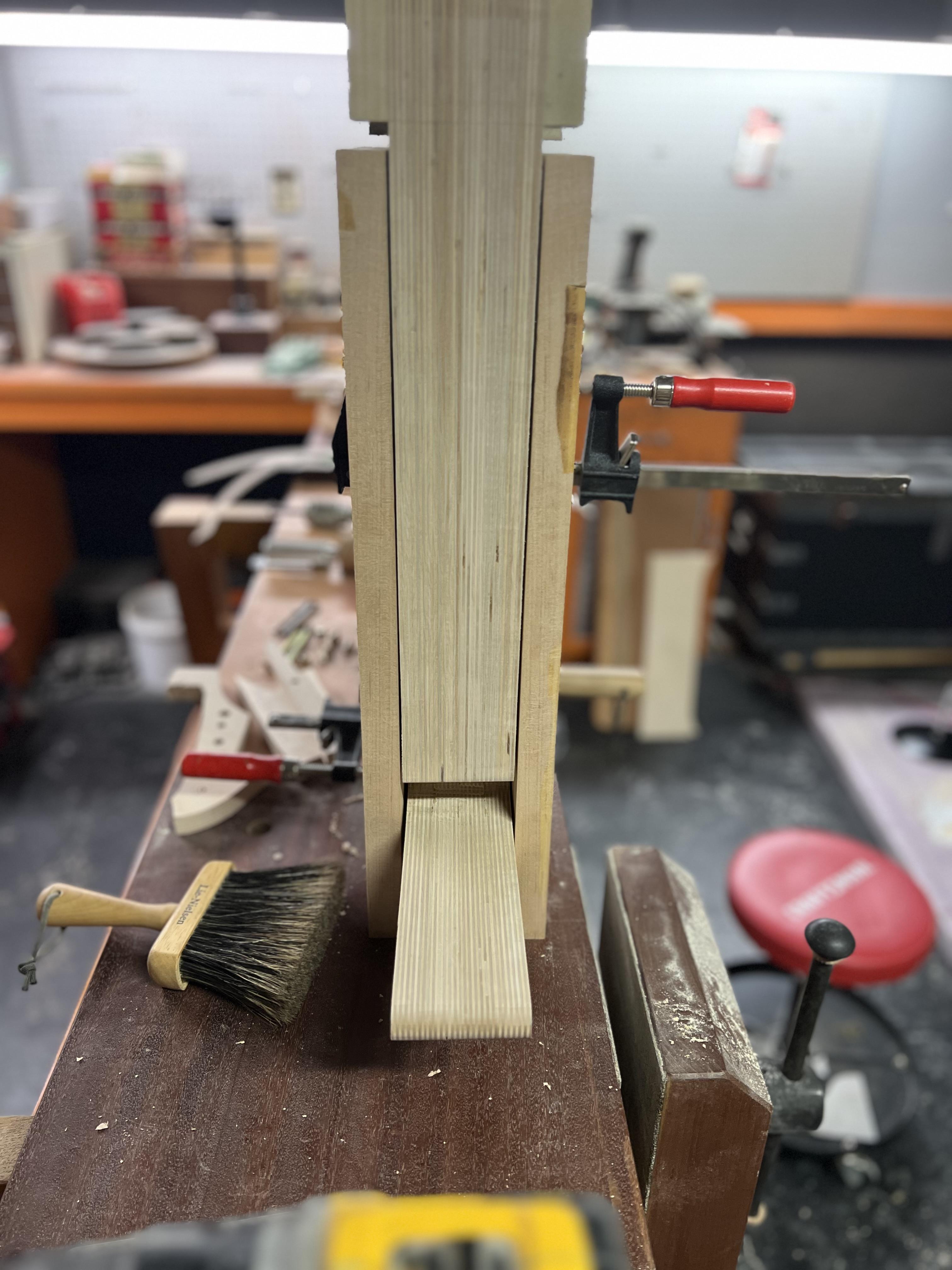

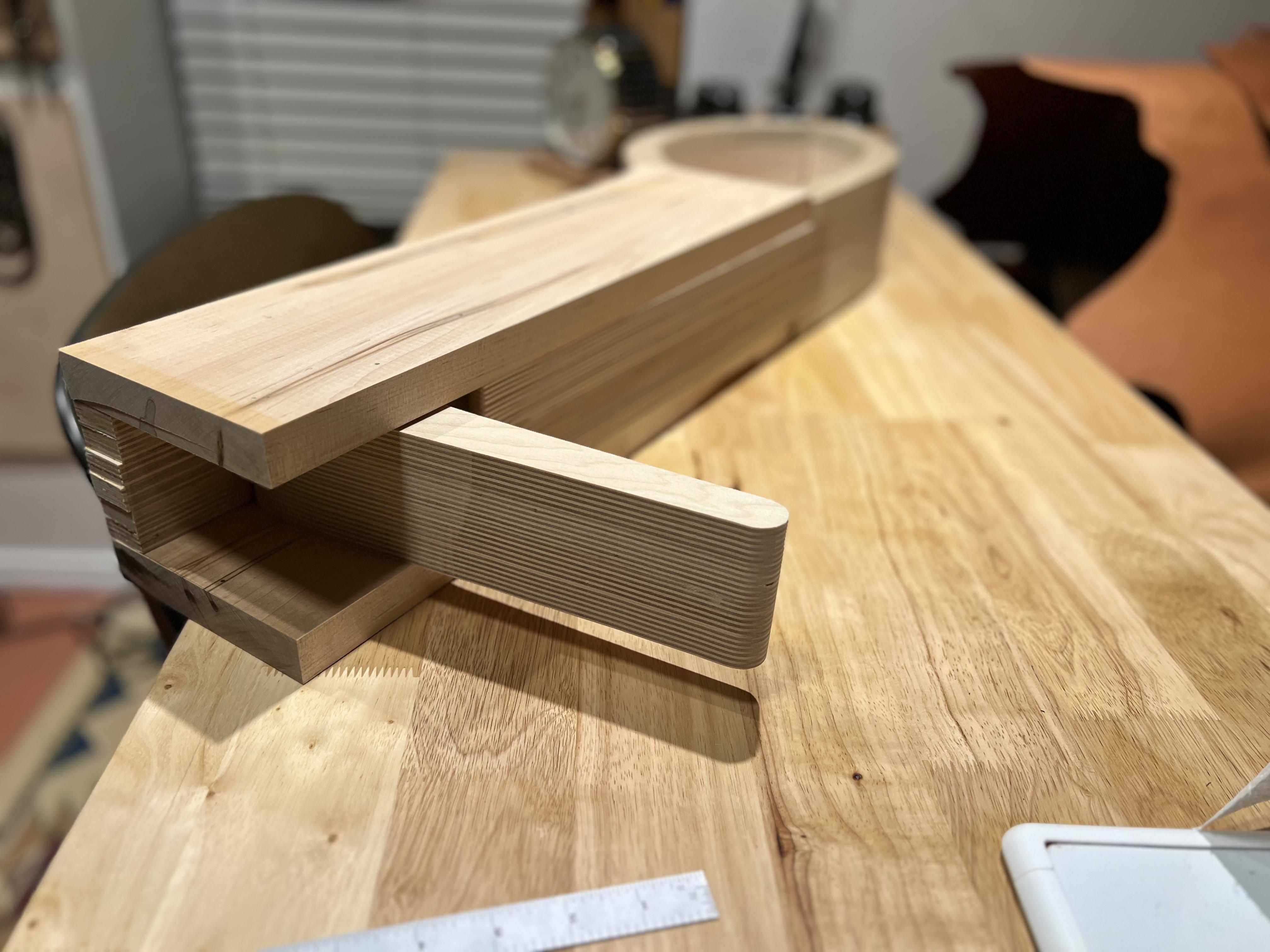

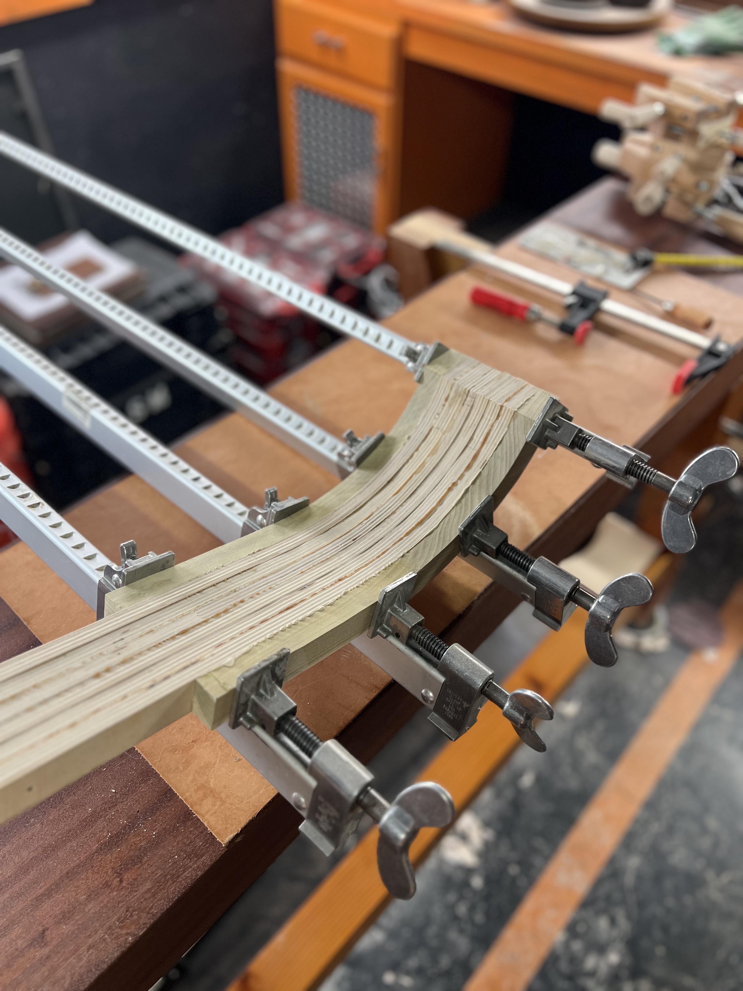

For progress report #6:
I got many of the screw and bolt holes drilled and fixtured. The base is square now, and next will be jaws and getting the dowels installed to hold the upper spring. Spring will be installed after the jaws are fixed. Somewhere in between ill get the base plate squared away and fixed to the body.
You can see that the cam is off as well inside. This is because the movable arm bolt hole is off, and some of that is under shaping on one side. Ill fix that later.
