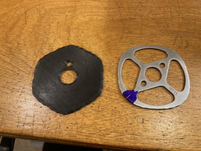

Members Tejas Posted January 8, 2023 Members Report Posted January 8, 2023 (edited) I had a Bernina 217 with a cam reader that I wish I'd kept. The original cams were steel, but I found an after-market for some kind of plastic-like cams that worked quite well . Most of the cams are decorative-stitch cams, but there are two cams you might be interested in -- a three-point two-stitch zig-zag and a four-point three-stitch zig-zag. Both are used for sail making. I'll try to find and post a link to the vender later. I had a few manuals that went with the machine -- Adjustment Manual, Instruction Book, Owner's Book, and Parts Book. I had scanned the books and if you're interested, send me a PM with your email address and I'll send you copies. Edited January 8, 2023 by Tejas Quote

Members sandmanred Posted September 17, 2023 Members Report Posted September 17, 2023 Maybe picking up a dead thread but I too just picked up a Chandler 217 with the cam box but only one cam. I'd really like to find the 3 and or 4 point zig-zag cams if anybody knows of a source? Quote Have Consew 255RB-3, Pfaff 545 H4, Chandler 217, Pfaff 138 and Merrow 60W. Had a Singer 132K6, Singer 78-3 Consew 28, Consew 18, Singer 31-15 and regret selling each and every one of them
Members Tejas Posted September 17, 2023 Members Report Posted September 17, 2023 Global makes what seems to be a Bernina 217 clone with a cam reader. The video in the link below shows the machine sewing multipoint zig-zag stitches. https://globalsew.com/product/zz-217-series/ Here is a link to the zz-217 Service Manual that shows a picture of one of the cams, that might be compatible. Perhaps you might try contacting Glogalsew. https://globalsew.com/wp-content/uploads/2017/01/service-manual-Global-217.pdf Quote
