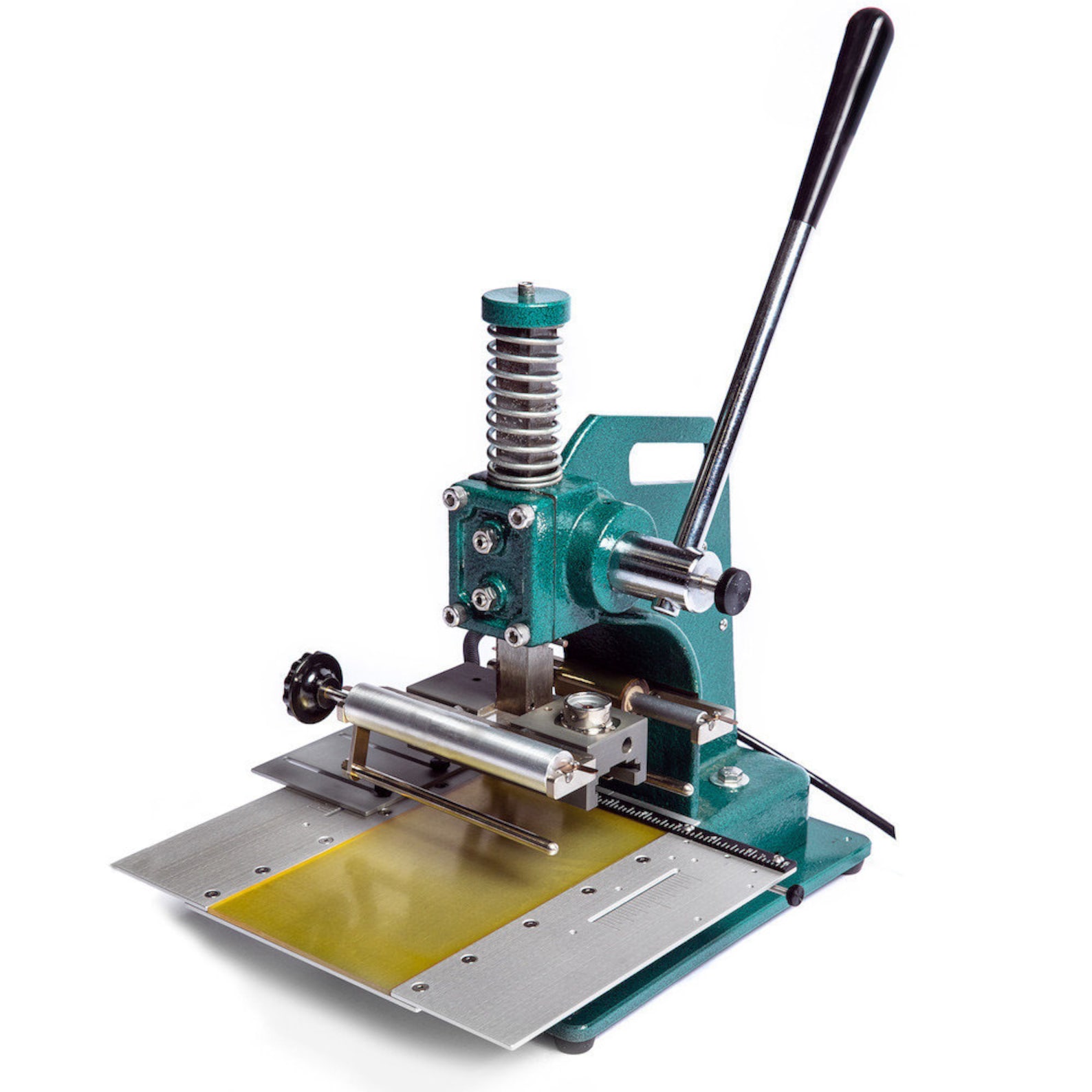

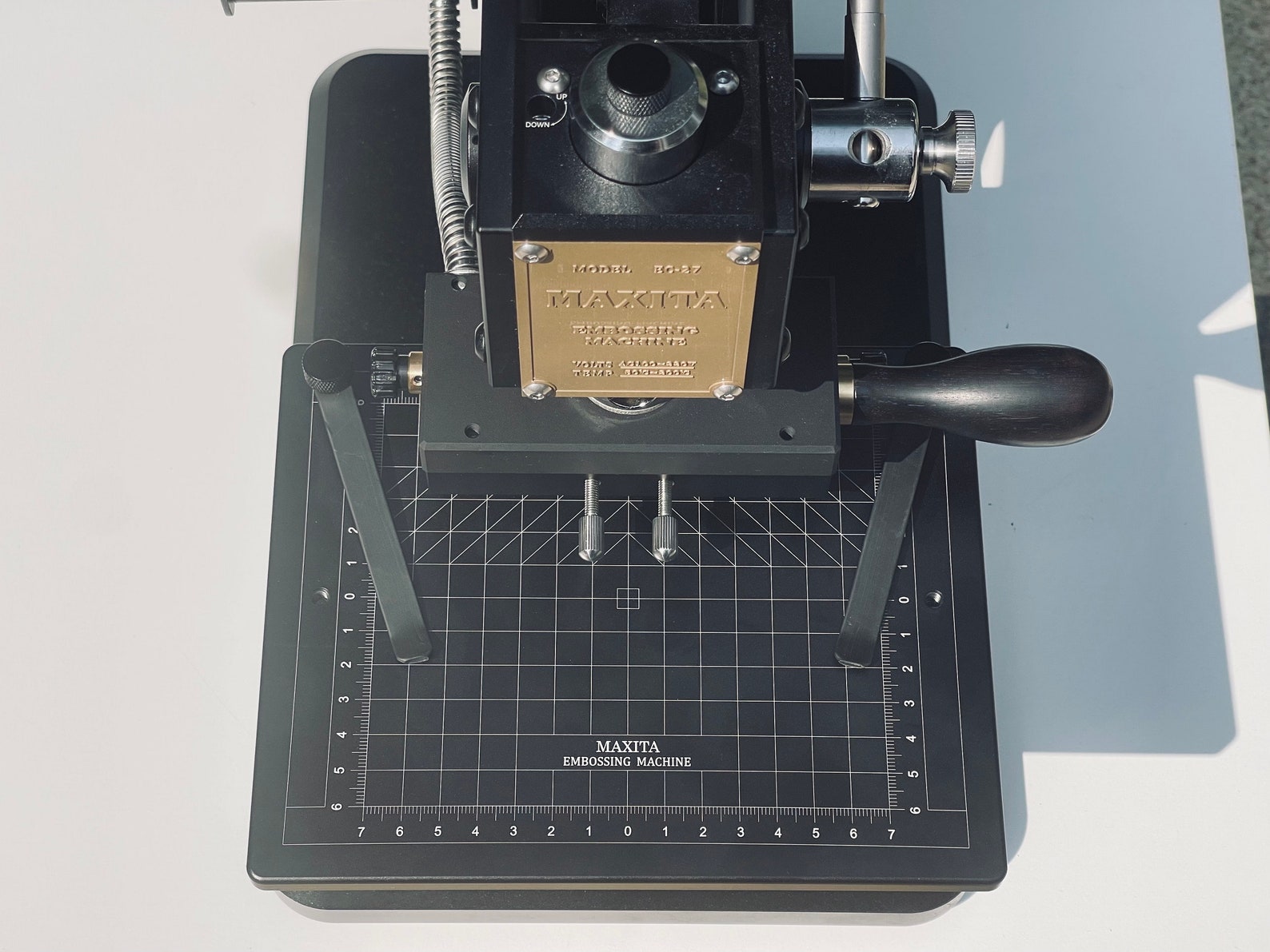

hey guys I have a cheap foil stamping machine and I'm trying to figure out a way to line up my straps to get them centered. I'm doing a diamond shape too so it makes it tricky not getting it crooked..
anyone have any tools or adjustable fences I could add

this machine has a cool looking guide Etsy
I like that this has the clips to hold the work and the whole base slides in and out, expensive machine tho Etsy

the cheap Chinese ones do have some leveling in the stamp area itself with the 4 bolts, kinda annoying but doable. mine does not have the springs as advertised here, I wonder if that works to self level the stamp as they are claiming it to work? I have to use quite a bit of force so I feel like I would end up just bottoming out the springs..
