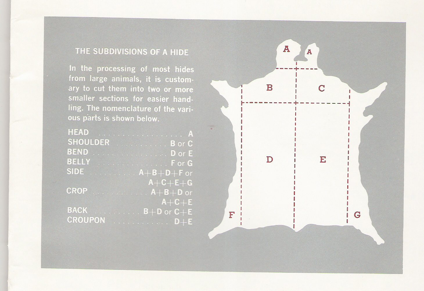

Moderator Johanna Posted January 25, 2007 Moderator Report Posted January 25, 2007 No two hides are the same. You can take sister cows, send their hides to the same tannery, and the two hides will have differences. No hide is the same thickness throughout, either. That's why leather "weight" is often expressed in ranges, i.e. 8/9 oz. or 4/5 oz. The center of the whole hide is where the animal's spine was. The area by the rump is thicker than the shoulders. Hides are often sold as sides. If you cut straps, this is the most economical way to purchase leather. Double shoulders might be long enough for belts, or not, depending on the animal, but they are the "cleanest" looking parts of the hide. If you plan to carve the leather, you can save money buy buying leather with imperfections that you can work around, or cover up with tooling. Belly areas are soft and mushy compared to the shoulders and may not be suitable for a function that will place the leather under stress. To keep this conversation straight, here is a chart: A, F & G are good for small projects, practice pieces, etc. A,B,D &F is a "side" B & C is a "double shoulder" B & D is where you would get your straps from I borrowed this from George Hurst's Hidecrafter Catalog because I'm too tired to type it out right now. When buying leather, consider what you plan to do with it. Every time a hide is cut, the price per square foot increases. If you can use the whole side, it's less expensive in the long run (because there is no such thing as "scrap"!) Buy from a vendor you have a rapport with- if the seller knows what you are doing, he can select a hide best suited for your needs. I would save a long side for a person who plans to make straps (belts) and I would save a pretty double shoulder for someone I know wants a piece with no blemishes, for example. Tandy catalogs used to refer to the "occasional range markings that add authenticity to your project" which is a nice way of saying, "Hey, this cow tangled in barbed wire or got caught on a roller at the tannery" but in truth brands and some markings can be interesting. Just make sure that any flaw in the leather is not expected to bear weight or be subject to stress. Any time you punch a hole in leather (even for sewing) you weaken it, too, so the smallest holes you can use are desireable. Often you will see purse straps sewn on in a triangular pattern- this is a way to distribute the "load" evenly and not rip out the stitches. Some people make the mistake of punching holes to close to the edge- after practice, you can eyeball it, but keep in account how much force will be exerted on those holes, and does the leather toward the edge have enough room to not be weak? I hope I answered some of your questions, Regis, didn't mean to get off track. Johanna Quote
