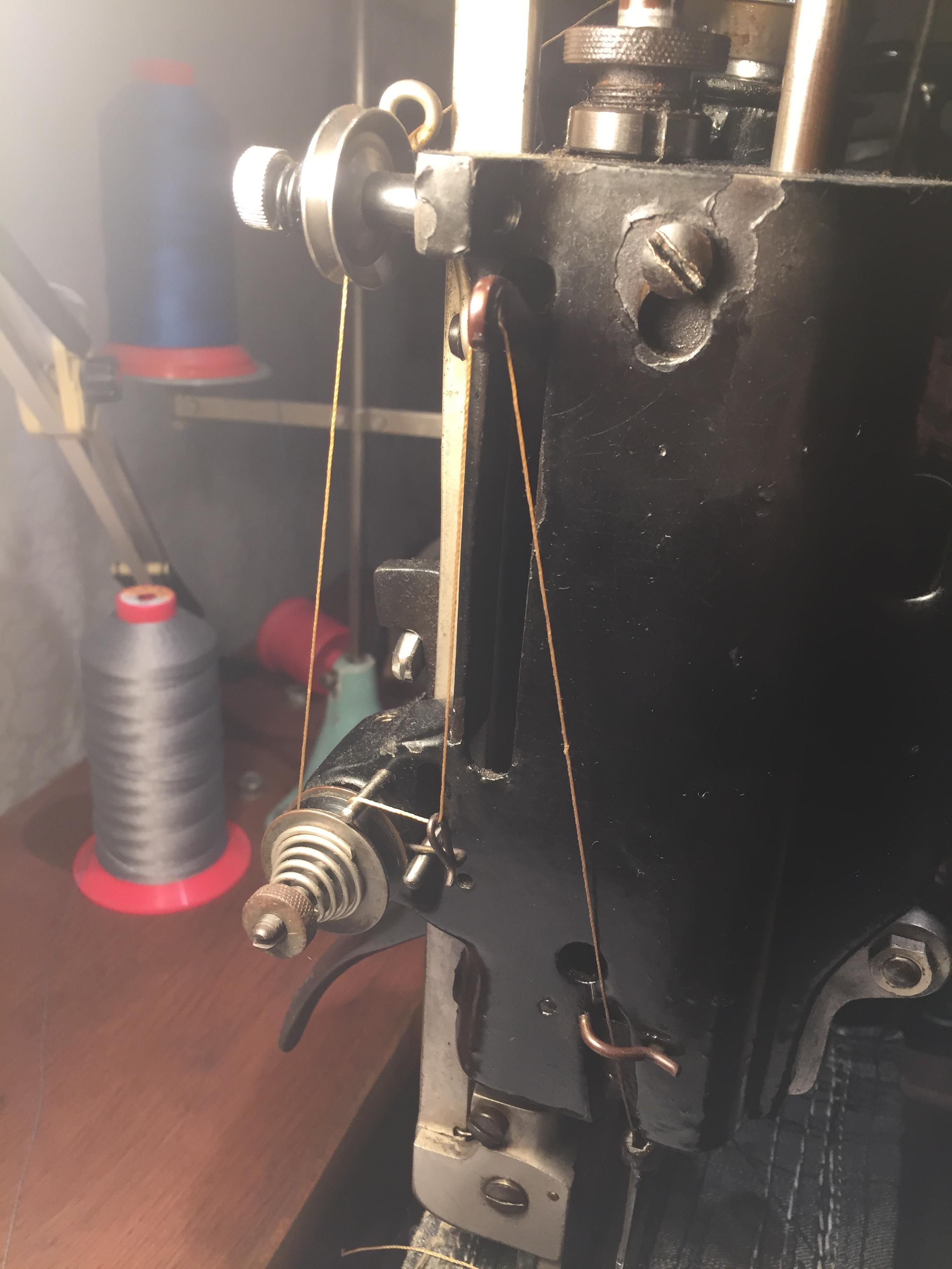

Members Constabulary Posted 14 hours ago Members Report Posted 14 hours ago (edited) is the tension screw on the hook tension spring all the way in already (it should not)? Maybe the small tab that goes into the hook body on the lower end of the tension spring is broken off (Pic 1). The shown Adler hook is the same as the Singer and I´m using it in my Singer 45D. Edited 14 hours ago by Constabulary Quote

Members Constabulary Posted 7 hours ago Members Report Posted 7 hours ago (edited) I have edited the pic a bit... ah... well... I´m not sure but is your bottom thread going trough the needle eye??? That would surprise me... But could just be the angle 🤔 Edited 7 hours ago by Constabulary Quote

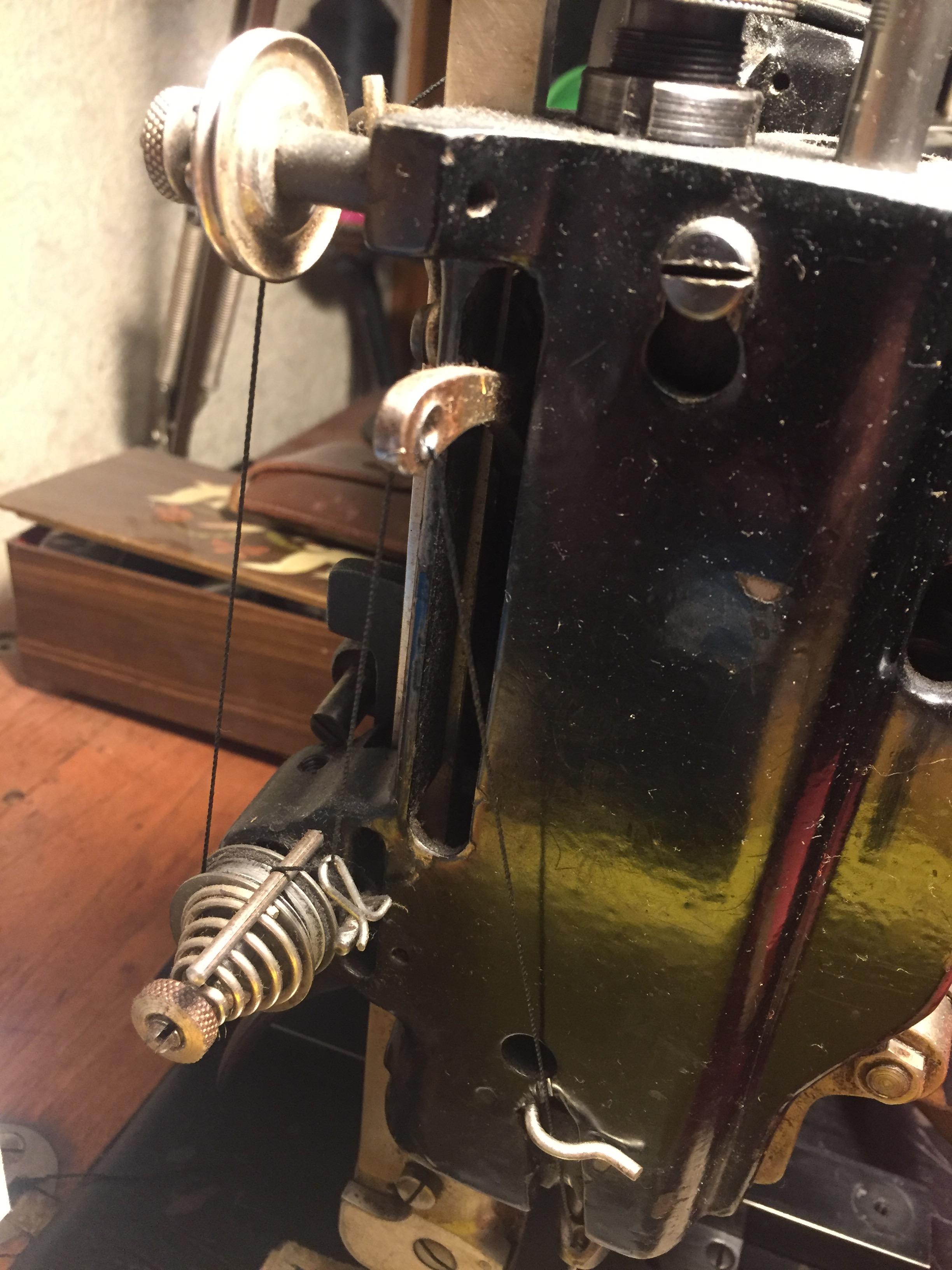

Members Bosko90 Posted 7 hours ago Author Members Report Posted 7 hours ago Hmm through the eye? No, but it would be possible for the needle to go through the thread. I have a friend who has an Adler 4-2, at the first opportunity, we will try it with his shuttlehook. ok was uploaded to yt. And here are some photos. In the photo you can see the moment when the lower thread becomes very tight and the thread is pulled out of the bobbin. This is the moment when the needle is in the completely lower position. At that time, the upper thread is completely relaxed and does not affect the lower one. In the second photo, the appearance of the upper thread at the same moment. In the last picture we see how a slight loop is made on the lower thread. This is at the moment when the upper thread starts to pull upwards. It pulls until it uses up this excess thread. And this is at the moment when it already looks out of the 2mm leather. This way, the lower thread offers absolutely no resistance to pulling, no matter how tight the tension screw is. And as I mentioned before, if I lightly press this loop against the bobbin case with my finger to hold it in place, it makes a nice stitch. Quote
Members Constabulary Posted 7 hours ago Members Report Posted 7 hours ago (edited) I at least can see that here is a thread guide missing. Have you cheeked the needle hook timing especially the needle bar height? Edited 7 hours ago by Constabulary Quote
Members Bosko90 Posted 7 hours ago Author Members Report Posted 7 hours ago Ok, that's what's missing. But I don't think there should be any problems with that, or? I didn't check the timing specifically because it's grab thread, and I don't even know the exact position for this machine, what it should be. There is one thing that is still wrong and I can't fix it, that's the only thing I suspect could be wrong. The hook goes too close to the needle and it slides on it. I recently got about 40 needles, all of which are worn down to the point where they have a bit of a flat surface on the side. The needle I'm trying with is new. I tried to move the entire lower system, but it was unsuccessful, probably the corrosion was too strong. Quote
