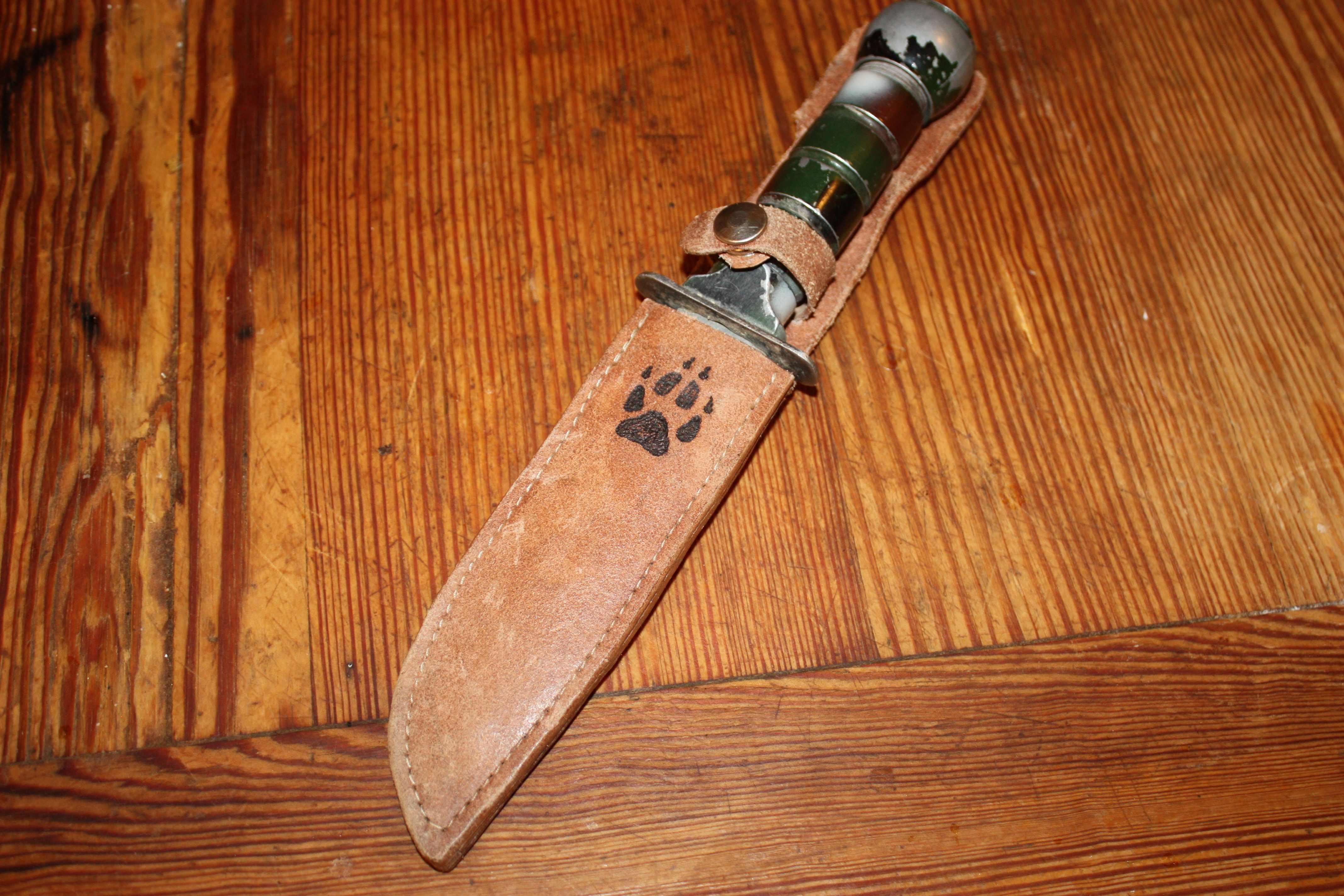

Thrift stores are your friend! Check out old leather goods, leather clothing, and boots, and such. Also, scraps and cut-offs make good tooling and sewing practices. This sheath was a scrap that i practiced tooling on then I reversed it and made a roughout sheath for an old beater and practiced my sewing on it also. I have a cheapo china patcher so a lot of scrap was burned in the process of setting up and practicing lol.
