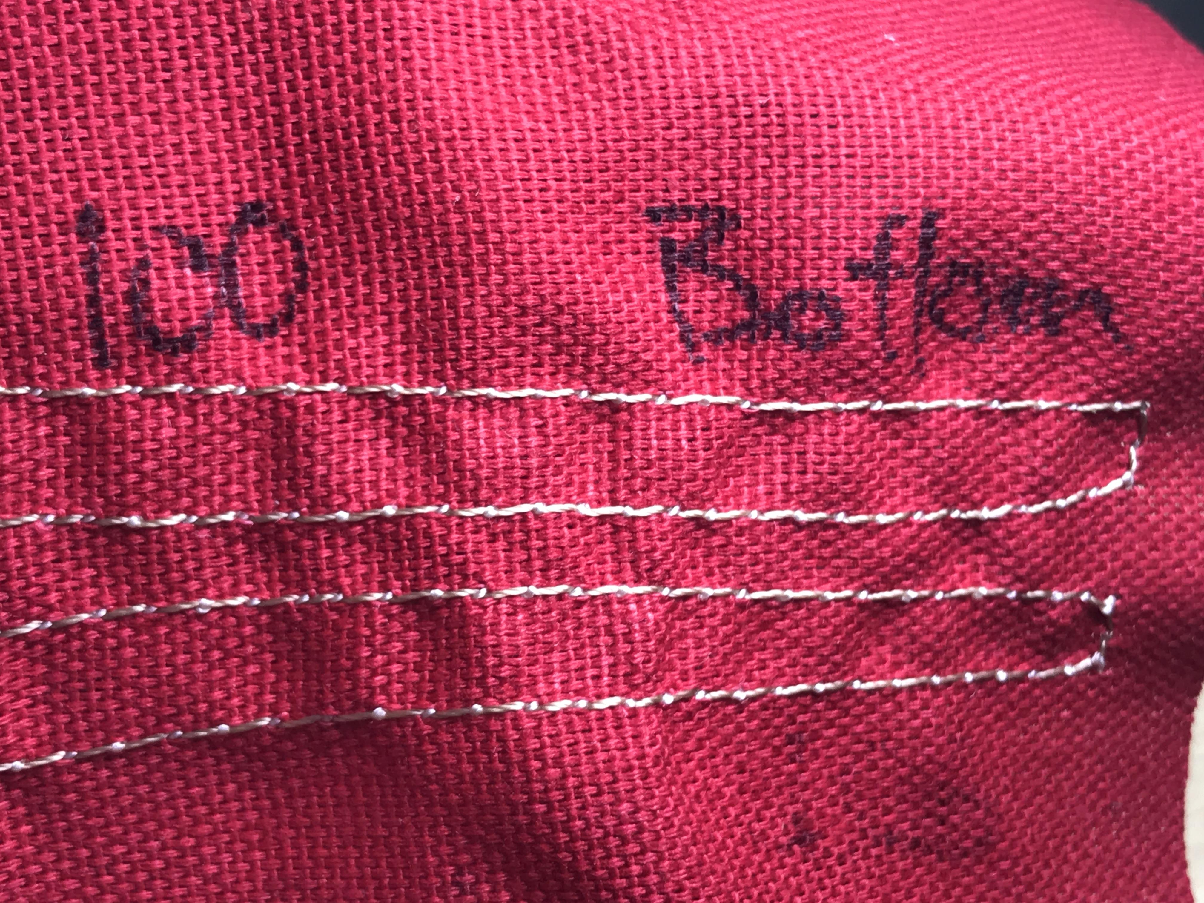

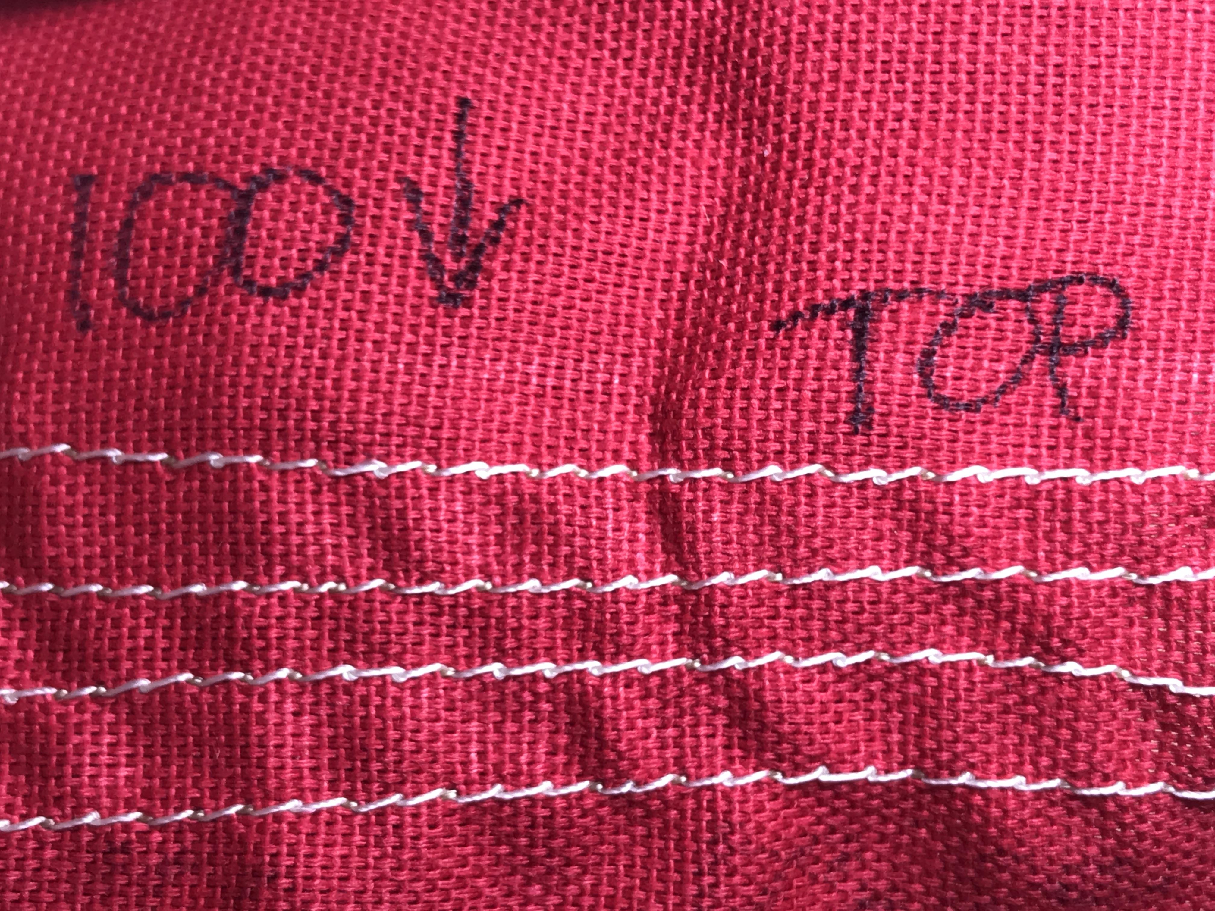

The past week i notice my top thread is sometimes curling around the bottom thread. A few curly Q's along the seam. It seems most noticeable with thin materials.
I'd like these stitches to be straight. (The bottom side actually looks better, which is rare for me.)
Ive tried changing the bobbin tension and the top tension.
I've tried adjusting the thread take-up spring.
Needle is size 125 (Singer 20). Machine is pfaff 545 H4
Fabric in photo is a single layer of thin canvas-looking stuff (0.4mm thick).
Thread in photo is TEX 70 polyester UNbonded but I get the same effect when using TEX 90 polyester bonded.
First photo is top side
Second photo is bottom side

Top tension is to high.
Look at the first pic - you can see the bottom thread pulled right through the fabric onto the top side. - thus producing the "curly Q"
Either back off your top tension or increase bobbin tension.
This is going to take some time by trial and error - you just have to fiddle until both of the threads knot in the middle of the fabric.
But that is a normal common procedure - that most all of us are confronted with when changing thread size or switching to a different material to be sewn.

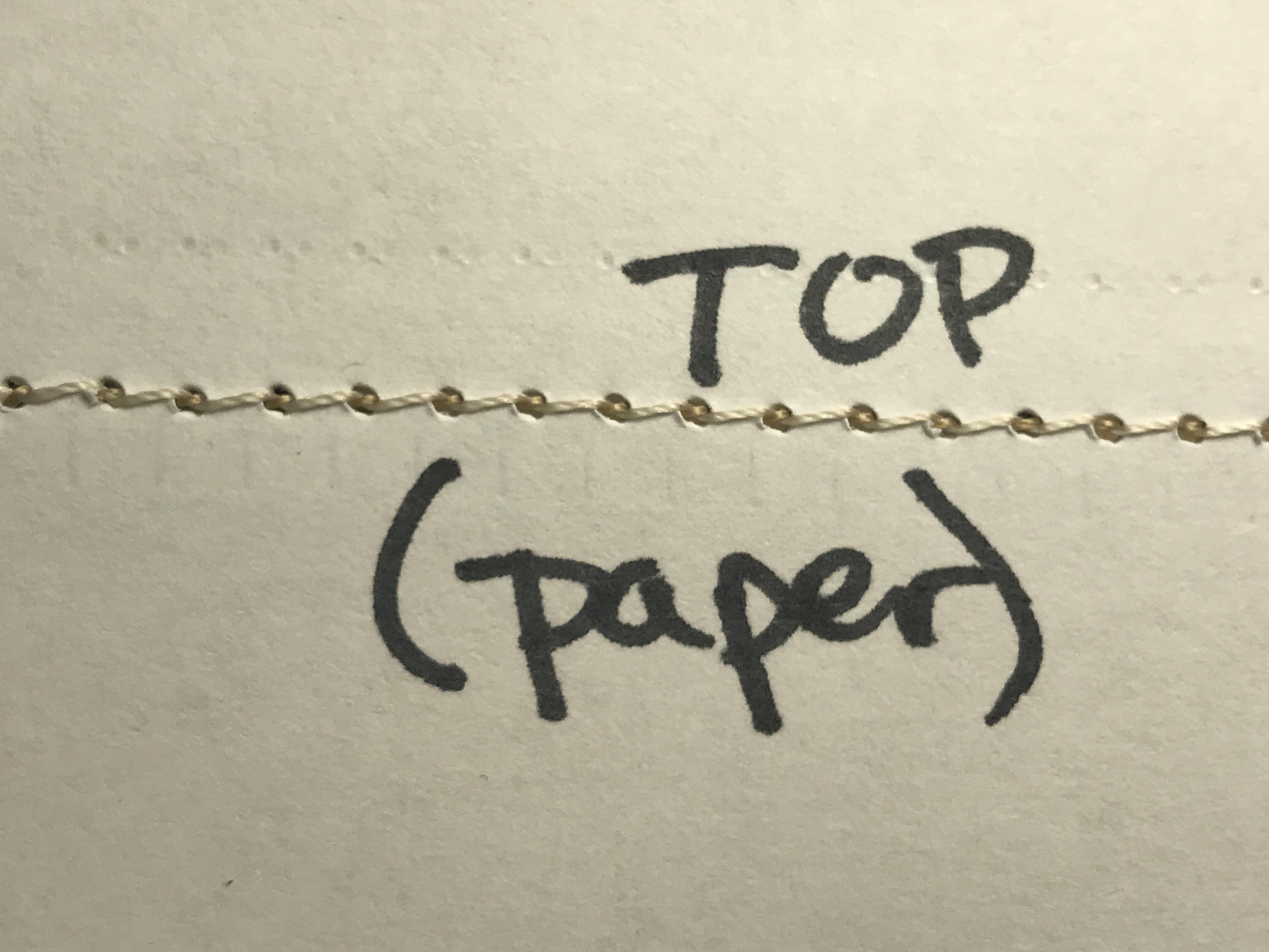

Here are two samples on different materials
The first is 0.1mm printer paper. The stitches are uniform. No curls
The second is 0.4mm canvas. This one has curls.
125 needle, round point
TEX 70 unbonded  thread

  • Contributing Member
Here's one more sample of the 0.4mm canvas.
This time I've marked the curly Q's with black marker
To be clear, it's not the bottom thread showing through that I'm trying to fight. I understand that is a tough challenge on thin fabrics. But the curly Q's are new to me, and I'd like to know what is causing them, or how to make them go away.
It reminds me of when I allow a long piece of thread to double over on itself, then the loop that is formed curls together.
