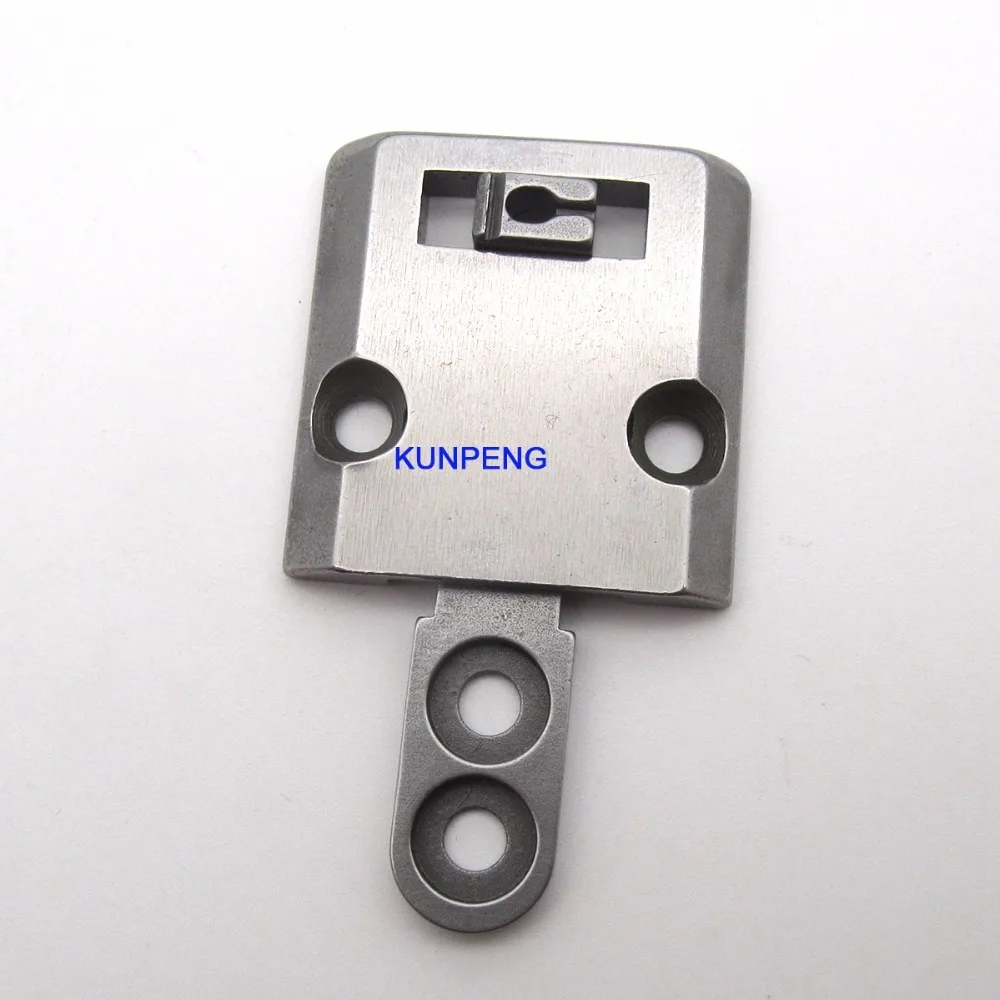

Members Tigweldor Posted April 24, 2025 Members Report Posted April 24, 2025 (edited) I would also look for a different bottom transporter - the hole in yours seems extremely large and with no sharp edges - when the needle penetrates through leather - it will push it into the very large hole and leave ugly dimples - like in your pic #5 that you posted in a different topic - the white bottom thread around the latch. Edited April 24, 2025 by Tigweldor Quote

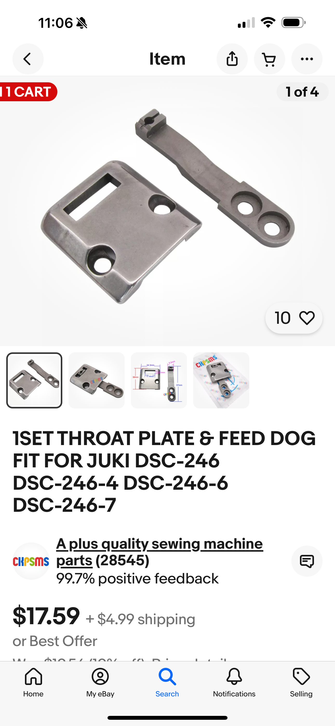

Members Piko Posted April 25, 2025 Author Members Report Posted April 25, 2025 11 hours ago, Tigweldor said: I would also look for a different bottom transporter - the hole in yours seems extremely large and with no sharp edges - when the needle penetrates through leather - it will push it into the very large hole and leave ugly dimples - like in your pic #5 that you posted in a different topic - the white bottom thread around the latch. That sounds like great advice. I didn't think I could change that hole. I have read elsewhere on this forum, which btw is amazing, and I have learned that I could change the pressure of the presser foot (of both presser feet actually) so I did and the dimple is much less noticeable. However, I would like to know hot to change the bottom transporter. I am not sure I know exactly what it is and, is it something I can do myself? Do you have any suggestion on where to find parts that work on my machine? I know it is aclone of a juki dsc246 but when I look on Amazon, ebay or jus tgoogle it nothing really comes up in terms of parts that I could be sure would be compatible. Thanks for your help. Quote

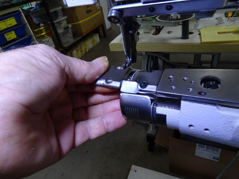

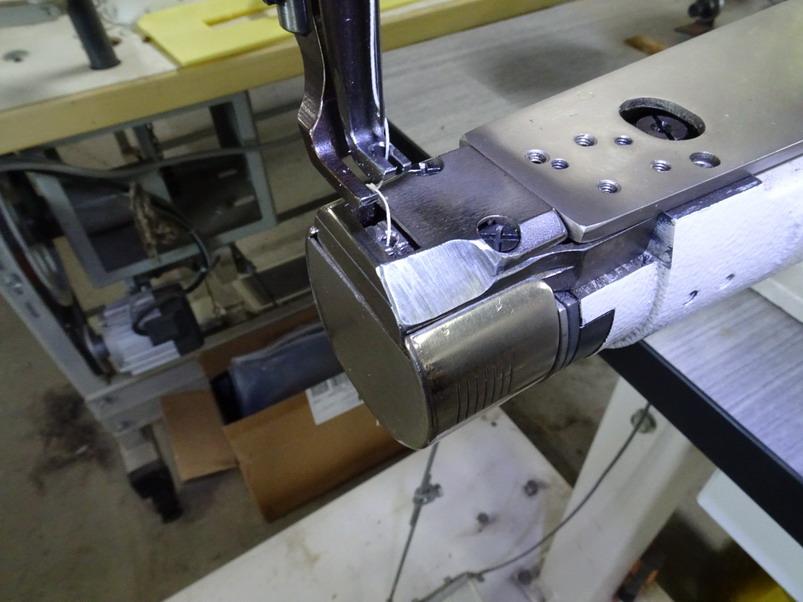

RockyAussie Posted April 25, 2025 Report Posted April 25, 2025 47 minutes ago, Piko said: That sounds like great advice. I didn't think I could change that hole. I have read elsewhere on this forum, which btw is amazing, and I have learned that I could change the pressure of the presser foot (of both presser feet actually) so I did and the dimple is much less noticeable. However, I would like to know hot to change the bottom transporter. I am not sure I know exactly what it is and, is it something I can do myself? Do you have any suggestion on where to find parts that work on my machine? I know it is aclone of a juki dsc246 but when I look on Amazon, ebay or jus tgoogle it nothing really comes up in terms of parts that I could be sure would be compatible. Thanks for your help. I don't know if this will load or not due to the size but if so on page 8 part 6 is a small rod which holds the feed dog up 1.2mm above the needle plate. I sanded mine down about .3mm. The feed dog has a little funnel at the top lip which you could sand away if you wanted to but does make it a little more dangerous for a beginner as the needle can sometimes go sideways and strike the side of the feed dog. dsc246.pdf Quote Wild Harry - Australian made leather goodsYouTube Channel Instagram
