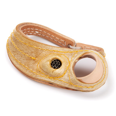

Contributing Member fredk Posted 6 hours ago Contributing Member Report Posted 6 hours ago 33 minutes ago, SUP said: Yes, I will be punching the stitching holes. But I have had trouble earlier where the needles have broken, even with punched stitching holes. Use one of these; a saddlers palm, aka a sailmakers palm Available for left or right hand. Handy to have for the occasional use. Generally not expensive but some can be I find on thick leather the needle is reluctant to go through so I use a small pair of pliers to help pull it through Quote Al speling misteaks aer all mi own werk..
