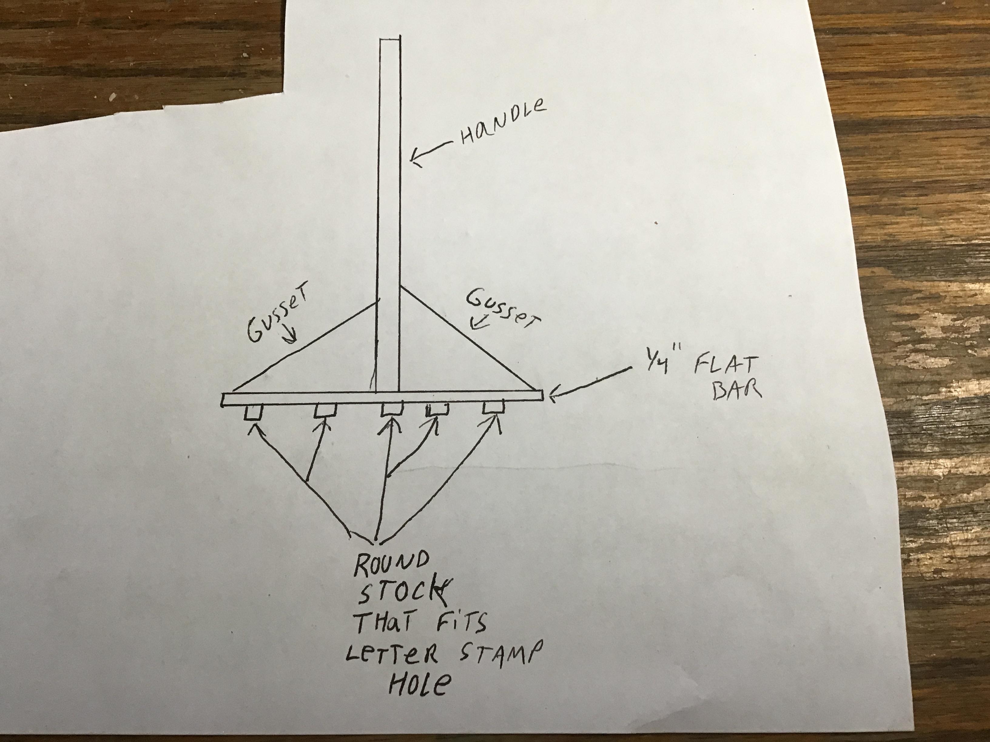

Members JDFred Posted Tuesday at 12:56 AM Members Report Posted Tuesday at 12:56 AM You could build a handle pretty easy for what you are wanting. I hate typing so I drew a picture forgive my poor drawing skills. Then you could use this jig that Tandy sells to keep everything straight. Quote

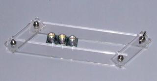

Contributing Member fredk Posted Tuesday at 02:09 AM Contributing Member Report Posted Tuesday at 02:09 AM (edited) 1 hour ago, JDFred said: . . . Then you could use this jig that Tandy sells to keep everything straight. I made a couple of the jigs from off-cuts of acrylic, some small bolts & nuts and a few wing-nuts. I made two just cos I had enuff material. Together they cost under £8, or under £4 each ($5?) Once I have the letters in this I use a narrow steel plate of 3mm thickness laid across them then use the biggest 3D handle on top to guide my thumps Edited Tuesday at 02:15 AM by fredk Quote Al speling misteaks aer all mi own werk..
