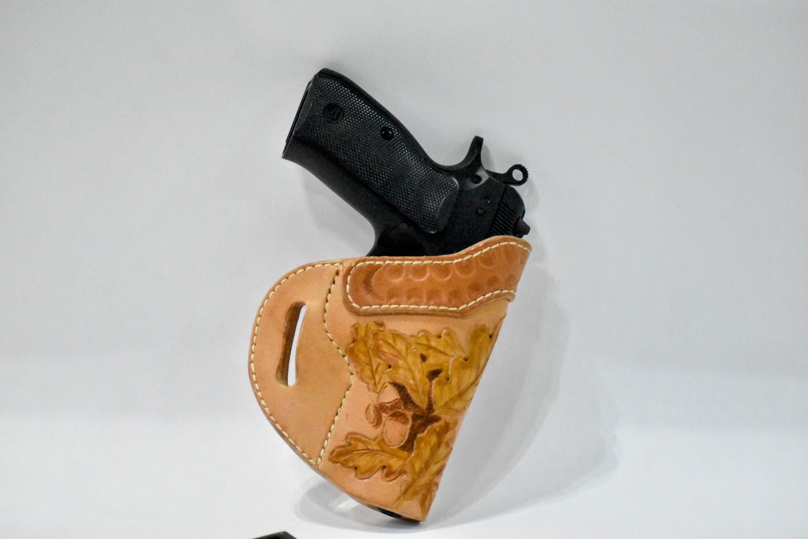

Members larry1096 Posted May 21, 2025 Members Report Posted May 21, 2025 (edited) I'm no pro, so take this for what it's worth. When I do a natural holster, I typically apply neetsfoot oil to give it a bit of a 'tan', rather than the fairly stark white some hides show. Got to be careful not to apply so much it softens up, though. I will typically do the 50/50 M&G on something OWB, but just leave it at the oil for IWB and shoulder holsters. Since I only make these for myself, I have less concerns about longevity, and the uncoated leather seems more comfortable against the body (for me, at least.) Larry Edited May 21, 2025 by larry1096 Quote

PastorBob Posted May 21, 2025 Report Posted May 21, 2025 (edited) 1 hour ago, DeWayne Hayes said: Larry, beautiful work! Thanks for the tips. I tend to shy away from Neatsfoot, as my holsters are wet formed, and I don't want to soften them and lose that form. Al, thanks too - I looked at Leather-n-rich and it appears to be carnauba based, so I'm guessing my Atom Wax does about the same thing. I will usually apply the neatsfoot just after it's been cut out. If dyeing, I dye it right after the NFO. If not, then I allow the oil to dry, then put the holster together, then apply sno-seal, or my homemade protectant made of beef tallow and beeswax. Seams to do the trick. This one has a little dye on the tooled portion, but the remainder is natural HO veg tan. Edited May 21, 2025 by PastorBob Quote In God's Grace, Pastor Bob "While we were yet sinners, Christ died for us." - Romans 5:8 www.PastorBobLeather.com YouTube Channel
