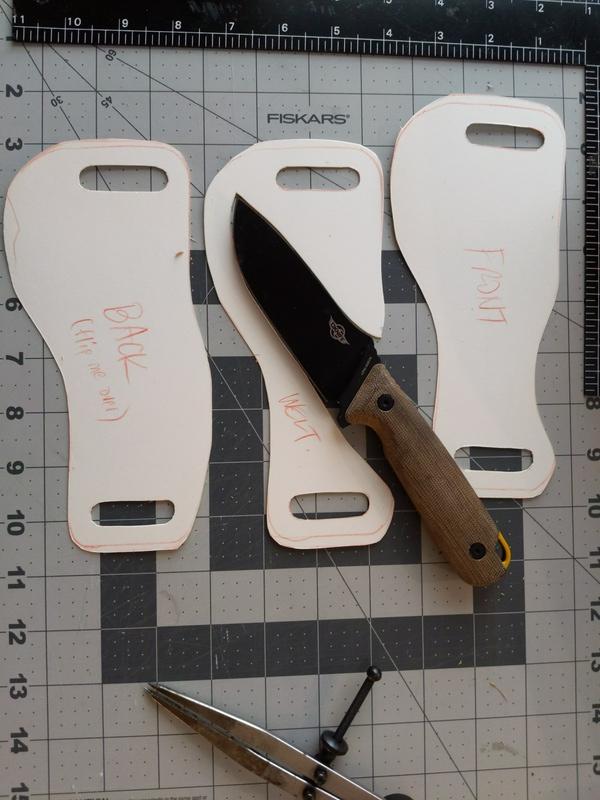

AEBL Posted July 7 Report Posted July 7 I have an order for a knife sheath, pancake style, for a knife that the customer provided for me to use in custom fitting. I have made sheaths for things, and I know that a welt is a good thing to protect the stitches. I've found a few patterns for pancake style sheaths, but they usually seem to be two pieces of leather glued together and stitched ... with no welt. I was thinking three layers? the middle layer is the welt? Quote
Contributing Member fredk Posted July 7 Contributing Member Report Posted July 7 Go with what you know to be the better construction; use a welt Quote Al speling misteaks aer all mi own werk..
CFM chuck123wapati Posted July 7 CFM Report Posted July 7 pancakes are mostly used for folding knives, so dont need a welt. For a non folder make your welt thinner than the blade so there is some tension built in. Quote Worked in a prison for 30 years if I aint shiny every time I comment its no big deal, I just don't wave pompoms. “I won’t be wronged, I won’t be insulted, and I won’t be laid a hand on. I don’t do these things to other people, and I require the same from them.” THE DUKE!
AEBL Posted July 7 Author Report Posted July 7 Ok - I will think about this for a bit. If I remember, I'll post pictures of what I wind up doing for constructive criticism Quote

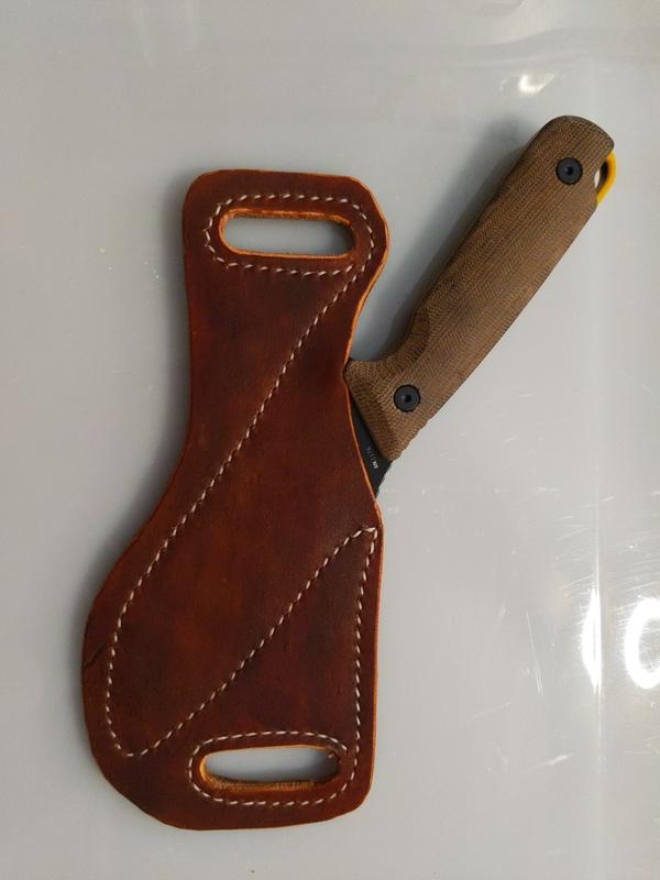

AEBL Posted 1 hour ago Author Report Posted 1 hour ago (edited) In case anyone was interested, I attached some photos. I punched the holes through the back piece before gluing. Once I cut the holes and trimmed the uneven parts, it looked ... bad ... I also messed up a few other things. Gave it to the guy to try out. If he liked it, I told him I'd make him another one that wasn't messed up. Edited 1 hour ago by AEBL picture was too big Quote
