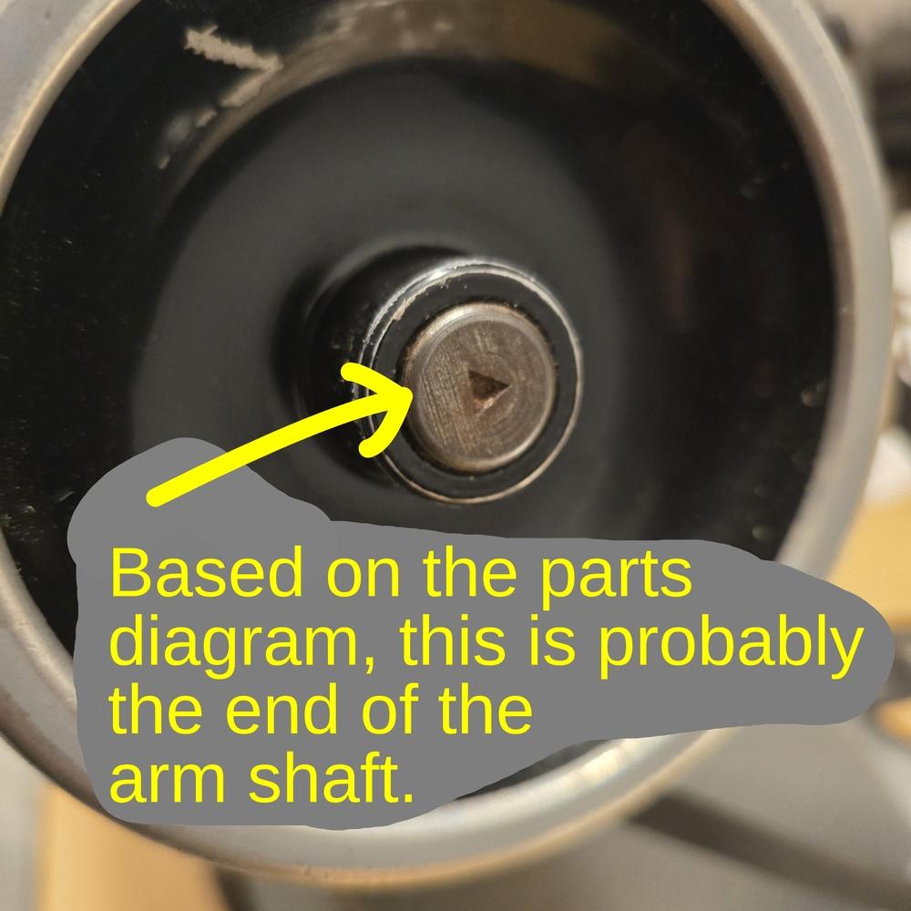

Contributing Member friquant Posted Saturday at 05:39 PM Contributing Member Report Posted Saturday at 05:39 PM On 9/30/2025 at 3:34 PM, friquant said: remove the stock handwheel screw, and install the collar (with extra long screw) in its place. I was wrong about this. I didn't realize that the 211G does not actually have a stock handwheel screw. I assume that piece with the triangle is actually the arm shaft. Quote friquant. Like a frequent, piquant flyer. Check out my blog: Choosing a Motor for your Industrial Sewing Machine

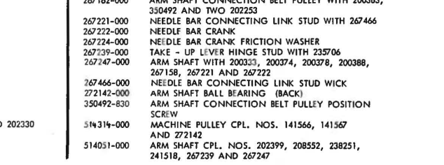

AlZilla Posted Saturday at 06:33 PM Report Posted Saturday at 06:33 PM 1 hour ago, Constabulary said: true - as on most machines. Problem is IIRC that the shaft bearing (272142 I think) is inside the hand wheel or the casting and my buddy said the bearing is THAT tight on the shaft or inside the hand wheel / casting (glued or shrunk fit) that you cannot pull it of w/o damaging other parts. Maybe CowboyBob knows better 😉 272142 looks like the hand wheel itself, to me. There would be no reason for a bearing between a hand wheel and the arm shaft, I don't think. The wheel turns the shaft. Maybe it's more complex. Definitely interested in how this one turns out. Quote “Those who can make you believe absurdities can make you commit atrocities.” - Voltaire “Republics decline into democracies and democracies degenerate into despotisms.” - Aristotle

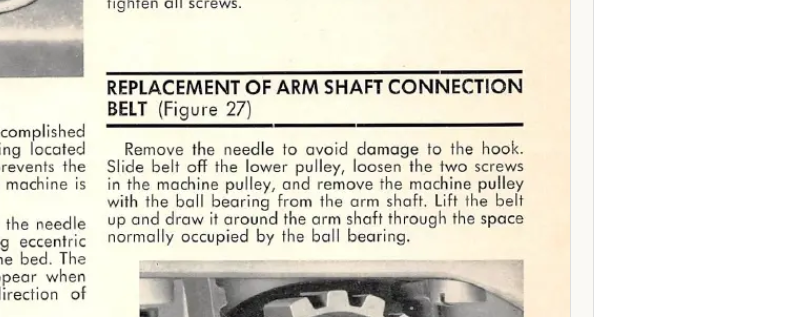

AlZilla Posted yesterday at 01:54 AM Report Posted yesterday at 01:54 AM No, 272142 says it's an arm shaft ball bearing. I still don't understand what is rotating on it, but it's clearly there. But the Adjusters manual seems to think it's a piece of cake ... Quote “Those who can make you believe absurdities can make you commit atrocities.” - Voltaire “Republics decline into democracies and democracies degenerate into despotisms.” - Aristotle
