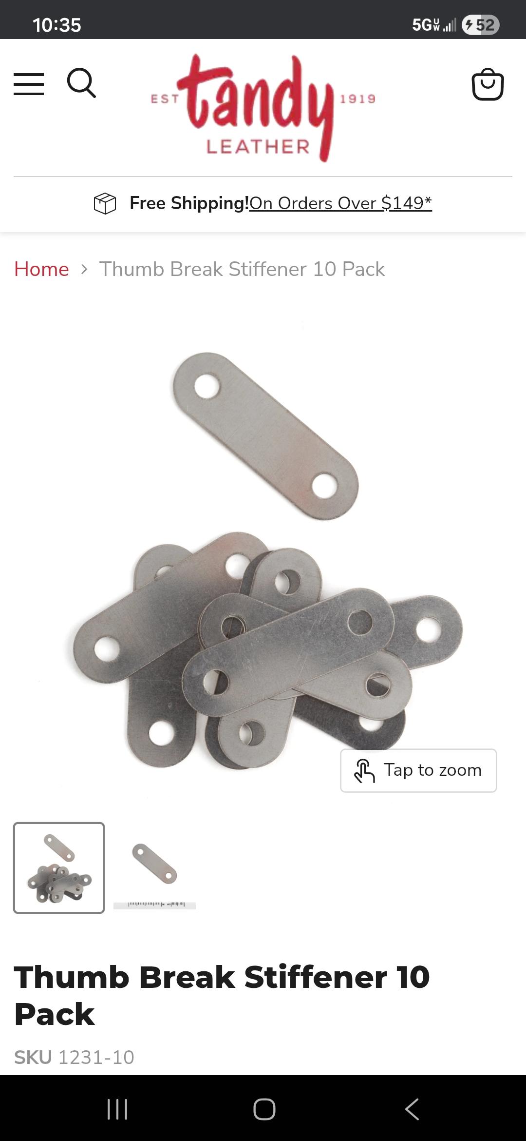

Members charleskterry Posted November 29, 2025 Members Report Posted November 29, 2025 Can anyone recommend sources for the springs in order to make Springbreak shoulder holsters? I’ve looked locally @ Home Depot, Lowes etc but I can’t seem to find anything but very mild steel, brass, or aluminum. I’d appreciate any assistance. thank you in advance Charles Quote
Members DieselTech Posted November 29, 2025 Members Report Posted November 29, 2025 4 minutes ago, charleskterry said: Can anyone recommend sources for the springs in order to make Springbreak shoulder holsters? I’ve looked locally @ Home Depot, Lowes etc but I can’t seem to find anything but very mild steel, brass, or aluminum. I’d appreciate any assistance. thank you in advance Charles Like these? Also holstersmiths have different versions. Quote

Members charleskterry Posted November 30, 2025 Author Members Report Posted November 30, 2025 Diesel tech: no, not thumb breaks but springs for springbreak holsters. You used to see them used more big revolvers carried vertically in a shoulder holster. You could unsnap the retention and draw the pistol almost as if it was being carried horizontally because the belly of the holster was open and held the weapon in place under spring pressure. It’s a pretty neat older idea I want to attempt on a few of my own semi automatic pistols. Quote
