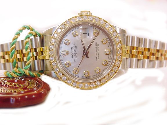

Members xlr8tn Posted March 28, 2009 Members Report Posted March 28, 2009 (edited) I am looking for something similar to what Rolex uses on their watches to promote authenticity. I make custom watch straps and would like to come up with something similar...just have no clue what company could make these for me. My logo is the fleur-de-lis. Is it plastic or wax? Any idea what these are called? Thanks, Brent Edited March 28, 2009 by xlr8tn Quote
Members badger Posted March 28, 2009 Members Report Posted March 28, 2009 Hi Brent, What they represent is a wax seal, used on envelopes and scrolls in the past to prevent unauthorised eyes from reading letters. Also used whenever a tamper-evident seal was required on anything. You can't easily open a wax seal without it breaking or showing some tamper evidence. Originally things would be sealed with red 'Sealing wax,' a very hard and brittle wax, in the form of a red candle-like obect with a wick running up the middle. Like a candle, it's lit, and the wax allowed to drip onto the enevelope where its was folded shut. A seal emblem, usually of metal (on a finger ring) was pressed into the wax while still liquid. The sudden cold of the metal set the wax and took an impression of the seal. It was used to ID the sender. The seals on the watches are red plastic reperesentations of a wax seal. You can buy sealing wax still, and you could have a metal seal of your logo made up. Drip the wax onto a ribbon and seal it with the stamp. A light coating of olive oil on the stamp before use will allow it to release from the wax. Alternatively, make an original wax seal as described above then and make a silicone rubber mould of it and cast some out in red polyurethane resin. Cheers, Karl Quote

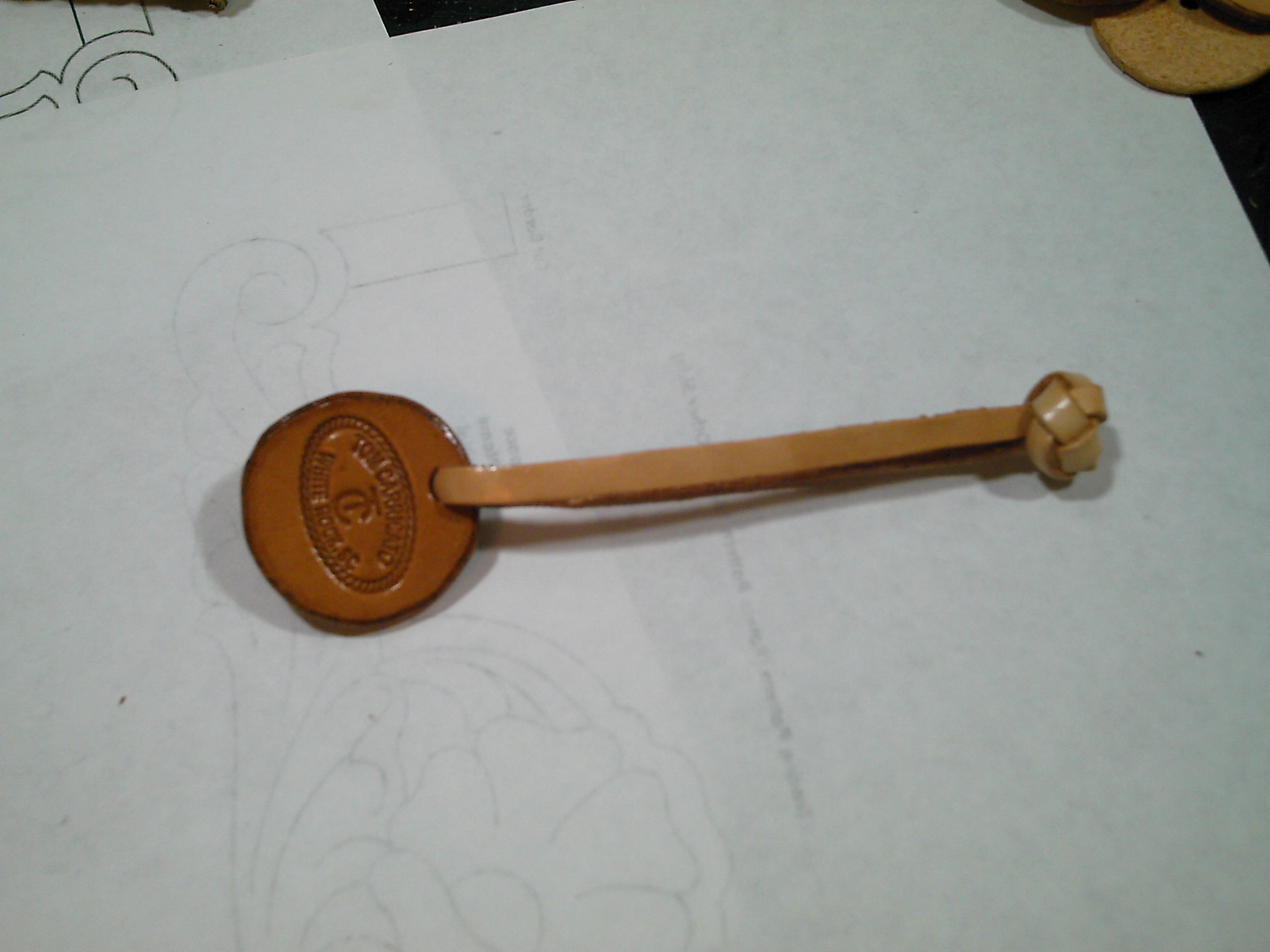

carr52 Posted March 29, 2009 Report Posted March 29, 2009 Granted it's not as classy as Rolex and my circle cutting skills leave something to be desired, but it's something I do when I cant or don't want to put a makers mark on a project. Such as the face of a check book cover. It just adds a more personal touch. Tom Quote
