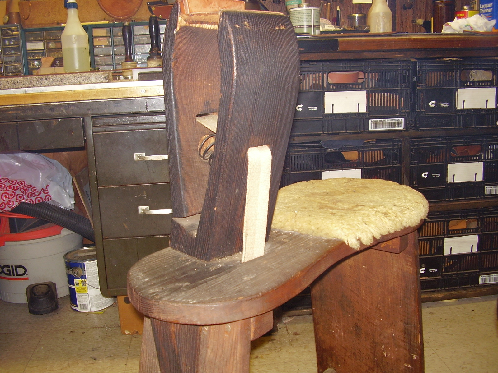

Luke Hatley Report post Posted March 7, 2008 nylon may be a better idea, i may check into it in the future if the leather gives up. thanks this is the stiching hores that i made about 20 yrs ago. Quote Share this post Link to post Share on other sites
rsg3 Report post Posted March 7, 2008 I hope mine holds up for 20 years. What is your seat made out of? It looks like spray foam from here. My buddy said if he makes any more he wants to make some improvements to the legs, as far as the nylon is concerned he would have to make wider slots probably, the ones on mine are only an inch wide once that leather wears out i will probably widen the slots like yours and use nylon. thanks for the the idea Quote Share this post Link to post Share on other sites
Luke Hatley Report post Posted March 7, 2008 I hope mine holds up for 20 years. What is your seat made out of? It looks like spray foam from here. My buddy said if he makes any more he wants to make some improvements to the legs, as far as the nylon is concerned he would have to make wider slots probably, the ones on mine are only an inch wide once that leather wears out i will probably widen the slots like yours and use nylon. thanks for the the idea RSQ3.... The seat is covered with a pc of sheepskin, just a little padding. and the History of the wood. The wood came from a very old house that was being torn down to make way for modern improvments here in Memphis, At that time the house was 125 yeard old. a friend of mine bought the house for the wood in it. The wood is Cypress and is" 5 quarters thick" and the the width of the board i got was 18" ..... the jaws or clamp was a 4x4 pc of red oak he gave me.. Quote Share this post Link to post Share on other sites
