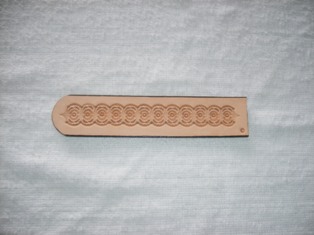

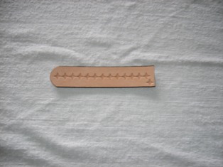

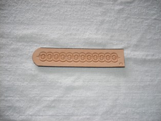

alsleather Posted April 19, 2009 Report Posted April 19, 2009 This is a tutorial of a stamped belt design. 1. After you have sized the belt, mark a line on the center of the belt. You can also add a border line. 2. The first stamp that I used was G9008-03 which is stamped on the guide line. 3. The next stamp used is V406 which is stamped between the points of G9008-03. 4. After the veiner was stamped, the next stamp is D637 which is stamped on the center lines on both sides. 5. The F922 is stamped that fills in the space above D637. 6. The S932 is stamped between the veiner impressions. 7. The final stamp used is S350 stamped in the center at the points of the G9008-03. You can see that I used a variety of stamps which included a geometric,veiner,border and seeders. I work from the center first and then fill the design. Have fun stamping! Allan Quote

alsleather Posted April 21, 2009 Author Report Posted April 21, 2009 Sorry, the first one did not turn out very well, this is the second try with the same design and larger pictures. This is a tutorial of a stamped belt design. 1. After you have sized the belt, mark a line on the center of the belt. You can also add a border line. 2. The first stamp that I used was G9008-03 which is stamped on the guide line. 3. The next stamp used is V406 which is stamped between the points of G9008-03. 4. After the veiner was stamped, the next stamp is D637 which is stamped on the center lines on both sides. 5. The F922 is stamped that fills in the space above D637. 6. The S932 is stamped between the veiner impressions. 7. The final stamp used is S350 stamped in the center at the points of the G9008-03. You can see that I used a variety of stamps which included a geometric,veiner,border and seeders. I work from the center first and then fill the design. Have fun stamping! Allan Quote
