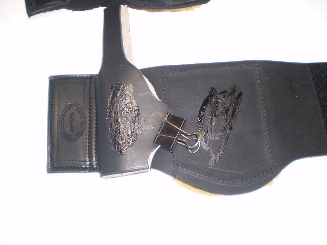

The first 3 photos are of my old hoster that I carry amost every day. The other two is the pattern for the wrap around piece. I am not sure how to do this to get the words under the right picture as I go but I hope Johanna will see what I am trying to do and fix it.
Next I lay out the chap leather after cutting and attach the 2 pieces of loop velcro on the top side at one end. Then attach the hook velcro on the botton side at the other end, this way when you wrap it around your ankle it will over lap and attach to each other. Sew the velcro and the sheepskin on. See photos
Next lay your holster in the area of the sheepskin and adjust it to the proper draw angle and sew it in place laying open, Next , this is a good time to install one side of the snap. There is one other option I have done before that needs to be done now. If the customer wants a garder strap to go up over the calf of the leg to help hold the holster up higher on the ankle you can install a 3/4 square in the area of the snap to attach the garder system, I make those out of 2" wide elastic and velcro also. Then fold over and sew the holster and finish the retention flap and finish installing other half of the snap.
This design has served me well over the last 2-3 years. It is very secure and you can wear it on your ankle or over a lace up boot. You may have to adjust the overall length of 15" one way or another. !5 inches works well on me but I have large ankles and wear it over a lace up roper boot while on duty.
The last picture show it on my ankle with just a pair of shoes. I have pleanty of room to put it over my lace up boots tonight when I go on duty. Bad Guys Beware!! :whatdoyouthink:

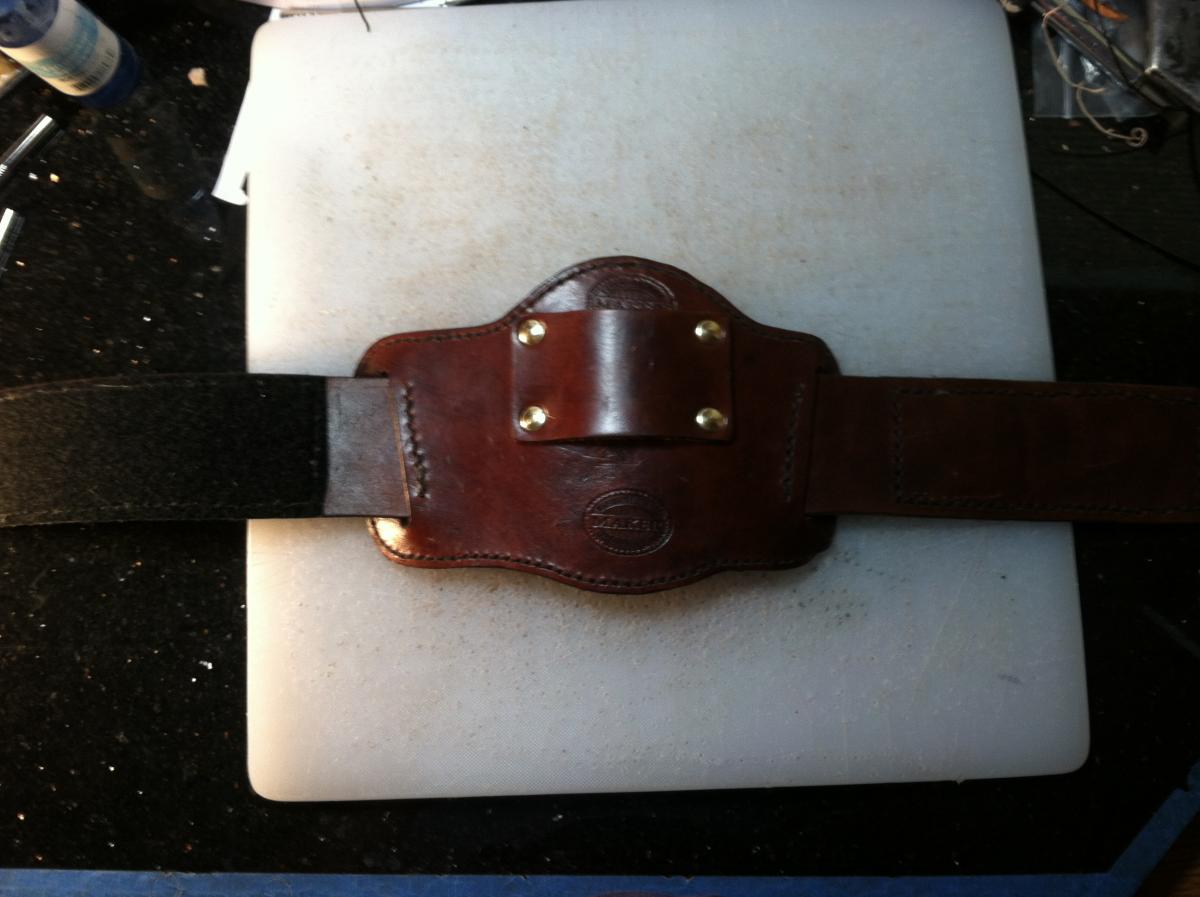

I was working on my own pattern before I saw yours. My original plan was to use elastic strap with two rings on one end to pull it through to tighten it up on the ankle. The problem I ran into was it did not pull the center of the leather where the holster would be against the leg. So I made a leather piece with Velcro on it, stitched it in two places to the main body. It still does not seem to allow it to be pulled tight enough to keep it from sliding down on the leg especially if you put it over a sock. Here is a picture of my design. Any help would be appreciated. It looks like yours is down low on the ankle. How does the pant leg cover this up?
post-50652-0-66548300-1398530949_thumb.j
Pappy, what is on the backside of the leather holster pad is it just leather/ If it is that could be part of the problem. You don't want to have to pull it tight enough to turn your leg blue. You need to have some friction as well. Either suede or shearling should help, neopreme might work but may cause sweating.
I used black pig skin suede. But the strap I ran through does not have any on it. So would it help if I put a piece on it also? I used 4-5 ounce leather for the body and strap.
post-50652-0-90079600-1398602049_thumb.j
I made a new pattern that is similar to yours. I find that when wrapping it around my ankle the attaching ends want to go crooked. Not sure if I am explaining this so it is understandable what is happening. If I force them to be straight, the body where the holster is attached pulls away from the ankle at the bottom. Any suggestions?
