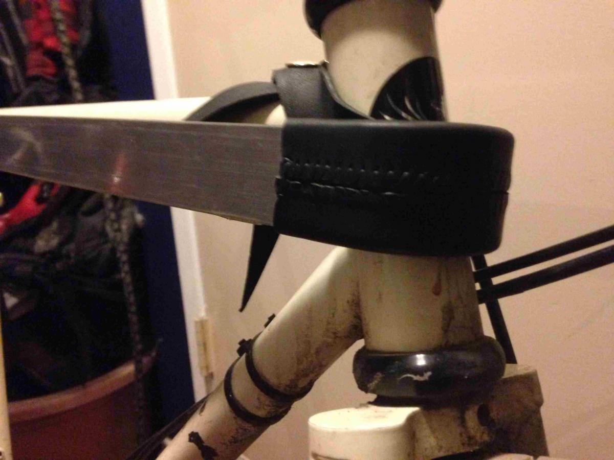

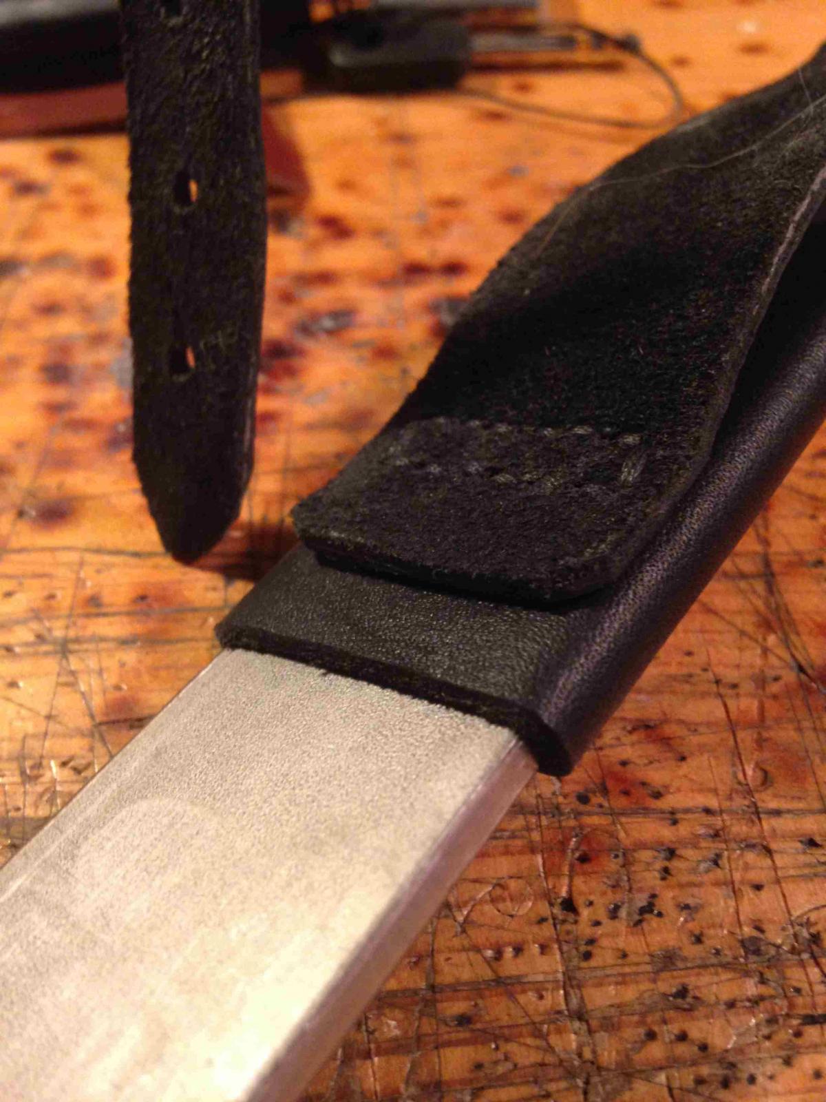

Members TinkerTailor Posted May 21, 2015 Members Report Posted May 21, 2015 (edited) Here is a couple of pics of a baseball stitch i did for a commission to design a custom leather mounting solution for a titanium bicycle lock. The thing rattled and chipped paint really bad with the factory mount. This is done with 7 oz chrome tan wax stuffed leather and .06 tiger thread. I had to use the tiger cause the lock model is the TiGr...... It took alot of force to wrap leather that thick around a curve that small. I think it turned out good. I just need to refine the strap ends and hardware and she is done. My bike is dirty....... Edited May 21, 2015 by TinkerTailor Quote
