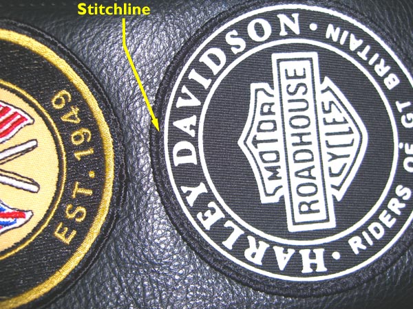

Members celticleather Posted May 11, 2009 Members Report Posted May 11, 2009 (edited) Ray We do quite a lot of this at the shop. I always ensure that the jacket/waistcoat owner is aware that I will be sewing through the lining, and I check that it will not entail stitching through an inside pocket. I stick the patches to the coat with double-sided tape, and stitch as close to the edge of the patch as possible. I've found it best to use the flat table on our 29K, to reduce the risk of the lining puckering. Terry Edited May 11, 2009 by celticleather Quote When everyone is somebody, then no one's anybody

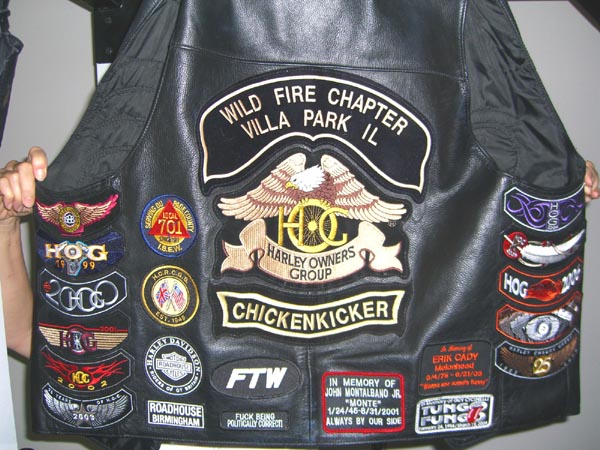

Members cdthayer Posted May 12, 2009 Members Report Posted May 12, 2009 I plan on using my trusty 29K4 with UK #40 thread. Where do I start and finish - to stick or not to stick; and what do I stick 'em with? We have put most of our own patches on our own biker vests, although we've had Vendors put some on while we were at the rally where we bought the patches. My wife put a bunch of them on with a home sewing machine (an old JC Penny free-arm machine) using common Coats & Clark Dual Duty thread. She pinned them. They've been on there for years, through more than one rain storm, and are still firmly attached with no problems. We've never sewn a patch onto our coats, which are thicker. All of the patches go on our vests that have thin liners. We sew a few patches onto biker vests at our shop, and have probably "moved" as many as we have added new ones. So far, all of the patches that we've sewn on have been on non-club vests for recreational bikers with no set standards as to where a patch goes. We have the customer put the patch where they like it, and we sew it on for them. Then, later on, they'll come in with a new patch that they like better, and want it put where we put the last one. LOL! We've tried a variety of methods to keep patches from moving while we're attaching them, but they all seem to have some kind of problem. Two-sided tape doesn't always stick good enough to "seasoned" leather. Pins work ok, but are hard to insert and can cause puckering, and some folks don't like for us to add more holes to their leather without putting thread in it. (Remember, a lot of these jobs include moving a patch, so there's already going to be several unfilled holes and another hole or two from a pin isn't an issue for them.) One customer brought in his vest with duct tape rolled and placed under the patch. Worked really good to hold the patch for me, but then one day I had to move a patch that had been stuck with duct tape about 5-6 years earlier. Wasn't hard to get the patch off, the tape "cloth" just fell out when I removed the stitches, but the gum from the tape was on there like concrete. We are going to start using Fabri-tac sparingly (just a few dots around the patch), but it's a permanent bond and I'm concerned about how it "untacks" after time. We're still looking for a better solution. I may try the sprits of spray adhesive. At the shop, my wife puts patches on leather vests with a Singer 401A and Dual Duty thread, just like she does on uniform shirts. I use a Consew 225 for flat patches, especially large back patches, and a 29k70 (without table extension) for patches over pockets. I use whatever thread I have that matches the patch border color, but like to use V92. If a patch is only partially over a pocket, I sew what I can with the Consew first, and then finish up on the boot patcher. I've had problems keeping the lining straight with the 29k. I usually start sewing at the bottom of the patch for some reason. I'm not sure why. And from the looks of the patches coming into the shop lately, I think that patch makers have a contest going on to see how many points and curved edges they can design into them.... CD in Oklahoma Quote "I sew, I sew, so it's off to work I go....." My sewing machines:Adler 205-370 (Hand Crank), Adler 205-64 (Hand Crank), Consew 226 (Clutch/Speed Reducer), Singer 111G156 (Hand Crank or Clutch), Singer 111W153 (Clutch), Singer 20U33 (Clutch), Singer 78-3 Needlefeed (Treadle), Singer 20U (Treadle), Singer 29K70 (x2) (Both Treadle/Hand Crank), Singer 96-40 w/Darning Foot (Treadle), Singer 31-15 w/Roller Foot (Treadle), Singer 31-15 (Hand Crank), Singer 16-41 (Treadle), Singer 66-1 (Treadle/Hand Crank), Singer 201K4 (Treadle/Hand Crank), Singer 216G Zigzag (Treadle/Hand Crank), Singer 319W (Treadle)
