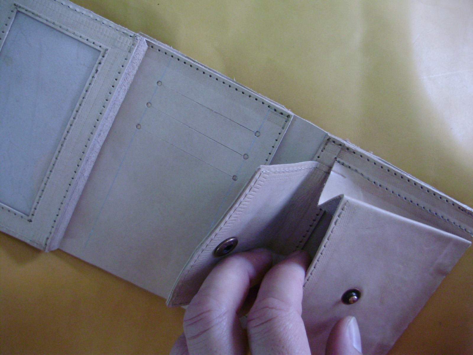

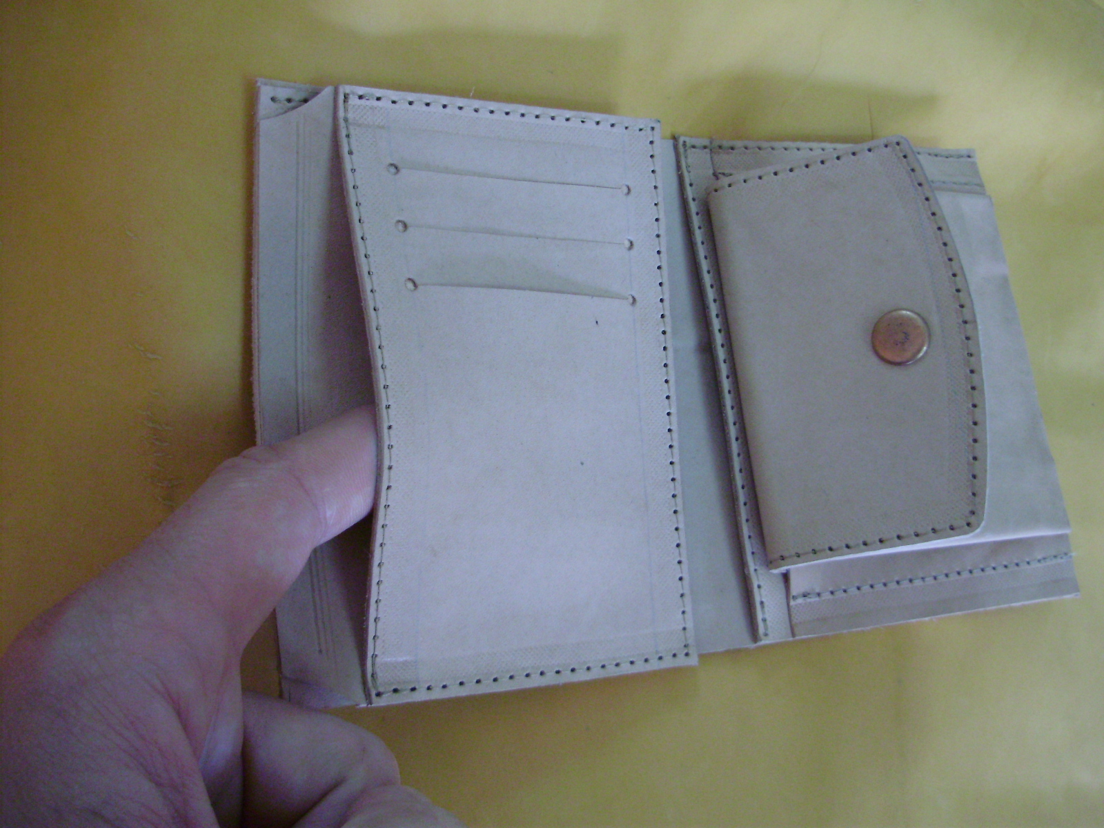

hello take a look at my work if you like it i will givr general rouls you can folow to make a wallet
this is another model
dont forget to visit me
www.chatawleather.com
all the best
Thanks for the photos. I really like your work, and i´ll be glade if you may share some kind of tutorial of it.
Thanks again.
Please do. A step by step tutorial will be great.
Geoff

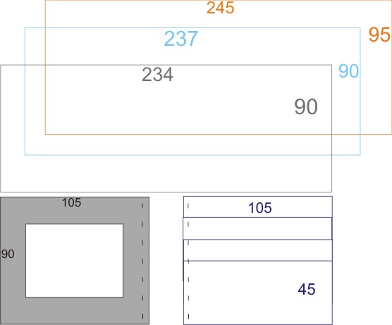

ok fine
but i think its better to do with photo step by step the easy model
i mean the classic stuff , any way in general inside the wallet you have tow thing
cards place and frame or ID place ( some times you dont need ID ) thats mean you have tow places for cards
first you need to form the pockets for cards then fix them in the ( inside leather )
the pockets could be vertical or horezental , vertical is more easy for you
here is drowing with sizes
this sizes can be adjested accourdingly to fit your corrency
this wallet drowing contain three layers
if you want tow only the outer one should be 0.5 cm more in weidth
(((( sory for my poor english ok ))))))
in lingth the deffrences are important cos when you bendt the wallet with some paper mony inside it should bend nice and easy not sqwees

Very nice Chataw. What do you do in back of the credit card slots so the two top credit cards don't fall down to bottom?

Yeah, all you have to do is sew along the bottom of each pocket onto the layer behind it.
