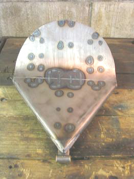

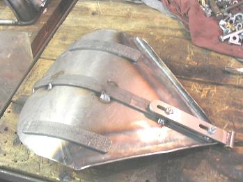

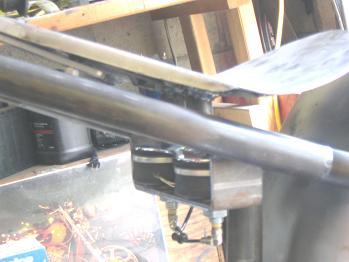

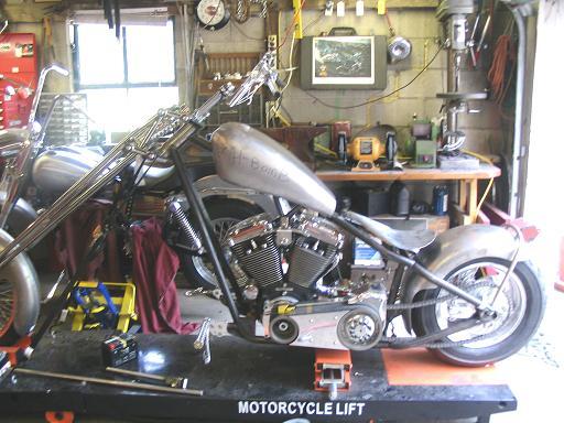

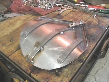

Sawyer Report post Posted March 24, 2008 David- Amazing workmanship all around! Just Beautiful! Thanks for posting! Great looking seat David, you do amazing work! i'm starting a LARGE solo seat for a gentleman ,He clocks in about 6'6" over 300 lbs, so the seat is large with heavy 1'x3/8" steel ribs for strength on the seat pan, so the seat is thick too. I made the pan out of 14 gauge steel, along with the ribbed support and the mounting studs, the thing is heavy! The mounting studs are long and mounted to a Paul Cox RigidAir seat suspension system. The whole motorcycle is 10feet 4inchs long, the foot pegs are mounted 4 inchs forward, hard for someone like me with shorter legs than Big "H" as he's called. Working on the leather carving now, Taurus the Bull, but my camera is not working at this time. i hope to get another soon. Sawyer Quote Share this post Link to post Share on other sites
David Report post Posted March 24, 2008 Great looking seat David, you do amazing work!i'm starting a LARGE solo seat for a gentleman ,He clocks in about 6'6" over 300 lbs, so the seat is large with heavy 1'x3/8" steel ribs for strength on the seat pan, so the seat is thick too. I made the pan out of 14 gauge steel, along with the ribbed support and the mounting studs, the thing is heavy! The mounting studs are long and mounted to a Paul Cox RigidAir seat suspension system. The whole motorcycle is 10feet 4inchs long, the foot pegs are mounted 4 inchs forward, hard for someone like me with shorter legs than Big "H" as he's called. Working on the leather carving now, Taurus the Bull, but my camera is not working at this time. i hope to get another soon. Sawyer Hey Tom, That pan looks about the size of the Bandidos seat. How are you going to wrap the leather around the front of the seat?....It looks like there are pieces welded perpendicular right at the edge of the seat. I hope my question is clear....just not sure how you are going to do the leather part of that. Is this going to be a springer seat? Those air suspensions look pretty cool, wonder how well they work and how rigid they mount to the frame.....I have no experience with them. Cool bike. Dave Theobald Quote Share this post Link to post Share on other sites

Sawyer Report post Posted March 25, 2008 Hey Tom,That pan looks about the size of the Bandidos seat. How are you going to wrap the leather around the front of the seat?....It looks like there are pieces welded perpendicular right at the edge of the seat. I hope my question is clear....just not sure how you are going to do the leather part of that. Is this going to be a springer seat? Those air suspensions look pretty cool, wonder how well they work and how rigid they mount to the frame.....I have no experience with them. Cool bike. Dave Theobald The RigidAir Suspension is actually welded to the frame, there are no springs , just air bags that inflate and deflate with a switch and small air compressor mounted to the frame also. Not sure about how the leather will go, i'll cross that bridge as i go along. Quote Share this post Link to post Share on other sites
