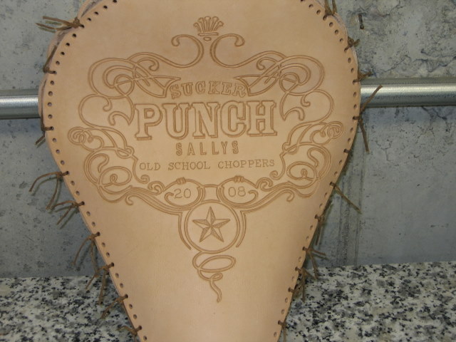

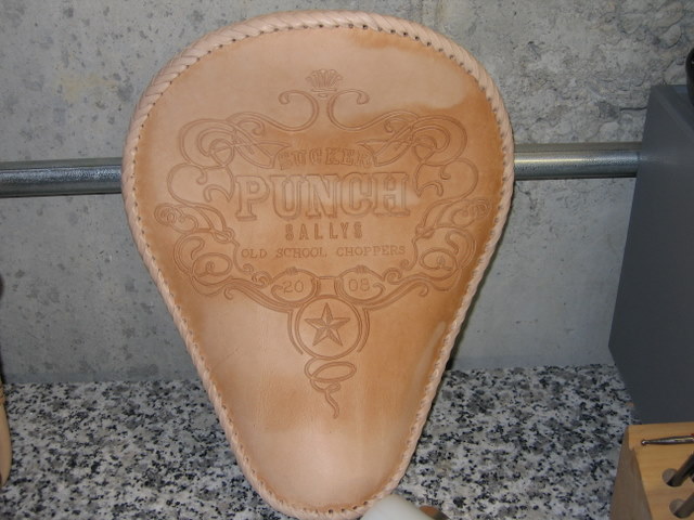

David Posted March 30, 2008 Report Posted March 30, 2008 Had this artwork requested from SPS West. It was an interesting challenge. I've never done Victorian Scroll type work before and had never connected it with motorcycles. I tried the "fast" basketweave that ShirleyZ used on her USMC seat. It certainly is faster, I like it. Dave Theobald http://theobaldleather.com Quote

David Posted March 30, 2008 Author Report Posted March 30, 2008 (edited) very classy piece David. small parallel lines are the most difficult. Is that lace pattern posted here somewhere? I'd like to try myself Roger, Shirley talked about it briefly in her USMC seat thread. It is basically a three forward, two backward lacing pattern.....Like the basket weave, but with no "under" lacing. Hope that is clear. Where ever the basket weave pattern requires you to thread your lace under previous lacing, you just keep it on top.....hence "fast" basket weave. It ends up looking like a herringbone pattern. David Theobald http://theobaldleather.com Edited March 30, 2008 by David Quote
Roger Posted March 30, 2008 Report Posted March 30, 2008 i sorta remember her saying that. i didn't know if an illustration had been posted somewhere. i guess I'll have to try it to understand but, i know what you are saying Quote

Members zman7458 Posted March 30, 2008 Members Report Posted March 30, 2008 I really look forward to seeing your work posted. its always so clean and balanced. not to mention your meticulous lace work. a quickie question for ya, I can't quite make out how you tooled the scrollwork. it looks like you beveled just one side from the inside yes? Quote
David Posted March 30, 2008 Author Report Posted March 30, 2008 Zman, You are correct the scroll work was beveled from the inside. David Theobald Quote

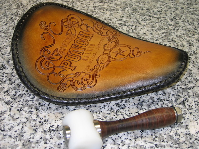

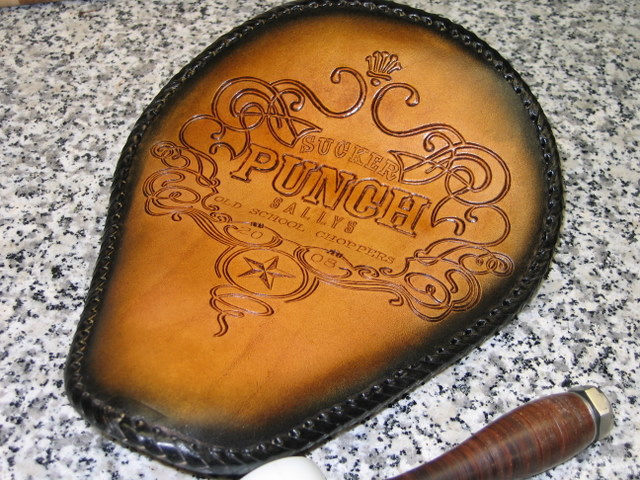

David Posted April 7, 2008 Author Report Posted April 7, 2008 Here is the final version of this one....black to tan fade as requested. David Theobald http://theobaldleather.com Quote
outcast Posted April 7, 2008 Report Posted April 7, 2008 Nice work as always, David. The color fade looks good. Quote
Members Sawyer Posted April 7, 2008 Members Report Posted April 7, 2008 Looks great David! i love the scolls. Quote
David Posted April 9, 2008 Author Report Posted April 9, 2008 Thanks guys, Always happy to hear that someone likes the work. Please keep Donny Loos in your thoughts and prayers....he need all the support from the man above that he can get. David Theobald Quote
Ambassador freak Posted April 9, 2008 Ambassador Report Posted April 9, 2008 I've got alot of catch up to do on the forums so please forgive me for not reading all the replies if i'm repeating something. Dave to me this is some of the best work i've seen. Your tooling and lace work is always super clean but man i gotta tell ya that design is the BOSS brotha !! It looks great the way you dyed it. I'm so glad you posted a few pics before the dye, cus in it's all nat cew rail kolor is my fav. True classic !! Now tell me this , that's not you norm mexican basket weave like you've done on the others, rite ?? Great work !! Quote
David Posted April 9, 2008 Author Report Posted April 9, 2008 Hey Freak, That is not the regular basketweave/round braid....Shirleyz did it on her Marine tribute seat. It is exactly like the basket weave except you don't weave UNDER any strands, just forward 3 holes then back 2 holes....very easy and fast. It looks like the basket weave because it covers the edges completely but is much faster to do. I comes out looking like a herringbone pattern. Thanks again to Shirley! David Theobald http://theobaldleather Quote
