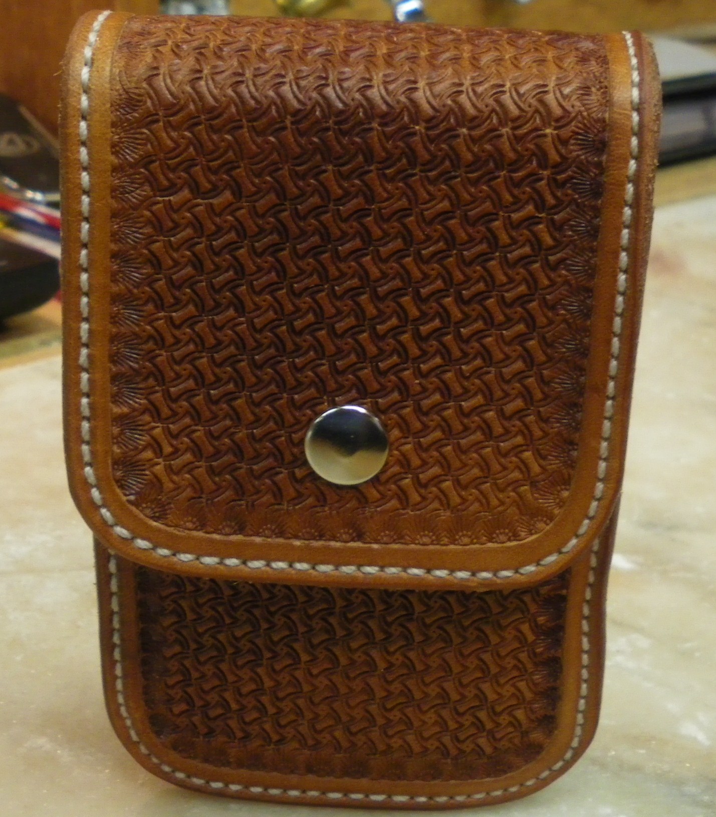

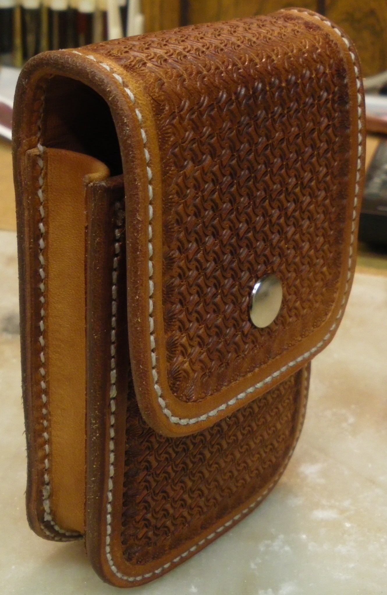

MarkB Posted December 2, 2009 Report Posted December 2, 2009 Here is a cell phone case I just finished. It is for a blackberry type phone. I used HO leather 6-7 oz.for the main body with 3-4 oz for the gussets. I also lined it with some 2-3 oz leather. sewing in the gusset was a little tough but it worked out OK. Let me know if you see anything that I can work on to make it a better case. Mark Quote
Members Storm Posted December 2, 2009 Members Report Posted December 2, 2009 Mark, All in all a very nice piece of work. There were be only one thing to try and work on and that is burnishing the edges. Check out Bob Park's tutorial. He is a very accomplished and well rounded leather craftsman and it is a good bit of info. http://leatherworker.net/forum/index.php?showtopic=18101 Great piece though!!! Storm Quote

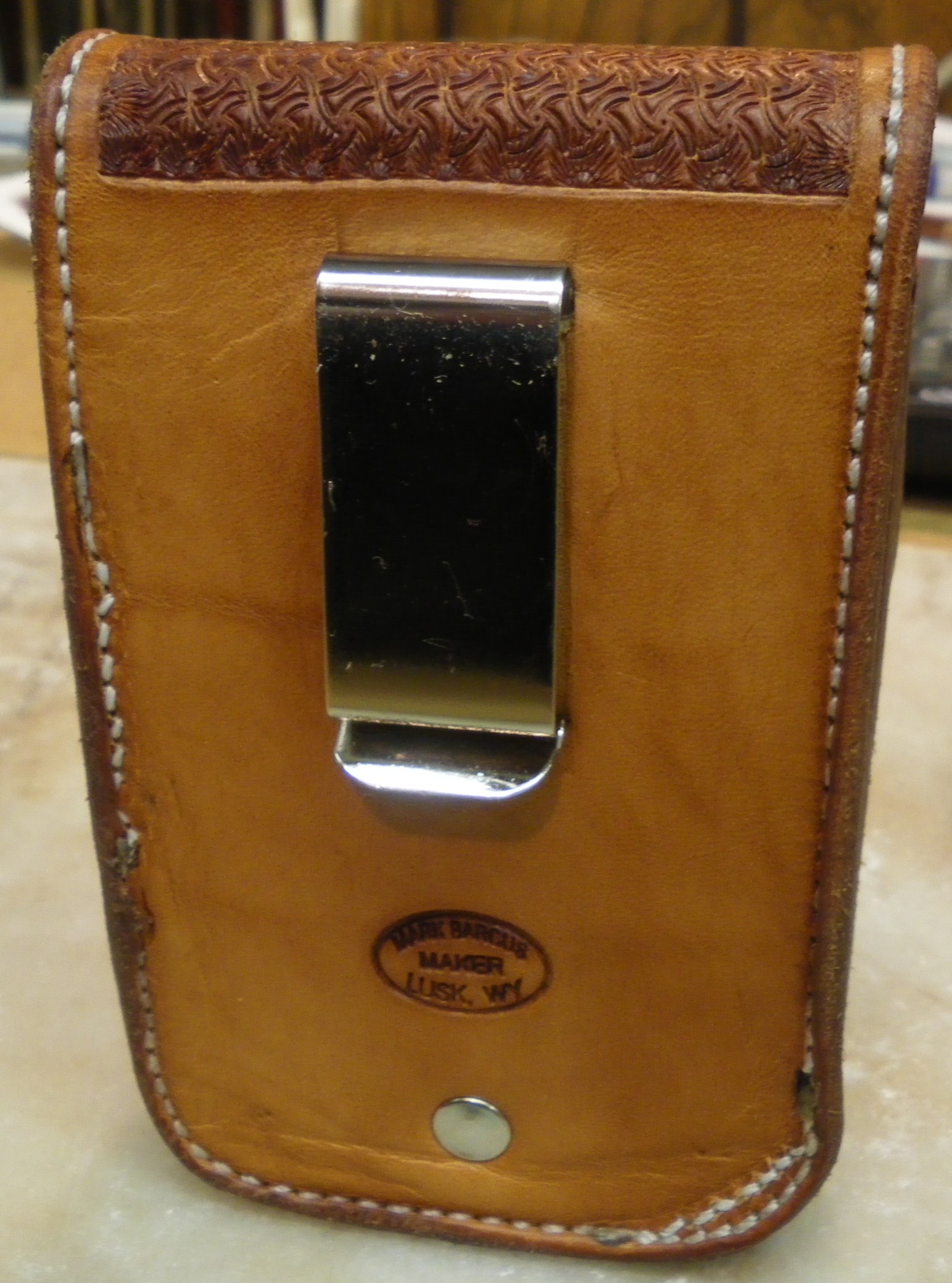

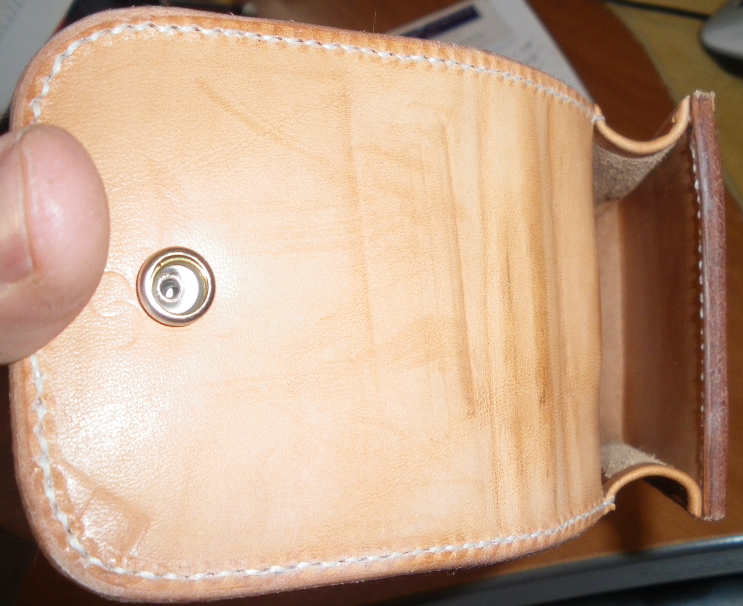

MarkB Posted December 3, 2009 Author Report Posted December 3, 2009 Thanks everyone for the comments. I will work on the edges more. As you can see from the back pictures the sewing needs help. I really like the advice from Bobby on sewing. I thought of that after I had made that mistake. But that is how I learn the hard way LOL. Here is two more pictures one of the back (with the bad sewing job) and one of the inside. Tim I did use a machine to sew it together. Thanks again for all the help. Mark Quote
Members jdwintx Posted January 4, 2010 Members Report Posted January 4, 2010 Nice case. Just be careful with that snap though. I just did a case for myself and within a few days that snap had cracked the LCD crystal on the phone, didn't break the glass but rather the crystal below the glass. Cost me $100 to replace the phone and you definitely don't want your customers coming back at you for that. I'm reworking my case now to either eliminate the snap on the front or make the snap on the back. Quote
