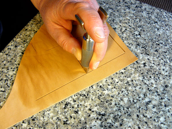

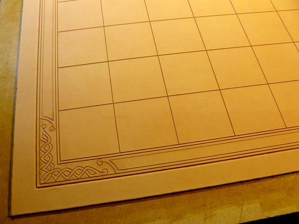

Those of you who have been to my web site have seen this design before. It incorporates one of the CraftAid corners, along with some other ornamentation of my own I filled into the border, and has been a popular pattern. This particular one measures 24" x 24" - the squares are 2.5".
So far, just all the lines are cut, and I've finished the tooling in one corner, now I'm starting to work my way around the border with backgrounding and beveling. The borders get filled in with some very tiny basket stamping. More later...

Beautiful work as usual. Curious- what weight and what brand of leather do you use on a project like this? Because of the nature of a game board- the initial piece of leather better be pretty flawless to say the least.
Also- do you cut the squares with a swivel and ruler, ruler and utility or scalpel, ....?

One of the things I've always admired about Kate's work is that she can jazz it up without losing the elegance of the original design. That will be a board you can display hand-carved, ridiculously expensive chess pieces on and dare the cat to walk on it. Johanna

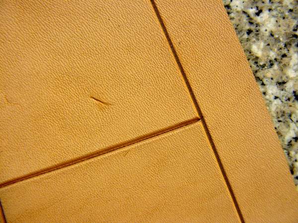

I use Wickett & Craig tooling sides in a 6oz. weight (2-3mm). For game boards, I have to be able to cut very large pieces out of the side that are clean enough. In other words, you can't cut around major flaws anywhere in the middle of the hide. I can work with minor flaws, like "fat" wrinkles and light scars - they add "character". I actually kind of like them. But the W&C hides I've gotten have all come pretty clean. I can usually cut 3 game boards out of one side.
I use a swivel knife with a straight half-inch hollow-cut blade to make the layout lines. I cut the shorter lines freehand, but it goes much faster when I use a straightedge to guide the blade on the really long lines. Then I model the edges of the lines to give them a slight bevel and straighten out the places where the lines intersect.
