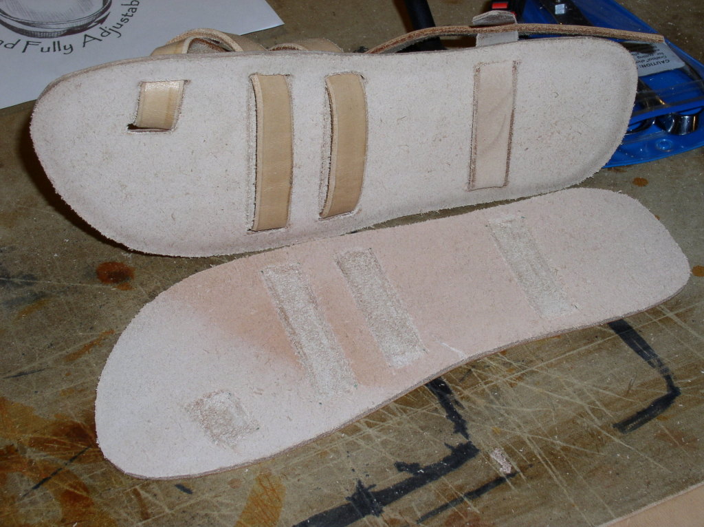

Contributing Member Jordan Posted April 12, 2008 Author Contributing Member Report Posted April 12, 2008 (edited) 2 steps forward 1 step back, 37" of 3/4 strap is to short by about 5", back to tandy for a couple of longer ones. So far they are coming together nicely and is turning into a real learning/problem solving project. I also find that my strap channels need to be deeper so the foot pad is not so bumpy, I have very tender tootsies I guess LOL Edited April 12, 2008 by Jordan Quote

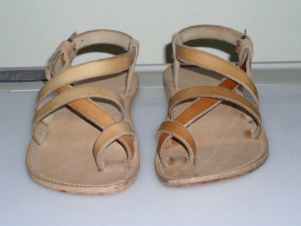

Contributing Member Jordan Posted April 15, 2008 Author Contributing Member Report Posted April 15, 2008 One down one to go, really fits nice, a little olive oil to soften them up and I may not get any blisters, makes you feet smell like a Greek Salad! Quote
Members Myriam Posted April 15, 2008 Members Report Posted April 15, 2008 I've been following your progress on these. Nice work! Had always wondered how they were made. Now I know! Quote Myriam Myriam's Leather Work Dakota Braiding and Leatherwork
Kevin King Posted April 15, 2008 Report Posted April 15, 2008 That is just down right COOL! A sandal with a built in watch! I want a pair! All kidding aside. Looks like a very professional job, I am very impressed. KK Quote The second kick from a jackass is of no educational value. Official Freak Fan Club President FACEBOOK kevinkingleather.com
Contributing Member Jordan Posted April 16, 2008 Author Contributing Member Report Posted April 16, 2008 Finished sewing, still need some edge treatment and olive oil/sunlight to darken. I think they may be a good seller this summer. Quote
Members Myriam Posted April 16, 2008 Members Report Posted April 16, 2008 I agree indeed. They look real cool and from what I see on the straps, I think the olive oil is going to give them a really nice color. Good work, Jordan! Quote Myriam Myriam's Leather Work Dakota Braiding and Leatherwork
Timbo Posted April 20, 2008 Report Posted April 20, 2008 What did you use to cut the strap channels??? Tim Quote
Contributing Member Jordan Posted April 24, 2008 Author Contributing Member Report Posted April 24, 2008 I used one of those hand V gouges to get the line straight on each channel then carved out the recess with a french edger. Quote
