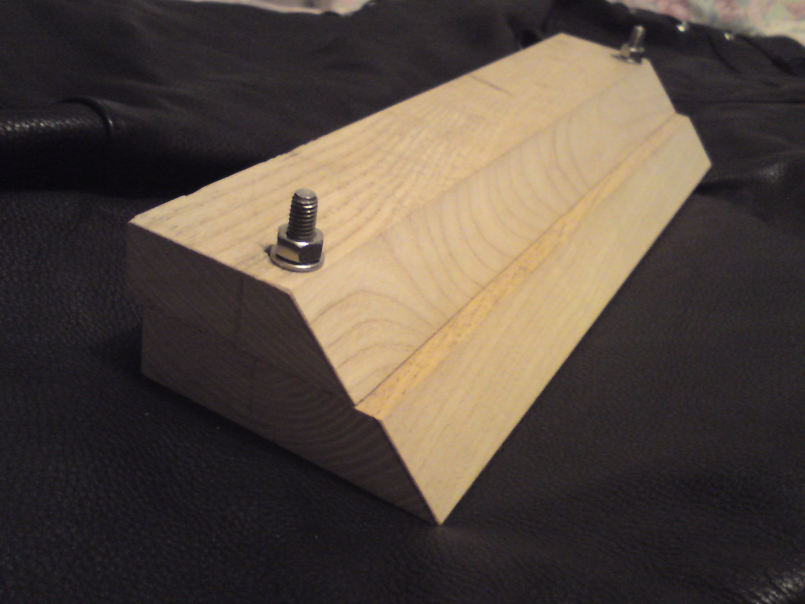

Members OdinUK Posted March 18, 2010 Members Report Posted March 18, 2010 Im having the same problem/learning curve. I did a sketch based on some advice I got on the post about Frech skives. I showed it to my boss and he made me this simple jig for holding the leather while its cut at 45 degrees. Useful for making boxes. The top piece has slotted holes so can be adjusted for different thicknesses of leather. Quote
