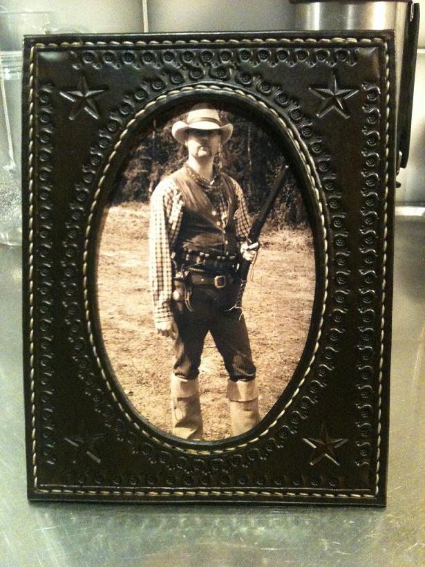

Members Boothill Bob Posted September 28, 2010 Members Report Posted September 28, 2010 Howdy all.. Here I´ve maked my first photo frame, it was a test piece but I´ve got a lot of feedback. Its open in the top so you can change photos and there is no glass on it, I dont know if glass is needed.. //Henrik Quote
Members gearhead Posted September 28, 2010 Members Report Posted September 28, 2010 I think that if you put glass in you will be able to see the outline of the glass thru the leather. Quote
Members Boothill Bob Posted September 28, 2010 Author Members Report Posted September 28, 2010 I think that if you put glass in you will be able to see the outline of the glass thru the leather. I think so to, thats why I dident do it, maby some thin clear plastic should work?? Quote
King's X Posted September 28, 2010 Report Posted September 28, 2010 Very nice work! It appears to be an old old-fashion concept with new world techniques. Be proud! Quote
Ambassador abn Posted September 28, 2010 Ambassador Report Posted September 28, 2010 Looks great to me! Quote
Members joquarter Posted September 29, 2010 Members Report Posted September 29, 2010 Nice job . Quote
Contributing Member Bob Blea Posted September 29, 2010 Contributing Member Report Posted September 29, 2010 Looks nice to me. You could add a thin sheet of acrylic plastic to protect the photo but it looks good without it. Quote
EricDobson Posted September 29, 2010 Report Posted September 29, 2010 Great looking work! My main concern for the glass would be if you're going to put original photos that might be irreplaceable, or if you're going to put reproductions and could always print out another one... for original photos, I'd definitely want some protection. Quote
Contributing Member Ferg Posted September 29, 2010 Contributing Member Report Posted September 29, 2010 Howdy all.. Here I´ve maked my first photo frame, it was a test piece but I´ve got a lot of feedback. Its open in the top so you can change photos and there is no glass on it, I dont know if glass is needed.. //Henrik I am concerned about the longevity of the photos being against the leather. I think the natural oils from the leather may destroy the photo paper. My suggestion: Place the photo in a clear plastic envelope or laminate the photo. ferg Quote
Members Boothill Bob Posted September 29, 2010 Author Members Report Posted September 29, 2010 (edited) Thanx Eric and 50.. If I´m going to sell them than I can send a plastic cover with the frame to protect the photo.. Dident think of the oil in the leather :brainbleach: Edited September 29, 2010 by Boothill Bob Quote
Members joquarter Posted September 29, 2010 Members Report Posted September 29, 2010 Laminate the photo works great , you can print your photo on 180 g paper , laminate it and it looks like you used very expensive photopaper and cartridges, the color don't fade away by the sun, and no trouble with dust , water ore broken glas. Quote
Members whinewine Posted September 30, 2010 Members Report Posted September 30, 2010 My main concern for the glass would be if you're going to put original photos that might be irreplaceable... for original photos, I'd definitely want some protection. IF you would want to use glass, NEVER EVER put a photo next to glass without the use of a mat between. The photo emulsion will eventually draw moisture, possibly mold, & will stick to the glass so it can't be removed. Quote
EricDobson Posted September 30, 2010 Report Posted September 30, 2010 IF you would want to use glass, NEVER EVER put a photo next to glass without the use of a mat between. The photo emulsion will eventually draw moisture, possibly mold, & will stick to the glass so it can't be removed. These are the things I never learned growing up in the digital age... I haven't dealt with real photos in years. I'm guessing most people do this wrong, because i don't ever remember any mats in picture frames growing up. Quote
