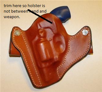

Members Dwight Posted October 2, 2010 Members Report Posted October 2, 2010 (edited) I have had a couple of returns lately on IWB holsters sold online because the customer said they could not get the gun out of the holster. After getting them back and trying them myself, I can't find a problem. Are there any special design elements that you use to make them more "big people friendly"? I know that the belt involved, as well as the tightness of the belt could be a factor. Has anyone else ever ran into this? Any input appreciated. Just a little frustrated. Thanks, Sam Sam, . . . can you post a picture of each? I make almost exclusively IWB, . . . have never had one come back for that reason, . . . perhaps we can see something collectively here that would make a difference. And, . . . yes, . . . I have a couple of, . . . uhh, . . . umm, . . . larger customers. They all like my holsters, and while the mouth is reinforced, I have never found a need for the steel addition. Anyway, . . . looking forward to seeing pics. May God bless, Dwight Edited October 2, 2010 by Dwight Quote If you can breathe, . . . thank God. If you can read, . . . thank a teacher. If you are reading this in English, . . . thank a veteran. www.dwightsgunleather.com

Members vahillbilly Posted October 2, 2010 Author Members Report Posted October 2, 2010 Here are some pics of the holster in. Color is off in the first picture. This holster has basically zero cant, which could be part of the problem. It is for a j-frame revolver, with the cylinder behind the belt, not above or below. Quote
Members vahillbilly Posted October 2, 2010 Author Members Report Posted October 2, 2010 Here are a couple of pics of the other holster. Thanks, Sam Quote
